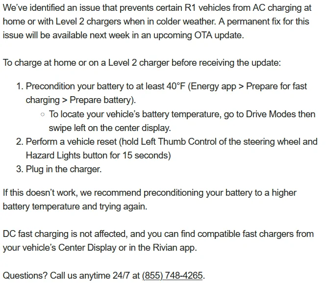

It appears Rivian is sending emails to Gen 2 owners experiencing this problem. This was posted on Reddit.
Rivian R1T R1S Level 2 charging issues since last update IMG_0406

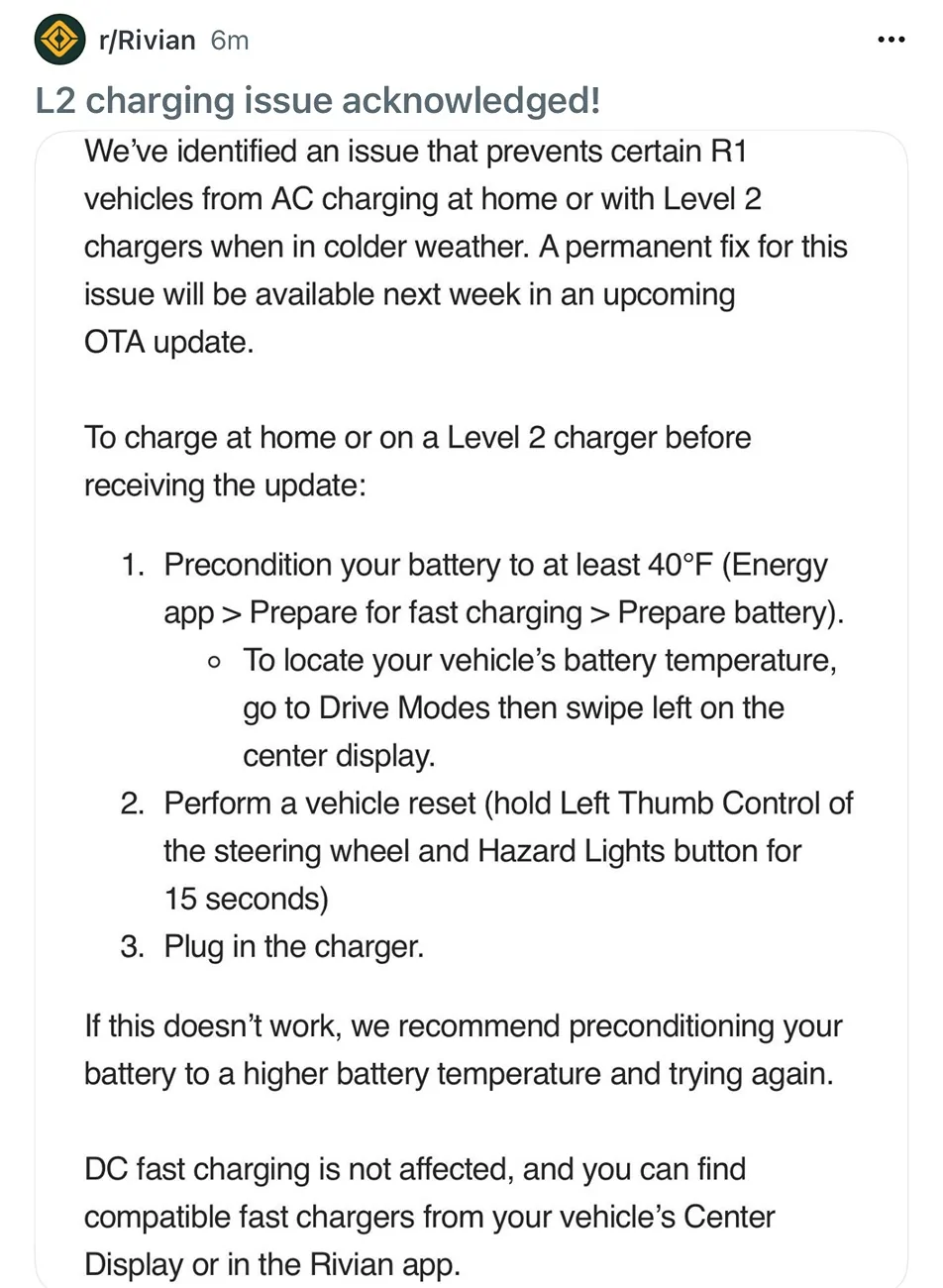

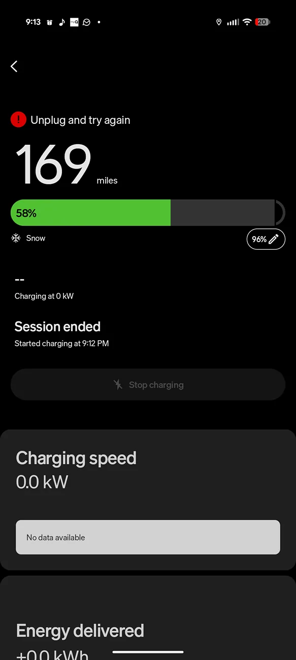

Is anyone else having Level 2 charging issues after the last update? I have had several failures to initiate charging. The error seems to be on the Vehicle side, not the charger side. Granted, it has been very cold here, but I have charged before in this weather with no issues.
Just received an email and text from Rivian - "Issue prevents certain R1 vehicles from AC charging at home or with Level 2 chargers when in colder weather. Expect OTA update in a week to fix but in the mean time
"To charge at home or on a Level 2 charger before receiving the update:
  1. Precondition your battery to at least 40°F (Energy app > Prepare for fast charging > Prepare battery).
    • To locate your vehicle’s battery temperature, go to Drive Modes then swipe left on the center display.
  2. Perform a vehicle reset (hold Left Thumb Control of the steering wheel and Hazard Lights button for 15 seconds)
  3. Plug in the charger.
If this doesn’t work, we recommend preconditioning your battery to a higher battery temperature and trying again.
DC fast charging is not affected, and you can find compatible fast chargers from your vehicle’s Center Display or in the Rivian app."
I did have issues charging at a remote Colorado Mtn resort using Tesla Universal charger with a cold battery (about 35F) last week. Also I had issues with the Rivian Adv network in Montrose - all 6 errored out.

They texted me too. Battery at 28 F and it fails to charge.
Rivian R1T R1S Level 2 charging issues since last update 1000009779
