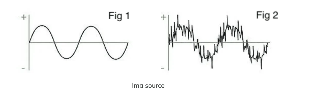

Based on your initial description "some of my light bulbs in the house flicker while the truck is charging. What is strange is it is only some of the LED lightbulbs." it's probably not a bad connection, wiring problem, etc. I repeat - based on your initial description.
My gut feeling is that this is Harmonic Distortion caused by the EVSE and the inverter in the vehicle. Not that the EVSE does not 'change' the electricity - the EVSE is essentially a smart switch, nothing more. It's highly unlikely that replacing the EVSE would have any impact.
The inverter in the vehicle converts the AC voltage to DC battery charging voltage using specialized power transistors. This process causes noise on the power line known as harmonic distortion. This can affect other electronic devices. LED bulbs ALSO have an electronic circuit that reduces the voltage from 120 AC to a lower voltage. To varying degrees, these circuits rely on a clean power line to work properly. Cheap or older design bulbs are notorious for not working with dimmers because they cannot adjust/compensate/tolerate a modified voltage waveform. This is why some bulbs do it, some don't. Figure 1 is a clean/optimal AC waveform. Figure 2 is what the AC waveform looks like with harmonic distortion. In very simple terms, the LED bulb circuit is designed to turn on and off at certain voltage values dependent on the waveform. That's easy in Figure 1. In Figure 2, the LED buld circuit may turn on and off multiple times due to the spikes in the waveform, causing what we see as flickering.
A good test would be to charge a DIFFERENT non-Rivian vehicle and see if the problem changes.
Read this article for more information.
Since my original post I did end up swapping out the offending LED bulbs and have chalked it up to cheap LED bulbs being the problem as I have not noticed this behavior since I changed the bulbs out.
The inverter in the vehicle converts the AC voltage to DC battery charging voltage using specialized power transistors. This process causes noise on the power line known as harmonic distortion. This can affect other electronic devices. LED bulbs ALSO have an electronic circuit that reduces the voltage from 120 AC to a lower voltage. To varying degrees, these circuits rely on a clean power line to work properly. Cheap or older design bulbs are notorious for not working with dimmers because they cannot adjust/compensate/tolerate a modified voltage waveform. Modern dimmers modify the waveform, they do NOT reduce the voltage. This is why some bulbs do it, some don't. Figure 1 is a clean/optimal AC waveform. Figure 2 is what the AC waveform looks like with harmonic distortion. In very simple terms, the LED bulb circuit is designed to turn on and off at certain voltage values dependent on the waveform. That's easy in Figure 1. In Figure 2, the LED buld circuit may turn on and off multiple times due to the spikes in the waveform, causing what we see as flickering.
