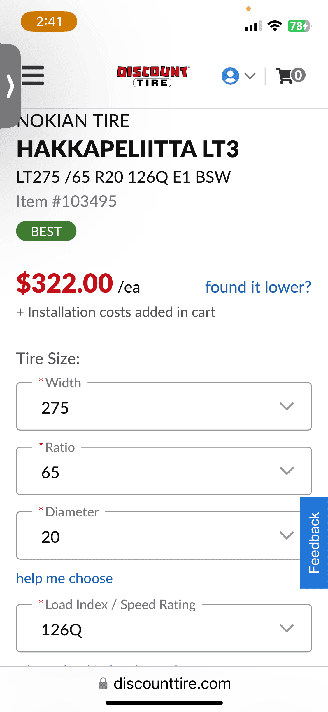

Any reason this didn’t make the list?
Their website doesn't show it as compatible. I'm not sure why, since it's in the OE size and exceeds the OE load index. You may want to check with them. If they fix it on their end, I can then regenerate the sheet. It does show as unavailable/out of stock for me though.
Interesting, even Nokian lists it here: https://www.nokiantires.com/rivian/
