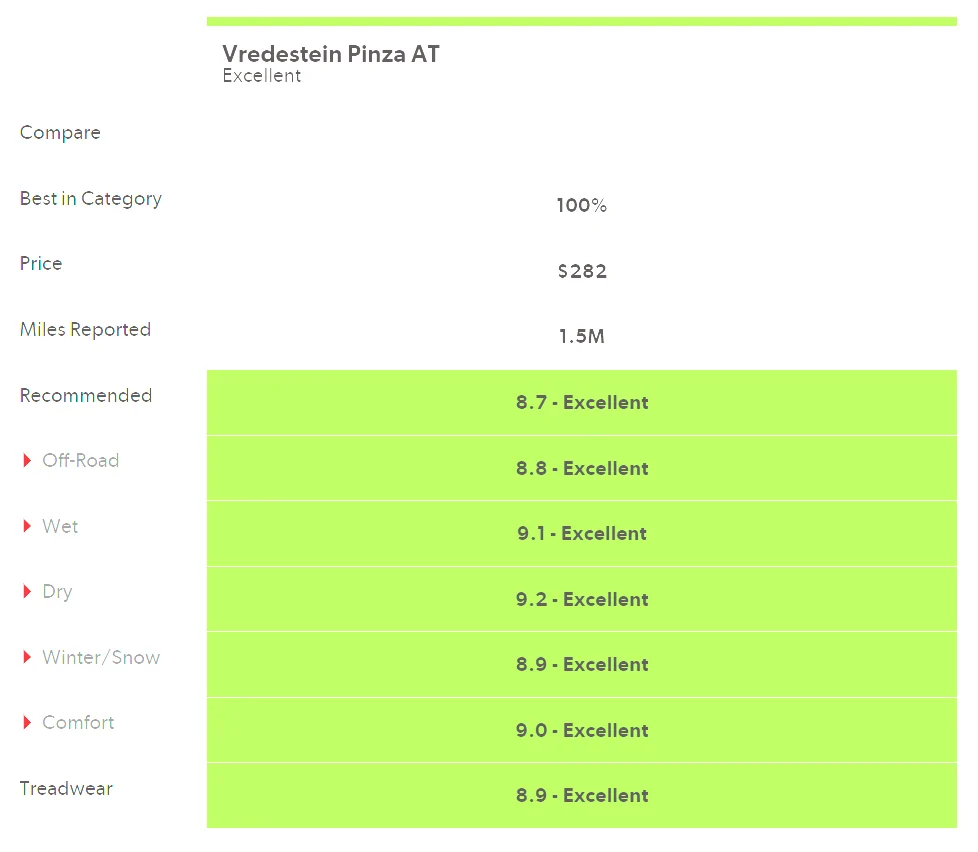

Has anybody considered this tire? Not sure why it's not listed on the chart.
Vredestein Pinza AT 275/60 R20 - 115H - 3 Peak -

These are highly rated on Tire Rack ...............

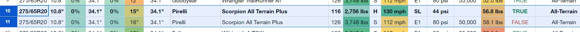

Sorry, question about the list. Why these 2 have the same names, same diameter, etc etc, but the rating are so different between the two. Which one is Rivian offering? I just need a better load index and speed rating all season tires than OEM, then i know it's safe to swap
Because Pirelli offers two products in that family and size:

Sorry, i can't find the info else where.
These Pirelli looks the same, why they have different rating?? Why Rivian gives a shittier rating version??
Is the bold one the one that Rivian uses? Newbie in tires, it looks the same
