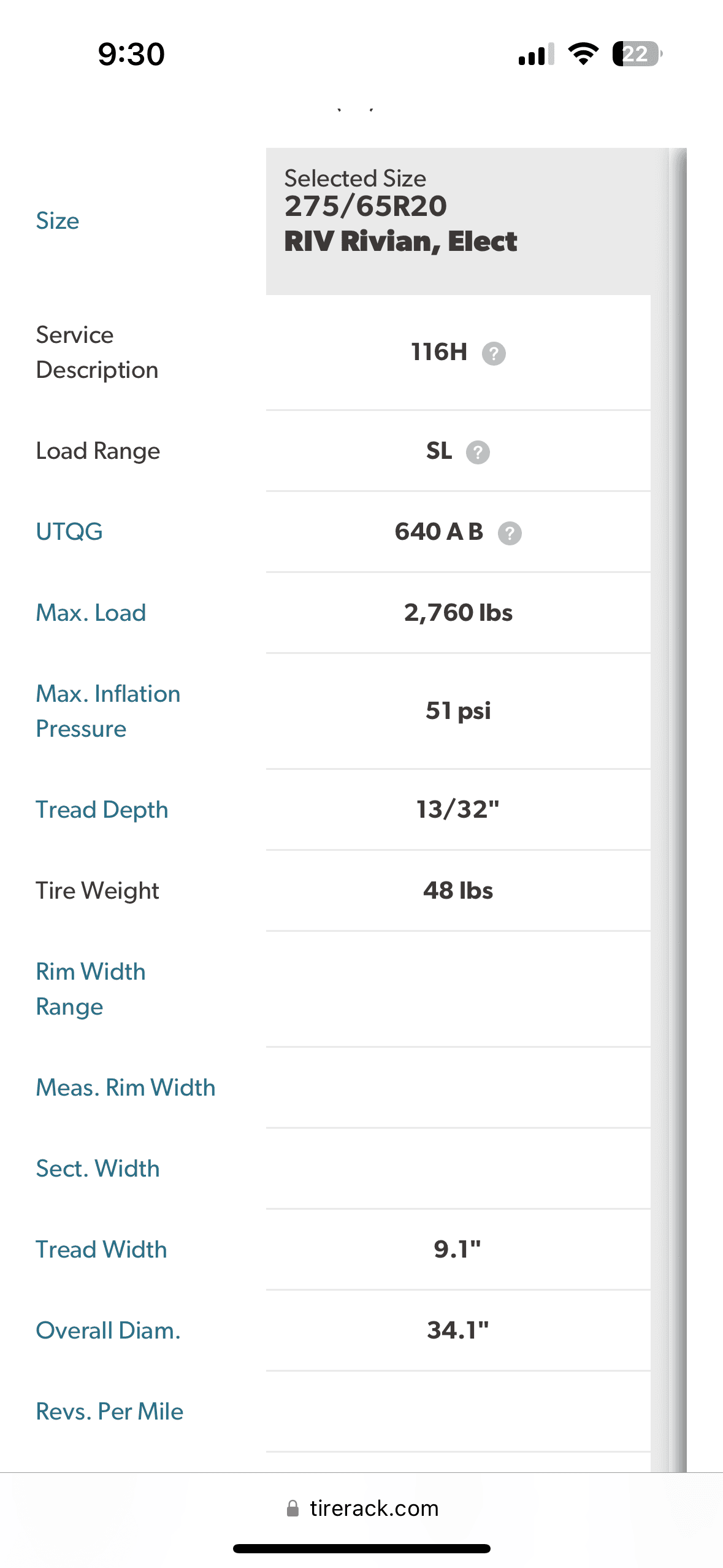

First off, thank you for putting this extensive list together. I’m curious where you got the specs for 20” stock Pirelii’s. Pirelli doesn’t have any specs listed on their website. Tire rack has the specs listed in the screenshot below. The weight and max PSI differ quite a bit from what’s on your chart, so am trying to figure out which is more accurate.
Reason I ask - I’m trying to find another AT tire that is similar in weight/max PSI.
All the data is from Discount Tire, and can also be seen on their website.

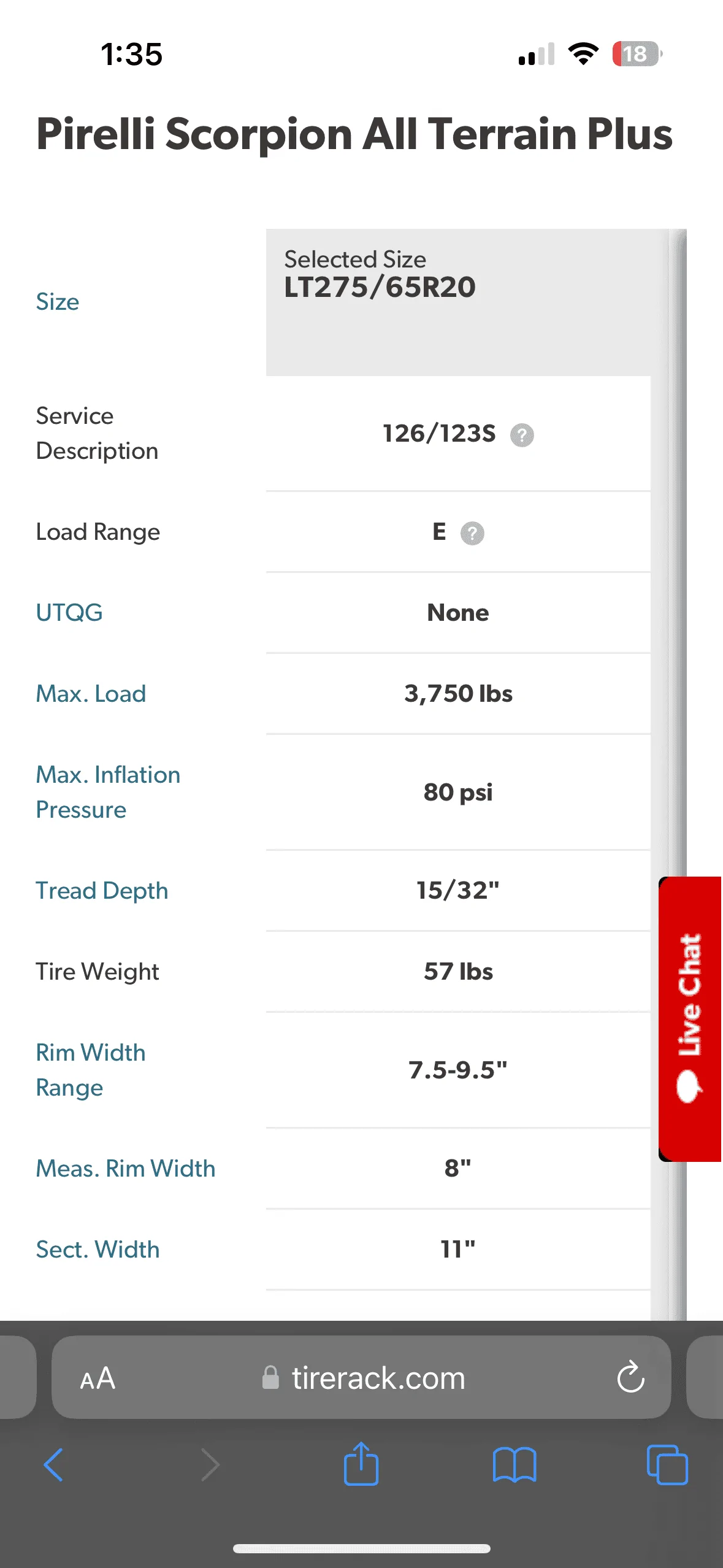

Ok I see. Based on my research I think Discount Tire may have the specs off for these 116H tires. The E rated ones (also in 265/65/20) on Tire Rack are showing 57lbs.
Seems like Rivian would have opted for a lighter tire to help with range and 57lbs is in line with a lot of E rates tires from
other brands.
other brands.
I agree with you in that the numbers do seem off, particularly the max air pressure of 44 PSI—isn't the recommended tire pressure 48 PSI?
To keep things simple, however, I'll keep this in sync with what Discount Tire says.
