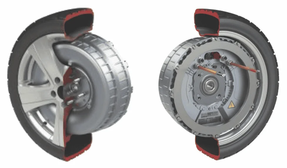

I think the CV half-shaft assembly needs to be eliminated all-together. It's a point of inefficiency and a point of failure that could be eliminated by a motor-hub-assembly. If Lucid can make a motor assembly that can fit in a piece of standard luggage -- eventually we will be able to get sufficient power/longevity out of a pancake design as well.
Rivian R1T R1S Low speed 'Tocking' when stopping or starting 1666036295664
(Note: The only unsprung weight in this type of assembly would be the wheel/tire/brake disk/rotor shaft/windings or magnet (which ever is moving))

A lot of practical issues to solve for those as well due to the impacts/vibrations they would have to cope with:
https://evcentral.com.au/why-dont-evs-have-four-in-wheel-motors/
If we can make a wheel bearing last 160,000 miles though; I'm confident we can make an electric motor subjected to that stress do the same.

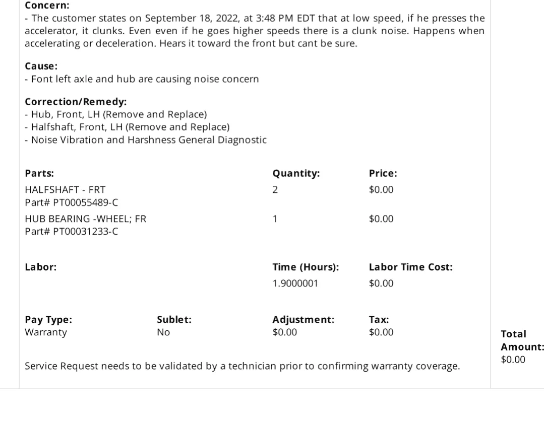

Well it wasn't fixed. I'm not sure what the point of replacing the halfshaft and hub bearings was because it sounds the same. I assume they noticed something was wrong with them but seems strange. I spoke with the tech and he said all the trucks make the sound and it's considered normal. It really doesn't bother me but the whole situation is strange to me. Like is it a problem or is it not?
The additional unsprung mass is not insiginificant. Lordstown adds about 70 lbs of unsprung weight per wheel with their hub motor design - that's roughly doubling the unsprung weight. That requires stronger suspension components and will have a negative impact on ride.
That is very true, it’s essentially doubling the weight.
Perhaps with the use of some special materials and maybe even integrating the rotor into the wheel itself (i.e. the barrel of the wheel IS the rotor.) That weight can come down.
You can’t reduce the mass of the rotor, but you CAN reduce the mass of everything else around it.

Last week I had an appointment for lubricating that squeaking noise all trucks are doing, they fixed it. I brought up this tocking/clunking/knocking noise to their attention. Even one tech was out and took a ride with me and was able to confirm the sound.
After service, they told me it is LH CV-shaft related (of course I knew it) and told me to watch if it will be getting worse.
