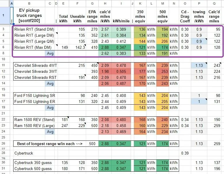

Thanks for the comparison numbers.
I've been trying to put together a spreadsheet to see how all the trucks compare.
Are there other spreadsheets/tables out there?
I think usable on Rivian large pick is 128.

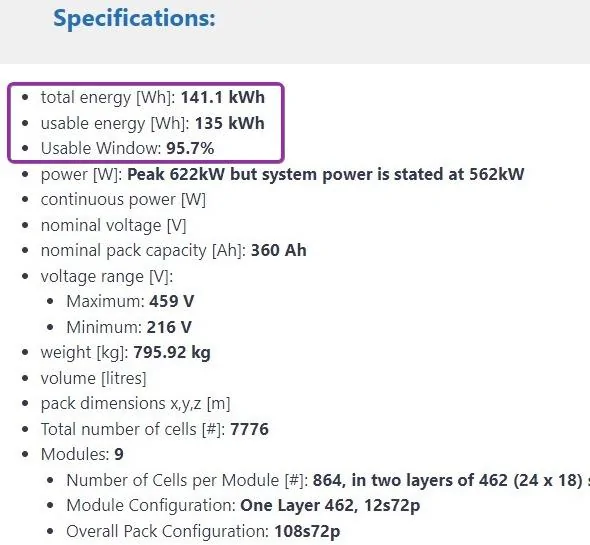

They did a software update earlier this year IIRC which opened up more usable capacity. So some of the older numbers which quoted less usable were probably correct at that time.
I'll probably go with what is on this page: https://www.batterydesign.net/rivian-r1t/
The car and driver article number also close matches the usagble % on that webpage
(ie. 95.7% vs 95.5% = 142.3/149.0)
Rivian R1T R1S Max Pack Battery Capacity Confirmed - 149kWh cETfHdn

Thanks for that. I updated my table to reflect it.

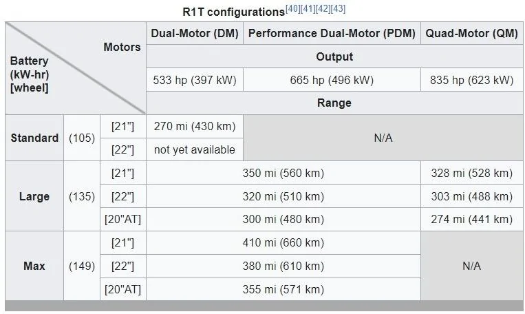

Nice job on that post. I realized that I needed to avoid tire size variations and just use the 21"s (aka most efficient) when I saw the Wiki page table (below). I recall for the Model X that Tesla used to have a footnote on the config page that the 22" would loose 10% range vs the 20".
Wiki page:

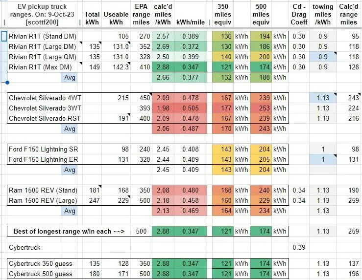

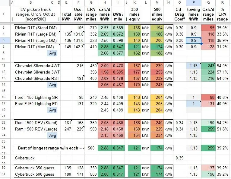

Also, out of curiosity, why do you rate the towing miles/kwh better for the other trucks? Is it because they have large cross section and thus the trailer has less impact?
Good observation and question. It is a calculation:
[(towing miles per kWh) / (calc'd miles per kWh)] * (EPA range miles)
and I only had a "(towing miles per kWh)" for one example (blue shade) which was a 7420 lbs dual axle trailer. I added column R showing that resulting % of the EPA range. ie. 328 mi*35.9%=118 mi.
? Do you have any other 'towing miles/kWh' value sources. I think I used a YT from Edmunds Cars where the Rivian got 0.9 and the Ford got 1.0. (The Ford got 1.5 in a diff test with a flat trailer).
Rivian R1T R1S Max Pack Battery Capacity Confirmed - 149kWh 1r64YHC
Also also, as others have said, it seems likely the DM Max still has about the same efficiency as the other DM. So, maybe make that a little closer and thus it has a larger usable size than 142. It's likely the DM Standard pack is going to exceed their estimations as that's what Rivian likes to do.
Obviously, things get a little fuzzy if you are doing Calcs like I am for the 'miles/kWh' and you change the 'usable kWh'. I used the kWh numbers from that Car and Driver article and did the calc.
