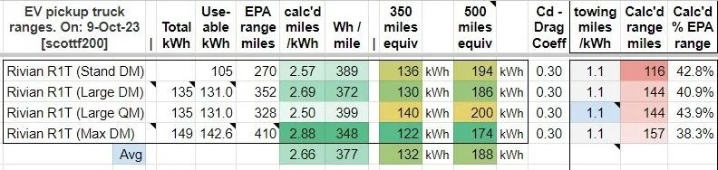

Looks like they updated ElectraFi my Max Pack account works now. The Wh/Miles figure doesn't seem accurate at this point.
Update:
The Wh/Miles calculation appears to based on 180 kWh. This is from a 0-95% charge:
The kWh reported by our EVSE correlates with the kWh reported by the Rivian, so I don't think that's it. It was a 0-95% charge so more likely 172.6/.95=181.6

It's 149 kWh gross capacity. Usable is likely around 140 kWh-143 kWh.
RE: 172.6 = "kWh reported by our EVSE"
So your the AC-->DC conversion is using 37.7 kWh then ?
37.7 = 172.6-134.9 .... [142*95%]
21.8% efficiency loss? 1-(134.9/172.6)

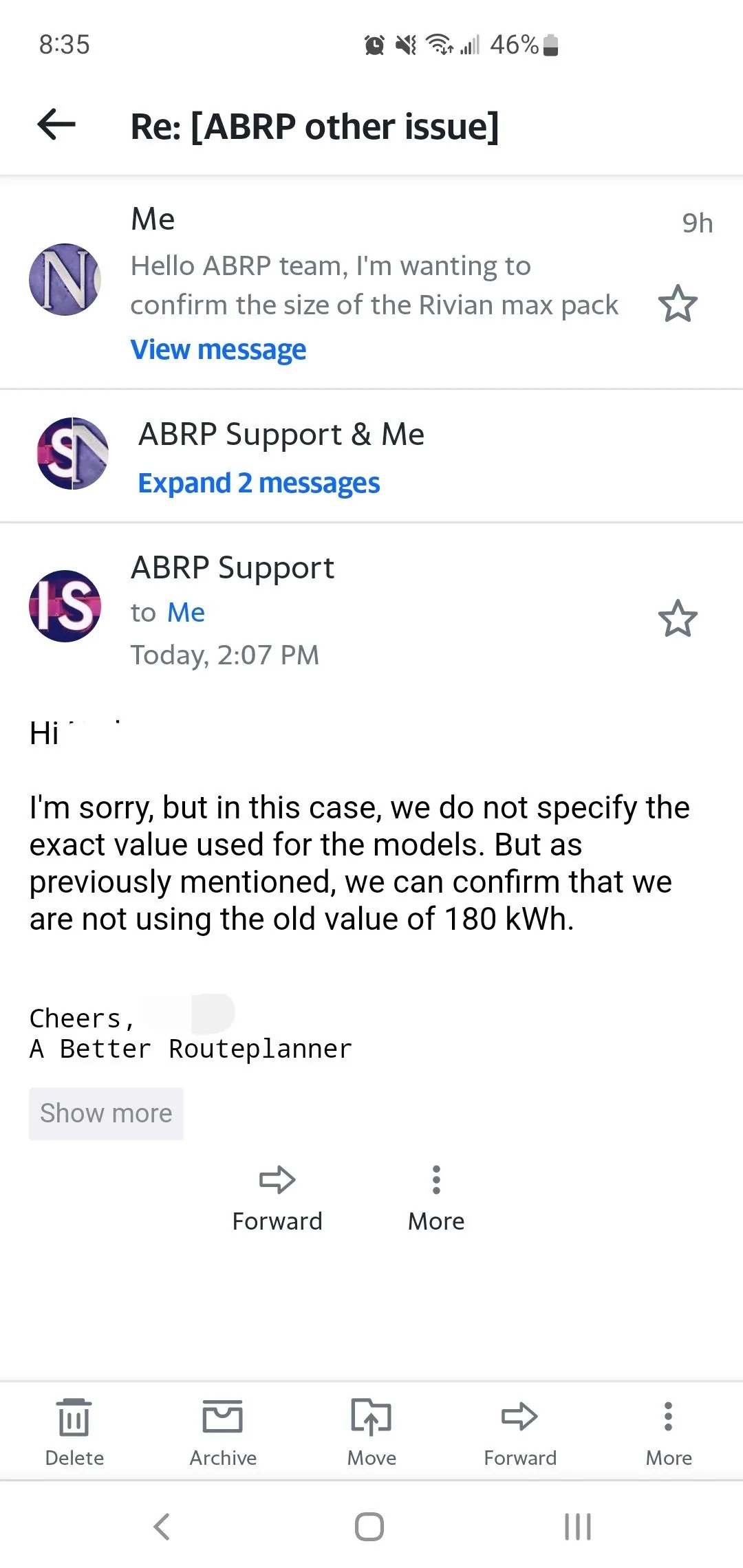

Not sure if it was in this thread or another, but ABRP confirmed that they're no longer using the old 180 kWh value for their max pack route calculations. They wouldn't however confirm the value they currently use...
This is pretty much confirming ABRP knows the Max Pack capacity and are using that for their calculations. If this is true, the Max Pack usable capacity is around 141 kWh. Which correlates with my experience with a deep charge of my Max Pack.
I entered a route from Nashville to Memphis (189 miles) in ABRP, set the max speed to 65 mph, and removed traffic and weather factors from the settings.
ABRP specifies 2.68 mi/kWh as the 65 mph efficiency of the R1T Max Pack.
The 189 mile trip from Nashville to Memphis depletes the battery by 50%.
189miles/.5=378 miles
378 miles/2.68 miles/kWh=141 kWh
