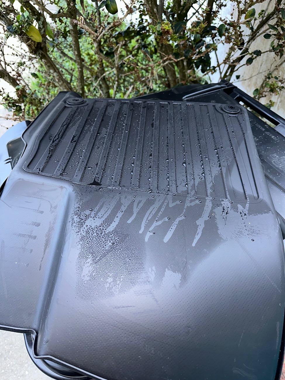

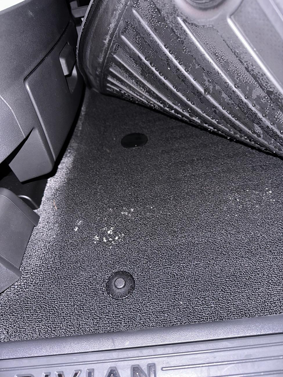

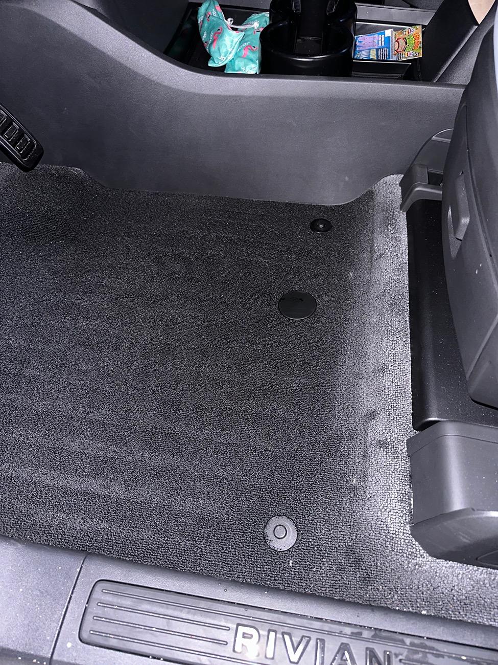

Well, unfortunately when I was changing out my all weather mats, I immediately noticed that the bottom of them were covered in water. Upon further investigation, the driver and passenger carpet is also covered in a white mold (some in the center but most is up along the edge right before going under the seat). I stopped dealing with the mats to figure out what I need to do to get this resolved.

oh boy, they still having this issue? in most cases its due to rain water getting into the cabin typically somewhere through the roof of the vehicles. did it rain recently or maybe you went through the car wash?
you should open a service ticket immediately.

Sadly, my G1 R1S is in the Service Center right now for the same issue. I thought it was resolved with the G2, but I guess not. Basically the HVAC unit is filling with condensation and it's spilling onto the carpeting. A couple of thoughts for you:
  • Make a service appointment as soon as possible - lead times can be tough!
  • Use a ShopVac or handheld carpet cleaner to suck up as much water as possible
  • Use old towels to blot up even more moisture
  • Hopefully you're in a garage - Leave all windows open and put some fans blowing on the carpeting to dry it out
  • Here's the REALLY sucky part for you: Don't use the A/C until it's fixed. We got lucky in PA with a cold snap so we were able to live without A/C (at least I did). My wife knew that I'd clean it up if the carpet got soaked again so she wasn't shy about using the A/C. I don't know what the threshold is for how long you can use the A/C before it leaks. She was okay with 15-minute sessions - no more water on the carpet (I checked after each time she took the Rivian out)
  • Also - Check the passenger side...In ours both sides in the front were soaked. I caught it pretty quickly because I never put our all-weather mats in and we still use the Chilewich mats and the water leaked through.
Good luck - we have a slight moldy smell in the car (with similar white water marks on the carpeting), but it's not awful. I asked the service rep when I dropped if off if they'd be replacing the carpeting and she said it depends...Sometimes they have to and others they send it to a detailer and they shampoo the carpeting and are successful. I also asked them to replace our Chilewich mats up front because they smell moldy. We'll see if that happens...

My truck was in for this, rivian replaced the HVAC box (said it was cracked) and the carpeting in front. No issues in my truck since. I have an early vin gen 1 R1T.
Service center told me in some trucks it was a stopped up and/or improperly installed HVAC drain line causing this too.

Rivian needs to get this in ASAP to clean up the water. I was told by Rivian they have a redesigned HVAC assembly so I'm surprised to see this happening on a Gen2. I was told the HVAC assemblies had a problem with cracking and this caused water to leak out until the floor instead of out and away from the vehicle as designed.
Rivian wound up replacing my wife's R1S over this issue earlier this year.
