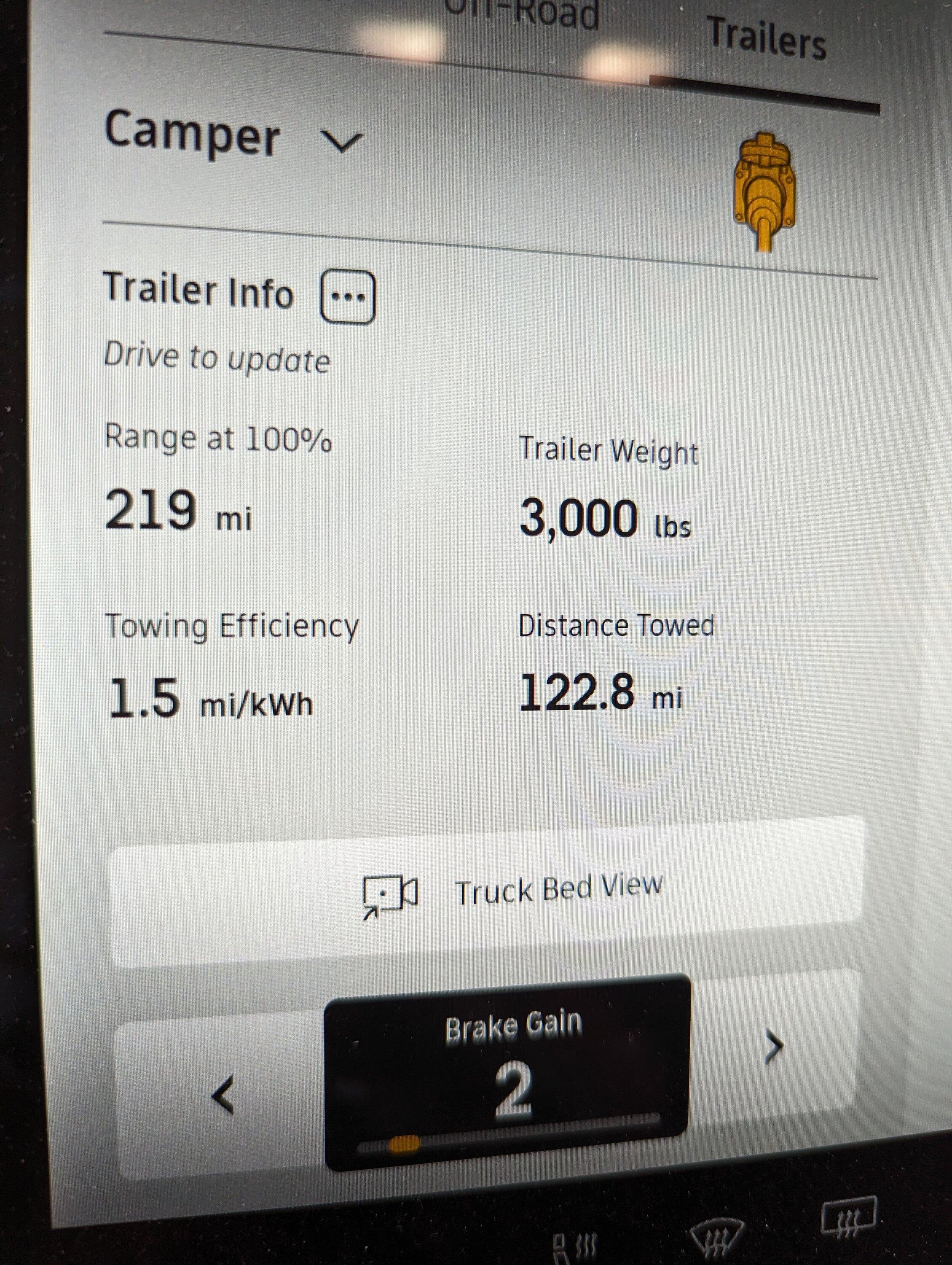

Here is our first towing/camping trip post-update:
Rivian R1T R1S My initial results with new Tow Mode PXL_20231022_224734201.MP
I think we are much closer to 4,000 lbs than 3,000. We had a tailwind both coming and going from our trip, so maybe that impacted our weight numbers, and definitely our efficiency numbers.
This is for the trailer shown in my avatar, short but pretty tall and boxy. We only take the highway if possible because we simply aren't in a hurry when we are camping. But this was a round trip, so zero elevation net.
More musings about efficiency and speed. Since we never towed an RV pre-EV life (Model X prior to R1T) we don't have any built in notions about how traveling and towing should be. I think people that have towed for a long time with ICErs that are used to taking the interstate will definitely have a harder time with range. Lower speeds equals better range, especially with an un-aerodynamic trailer. No way around physics.

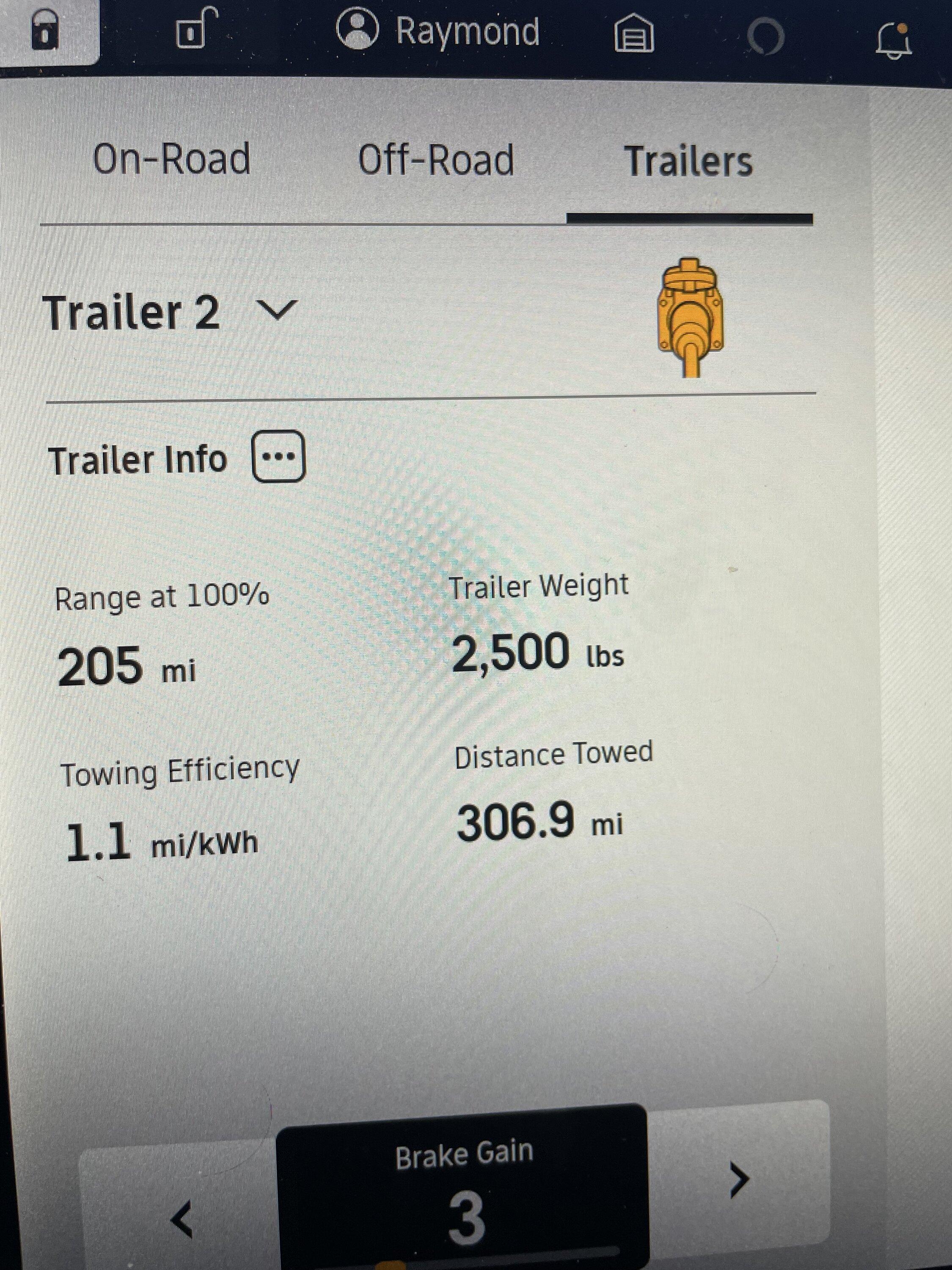

The trip meter showed I used 40kwh and got 1.26 mi/kwh. The real full range estimate should be about 150-160 miles, maybe after some more trips it will figure it out.
I would say that is not bad for 70mph, curious the difference with a horse. They need to make cargo & rv trailers more aerodynamic similar to the smooth & round front of your horse trailer. There are virtually no aerodynamic cargo trailers, if they have a V-nose the transitions are all sharp edged which kills the aero.

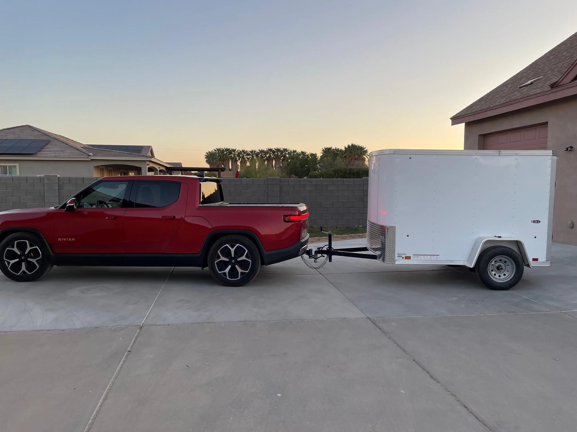

So I have now done several trips with my smaller enclosed utility trailer.
Rivian R1T R1S My initial results with new Tow Mode BoxTrailer
My speeds have been between 45-75mph, and it is showing 1000lb (about right, but I don't know the exact empty weight). It is getting 1.7 mile/kwh after about 80 miles of towing. What I notice is that at the start of each trip, it goes into "sensing" mode for the first 2 miles, which means it is trying to re-estimate the weight. This makes sense, because for many trailers the weight will vary from trip to trip, such as putting one or two horses in my horse trailer, or loading a flatbed with a car.

They have a ways to go yet.
Someone didn't get the memo that the large pack is not 180kwh.

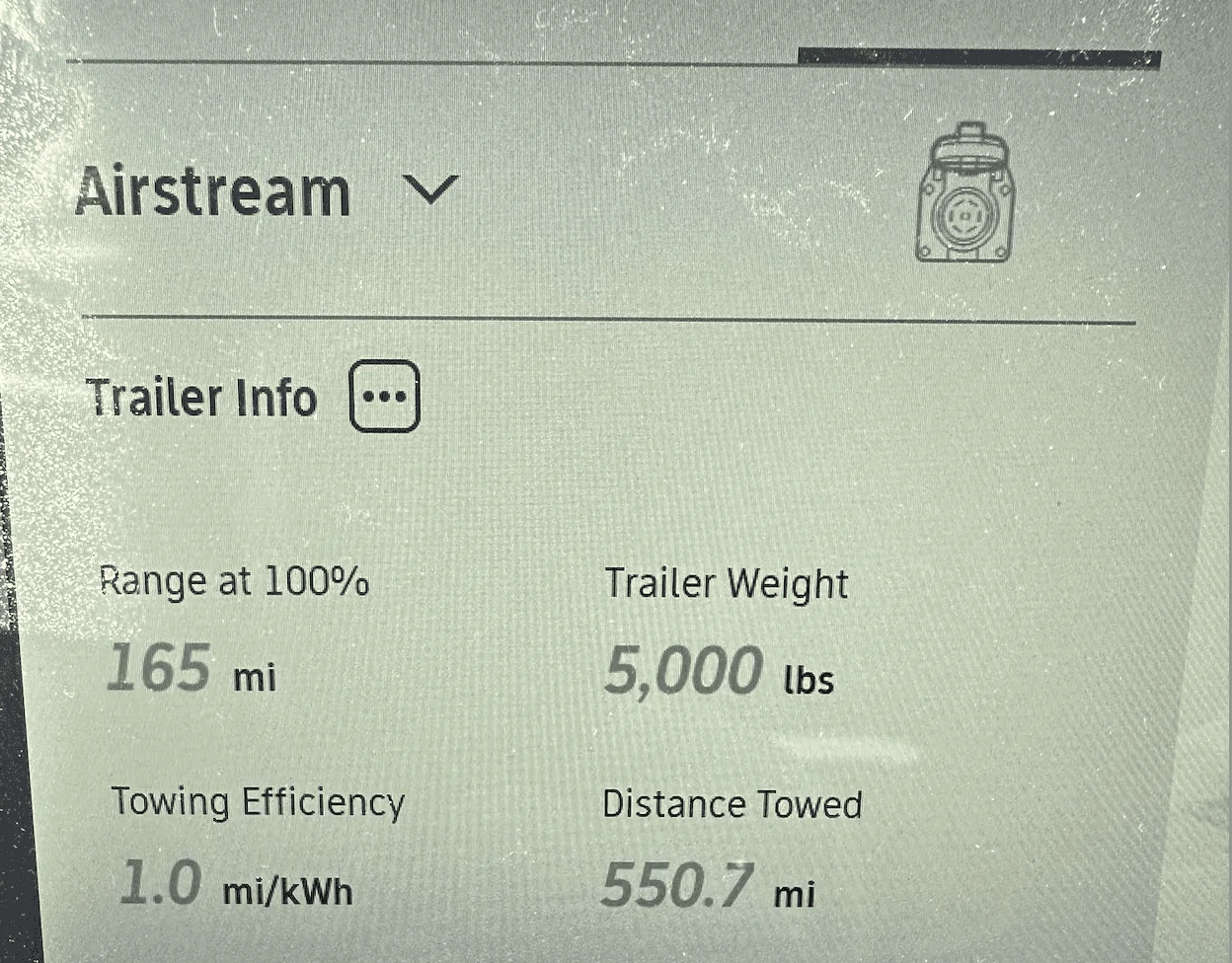

Rivian R1T R1S My initial results with new Tow Mode IMG_3623
KootenayEV
Andrew
Sep 22, 2021
614
589
Nelson, BC
R1T, Tesla Model 3
Environmental Engineer
Yeah I've noticed that the "Range at 100%" doesn't line up with the "Towing efficiency" - it also doesn't reset together, which seems odd to me. For now I'm just using the latter and ignoring the former.

Are you only getting 1mi/kwh with the airstream? I thought the results were better for the A-S
Epicloop
Ray
Jun 3, 2023
541
378
British Columbia
Electrical Contractor
I generally get 1.1-1.2 on reasonably flat terrain. Sometimes higher. Going up hill for long stretches is more like .9.
60mph?
Yes I have done much worse on hills with cargo trailer
