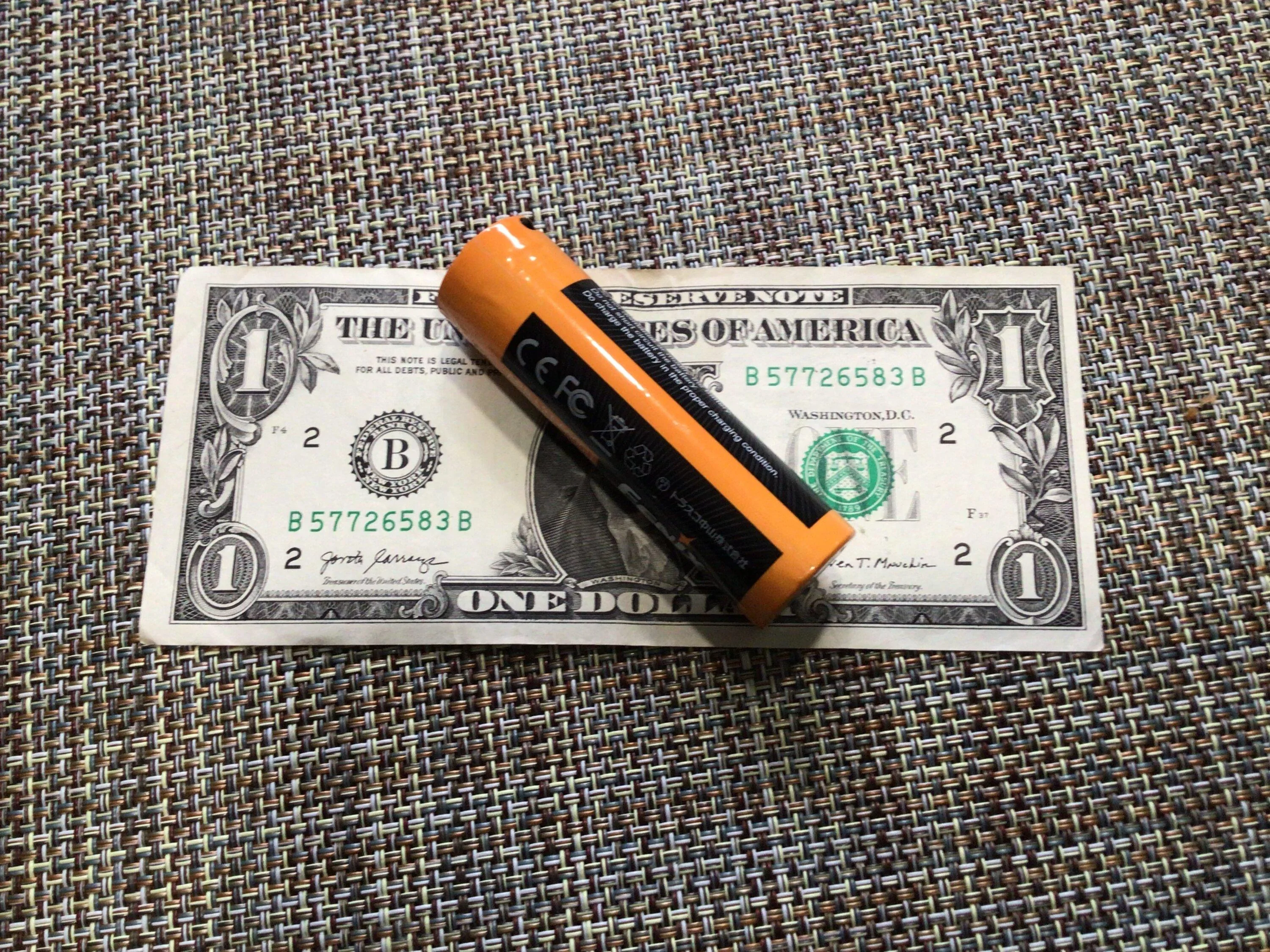

It's really not a big deal as long as it's not a systemic problem like the Bolt was. 7776 cells in the large pack, there's bound to be a few vehicles with bad cells.
Yup, 7776 of these puppies (not a Samsung but the same form factor)
