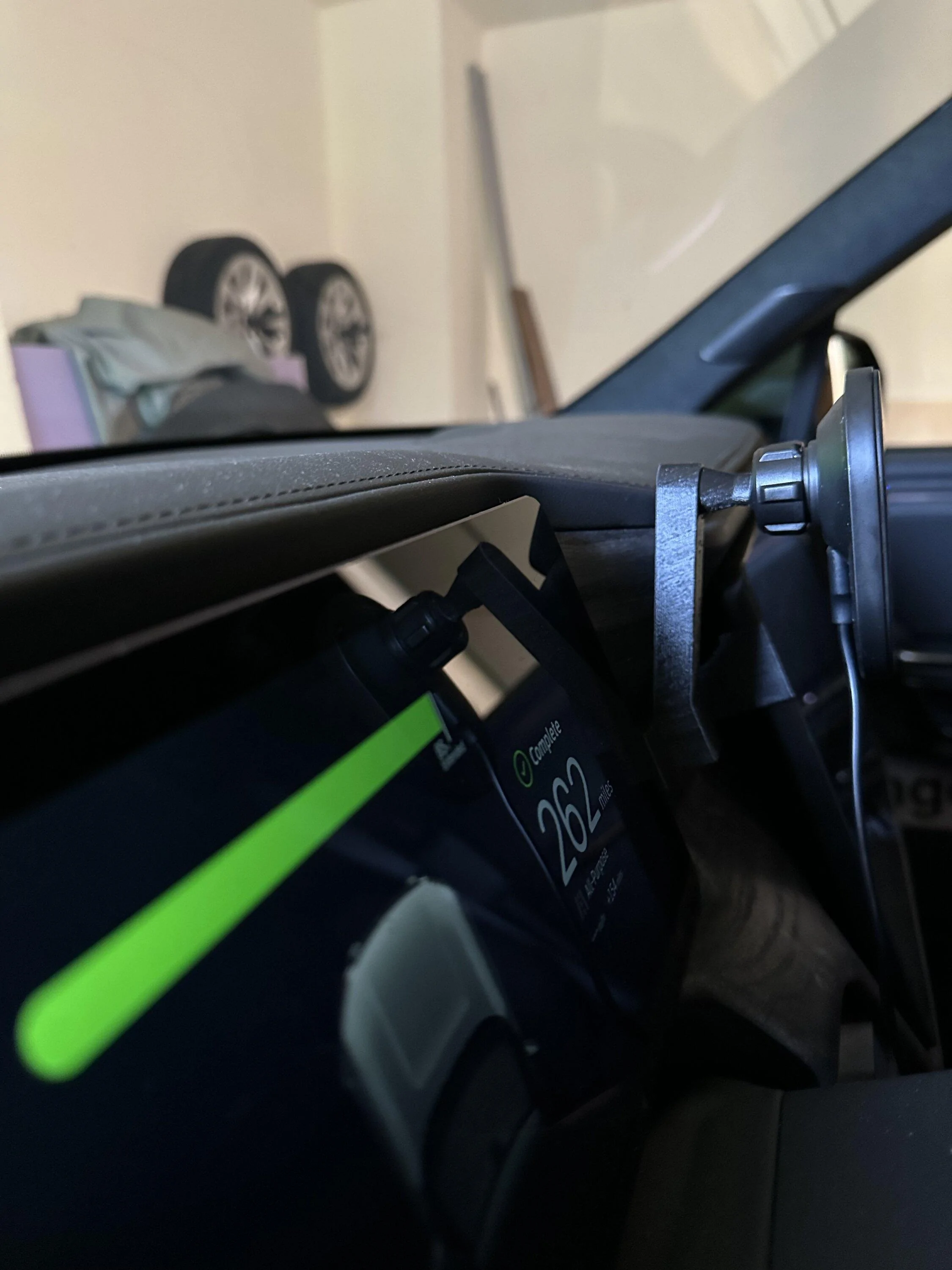

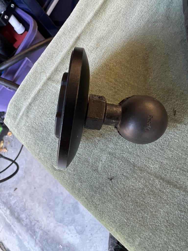

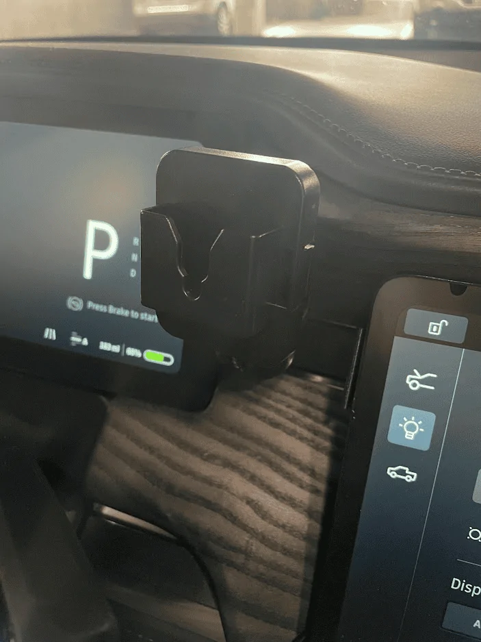

Another modification for those not wanting a ball mount and just needing a magnetic mount.
Rivian R1T R1S NEW - RIVIPARTS Cell Phone Ball Mount PRO PXL_20221120_140150511

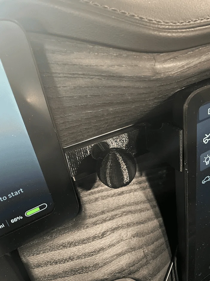

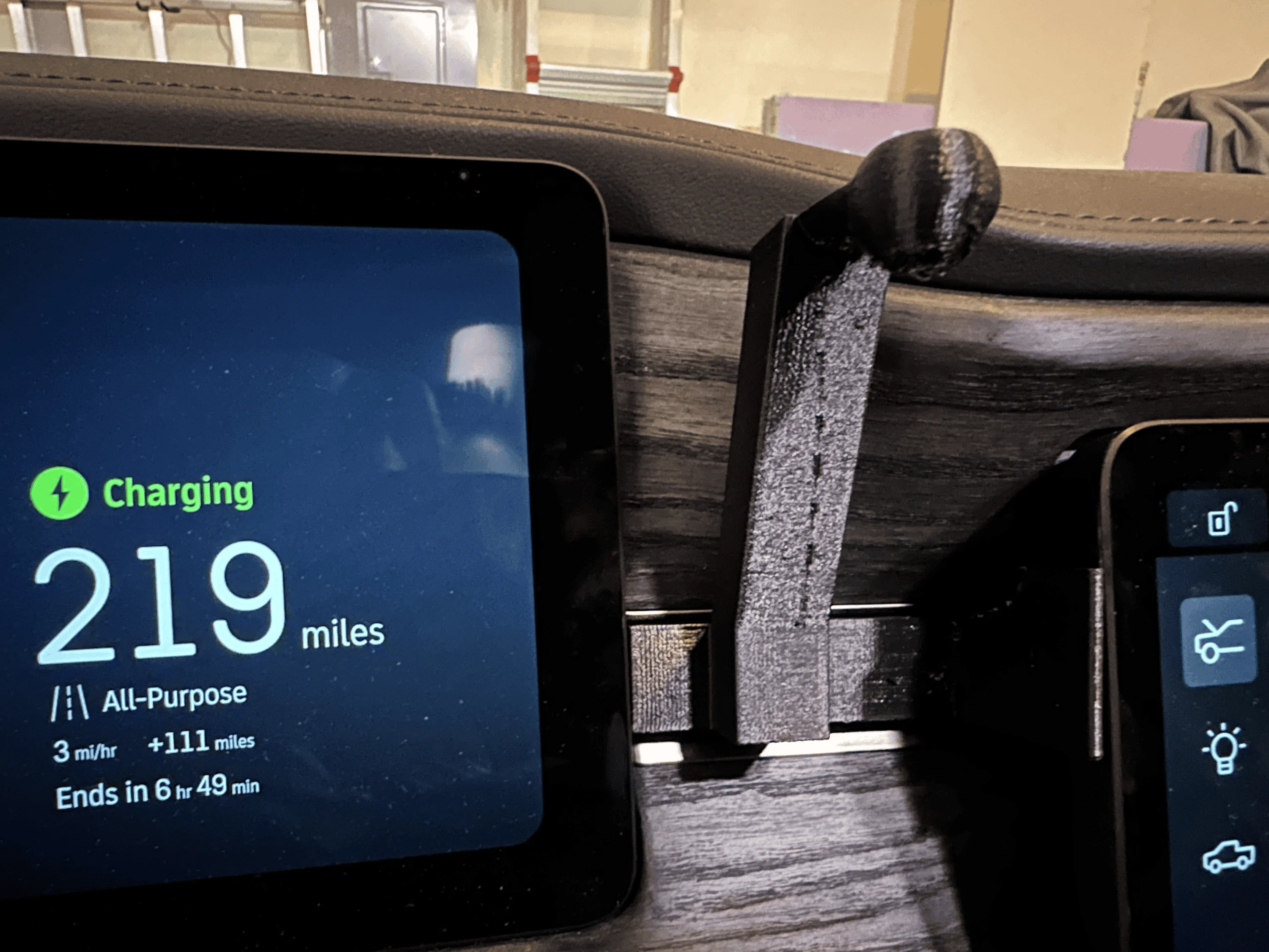

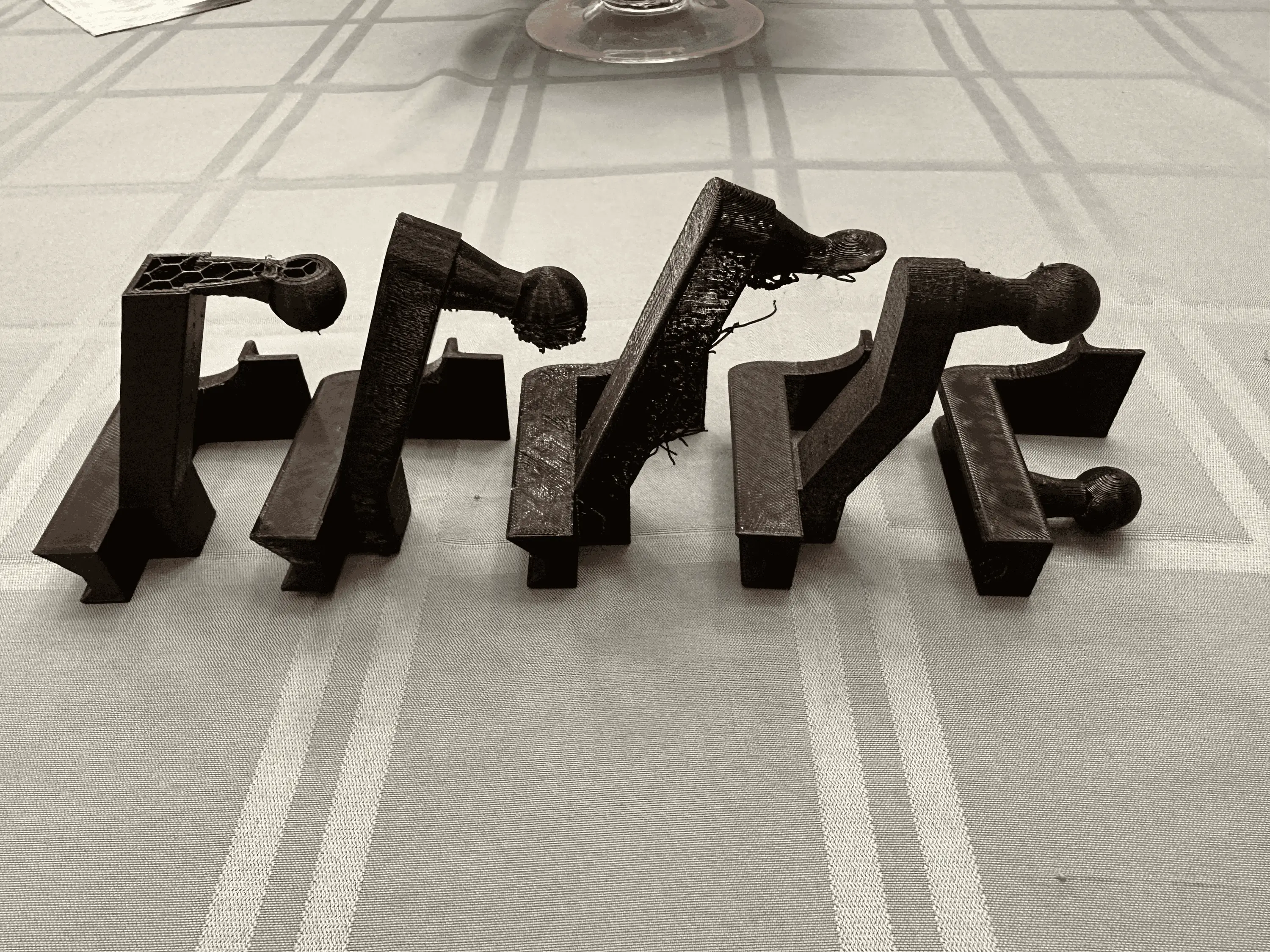

Step 8 - Having been satisfied at my own accomplishments, I decided to try a redesign to have it higher up. It turned out ok, but ended up rubbing against the trim. So back to the deign board. I repeated this 3x to get the spacing right. When I finally did, my kids unplugged my machine 5 hours and 45 minutes into a 6 hour print. This stuff is much harder than it looks.
Rivian R1T R1S NEW - RIVIPARTS Cell Phone Ball Mount PRO tempImageQw9XqU

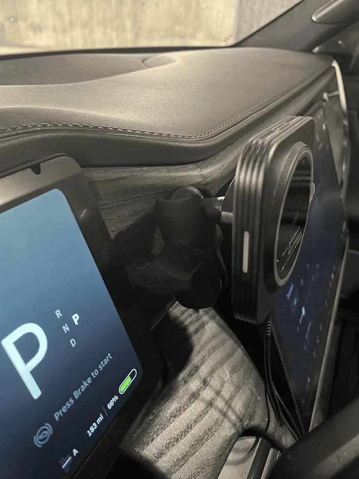

@RWerksman, thank you for giving me an excuse to buy a 3D printer. I have been wanting one for years. These are well designed and extremely reasonable in terms of pricing. It's a great help to the Rivian community.
Also, I went and modified the design a little bit so it stands up a tad more. I still have to upload the remix to thingiverse but basically it's a -25 degree pitch on the mount and a thicker base to prevent wobbling.
Rivian R1T R1S NEW - RIVIPARTS Cell Phone Ball Mount PRO tempImageEoFmvc

I had better luck with PETG than I did with ABS, I had the same issues with it snapping.
With PETG, I used the mostly default settings in FlashPrint. 0.12 layer height, 0.20 first layer. 80C bed, 235C extruder.
The “pole” is 3.25” long from the base, 1/2 thick, -25 roll.
I’m doing another one tonight. When I get happy with it I’ll post it up. I won’t be selling it but will share where I land.

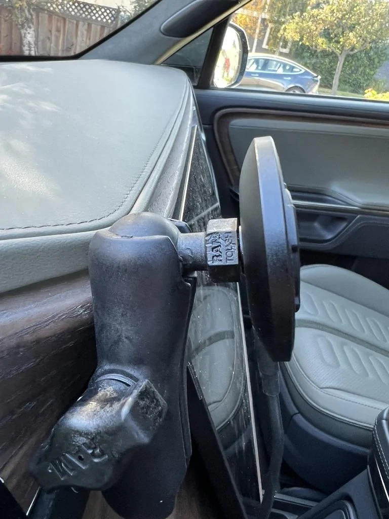

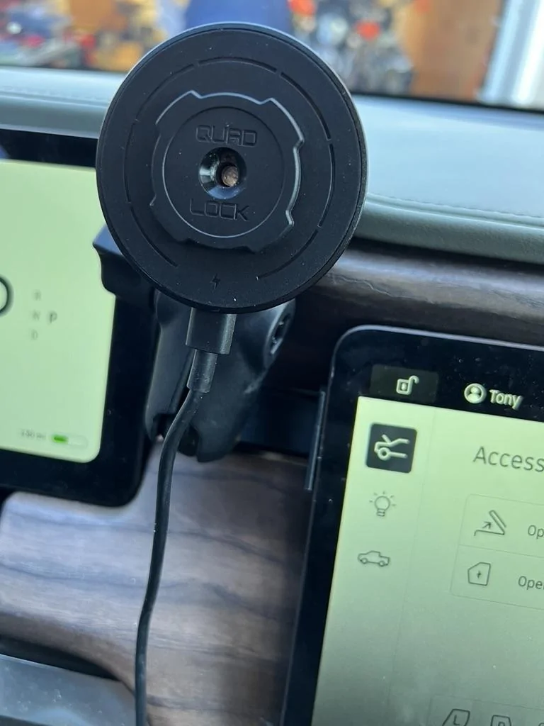

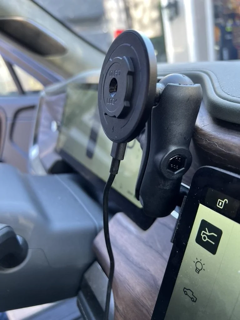

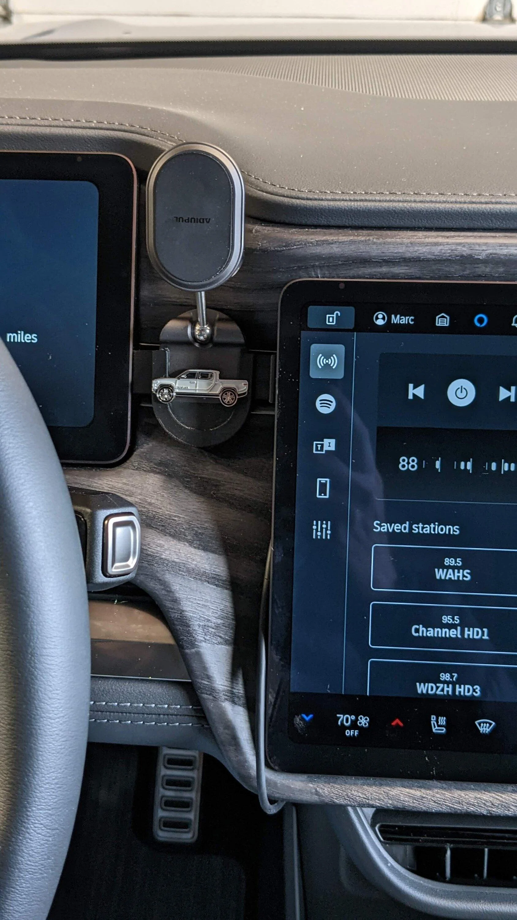

Quadlock Mag wireless charging head now installed with the Riviparts 1" RAM ball and double socket arm. The beauty is I can use the Mag head in the Rivian and the tradition Quadlock on my motorcycles. Location of the phone is prefect with the 3.75" RAM arm.
Rivian R1T R1S NEW - RIVIPARTS Cell Phone Ball Mount PRO 1669002768668
Rivian R1T R1S NEW - RIVIPARTS Cell Phone Ball Mount PRO 1669002786964
Rivian R1T R1S NEW - RIVIPARTS Cell Phone Ball Mount PRO 1669002814033
Rivian R1T R1S NEW - RIVIPARTS Cell Phone Ball Mount PRO 1669002835830

I have no idea how you’re pumping these out, it takes forever to just make one. Your printer must be going non-stop.
I just submitted a remix onto your profile. I’m not sure how it works, so hopefully I did it right.
The extension definitely acts as a lever, so some concern there. It seems to fit, seems stiff, but time will tell. It’ll have a iPhone 14 Pro on it so not light but not heavy.
Rivian R1T R1S NEW - RIVIPARTS Cell Phone Ball Mount PRO IMG_2976
I’ll update here if it ends up hitting me in the face as I try to show off the 0-60 and will be driving down some unpaved/gravel roads later today. So we'll see how it holds up in the short term.
Edit: 4 months, 8000 miles later..Seems to be holding up ok.
Which Ram Ball are you using to attach the quad lock mount? I think this is the way I am going to go.
I'm now awaiting this RAM Mag mount from Amazon :
RAM Mounts Ball Adapter for Apple MagSafe RAP-B-202-AP-MAGU with B Size 1" Ball
This RAM adapter and a strong MagSafe charger might be a better and cheaper way to go - even with a Quadlock case
Rivian R1T R1S NEW - RIVIPARTS Cell Phone Ball Mount PRO 1669142773118
I used this RAM ball and threaded some 1/4-20 threads into the Quadlock head for a good fit.

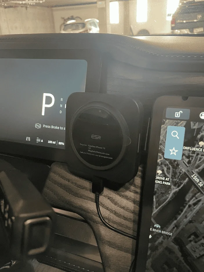

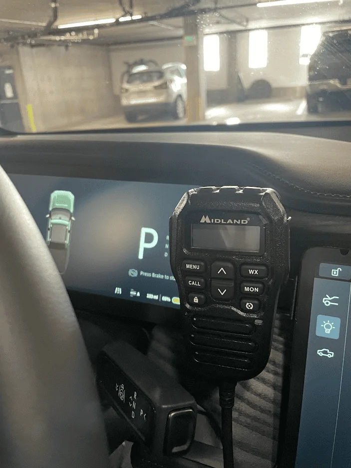

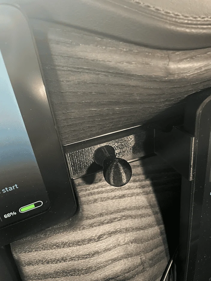

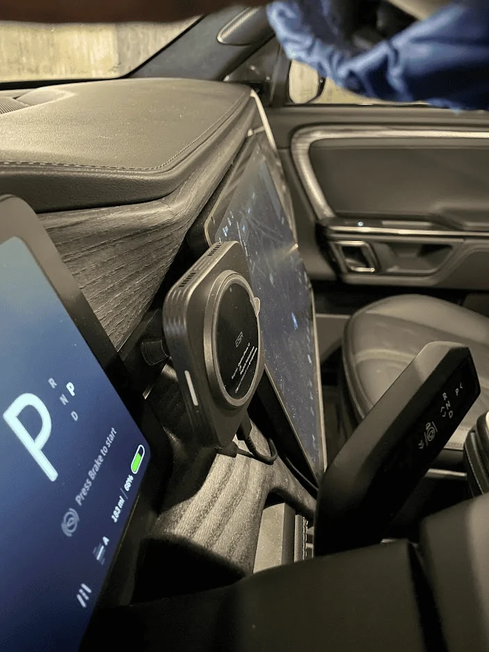

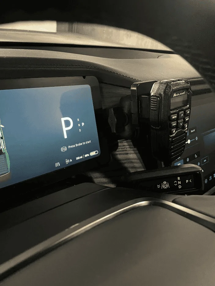

Have both of the latest versions and can attest they work great. Originally started with the 17mm version for my older magsafe mount but have switched to the 1in ram ball as I have several other accessories and an adapter that could work still with my charger. I used my shortest double socket arms in these photos but have some longer ones that would add some height if preferred. Thanks for making these!
Rivian R1T R1S NEW - RIVIPARTS Cell Phone Ball Mount PRO 1669145727867
Rivian R1T R1S NEW - RIVIPARTS Cell Phone Ball Mount PRO 1669146000221
Rivian R1T R1S NEW - RIVIPARTS Cell Phone Ball Mount PRO 1669146015654
Rivian R1T R1S NEW - RIVIPARTS Cell Phone Ball Mount PRO 1669146034380
Rivian R1T R1S NEW - RIVIPARTS Cell Phone Ball Mount PRO 1669146045244
Rivian R1T R1S NEW - RIVIPARTS Cell Phone Ball Mount PRO 1669146052001
Rivian R1T R1S NEW - RIVIPARTS Cell Phone Ball Mount PRO 1669146060330
1in with 17mm adapter
