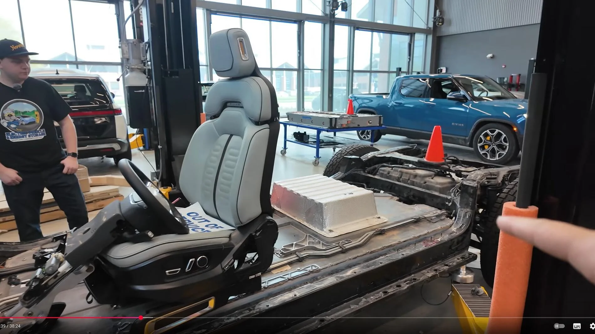

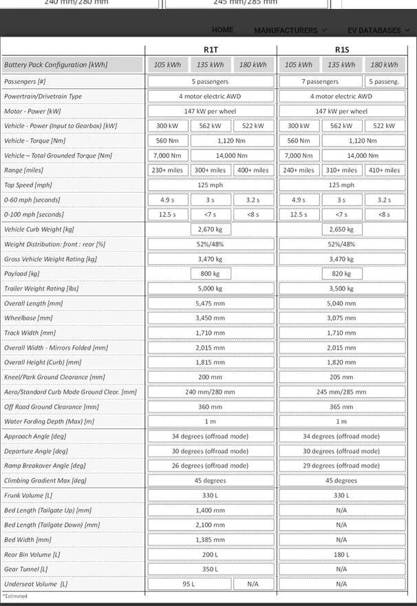

Like a fair amount of other long time 2018-2022 preorder holders, The OG Max pack was around 180kWh usable, as compared to 141kWh like the current version on sale today.
The video is from OutOfSpec as they tour Normal Illinois EV facilities, etc while picking up an OOS Gen2 Max pack on lease. Super cool that Rivian, very early on, was trying to help prop up the community and engage with students to foster an interest in automotive, and EV's specifically. Shout out to Ford as well.

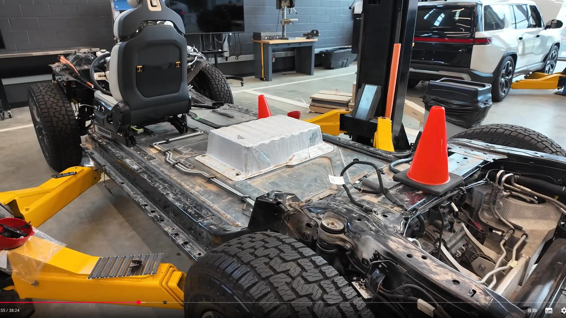

The comment from the tech is incorrect in the OutofSpec video below, it's actually an extra 3 modules. From 9 in the original large pack, to 12 in the max pack. 2 on the back of the pack and one additional module under the rear seats. Which actually aligns with the original under seat storage loss per the spec sheets.
Screenshot 2025-05-05 at 15-39-03 Rivian R1S is a Behemoth of an Electric SUV with a Range of ...jpg
I wonder if the main reason for the max pack being altered to a similar 9 module higher density form factor, was due to some pack incompatibility with the R1S and it's shorter skateboard. I know there was some talk that the payload was too hampered by the additional modules which could have been a further reason for its non production.
Screenshot 2025-05-05 at 15-31-57 (109) We Need More EV Techs! Full Tour - Heartland Community...jpg
Screenshot 2025-05-05 at 15-33-36 (109) We Need More EV Techs! Full Tour - Heartland Community...jpg
I still wish they managed to make it to production, however, given some of the thermal limitations etc, they probably made the right choice.
I was told confidentially from an internal source that one of the main driving forces behind moving away from a 180 KW battery was the inability to have a usable third row seat in the r1s with the physically larger battery they had come up with. The r1t, with its longer wheelbase, could have supported the additional modules in a different form factor. But with r&d and manufacturing costs needing to be considered for the r1s launch, having multiple versions of the max pack, and possibly multiple minor chassis configurations above and beyond the base platform configurations was just too much to juggle.
Btw, this is the same source that explained the chemistry change for max pack was happening instead of a physically larger pack months before it was announced. So I consider all this on good authority.
