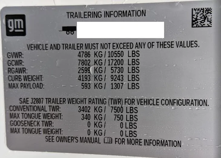

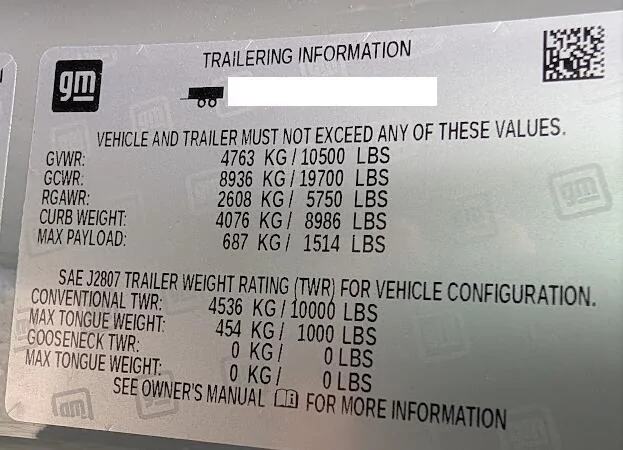

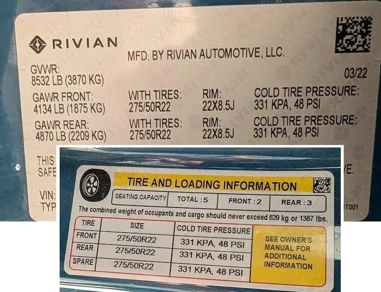

And the GM vehicles are larger overall and I believe much heavier. Too lazy to verify.
Based strictly on payload, my R1T has a much higher towing capacity vs available payload, since it's rated for 11k towing and my T only has 1387 lbs payload. A 180 kWh pack would push it way down from already being kinda low. Rivian couldn't reasonably have left the tow capacity at 11k, since 10% is the generally accepted minimum tongue weight.
My '22 R1T:
Rivian R1T R1S OMG The freaking OG 180kWh Max Pack was actually made!!!! 1753448454107-
My '24 Sierra Denali EV:
Rivian R1T R1S OMG The freaking OG 180kWh Max Pack was actually made!!!! 1753447398644-zt
Hummer EV I had in '22:
Rivian R1T R1S OMG The freaking OG 180kWh Max Pack was actually made!!!! 1753447225606-5k

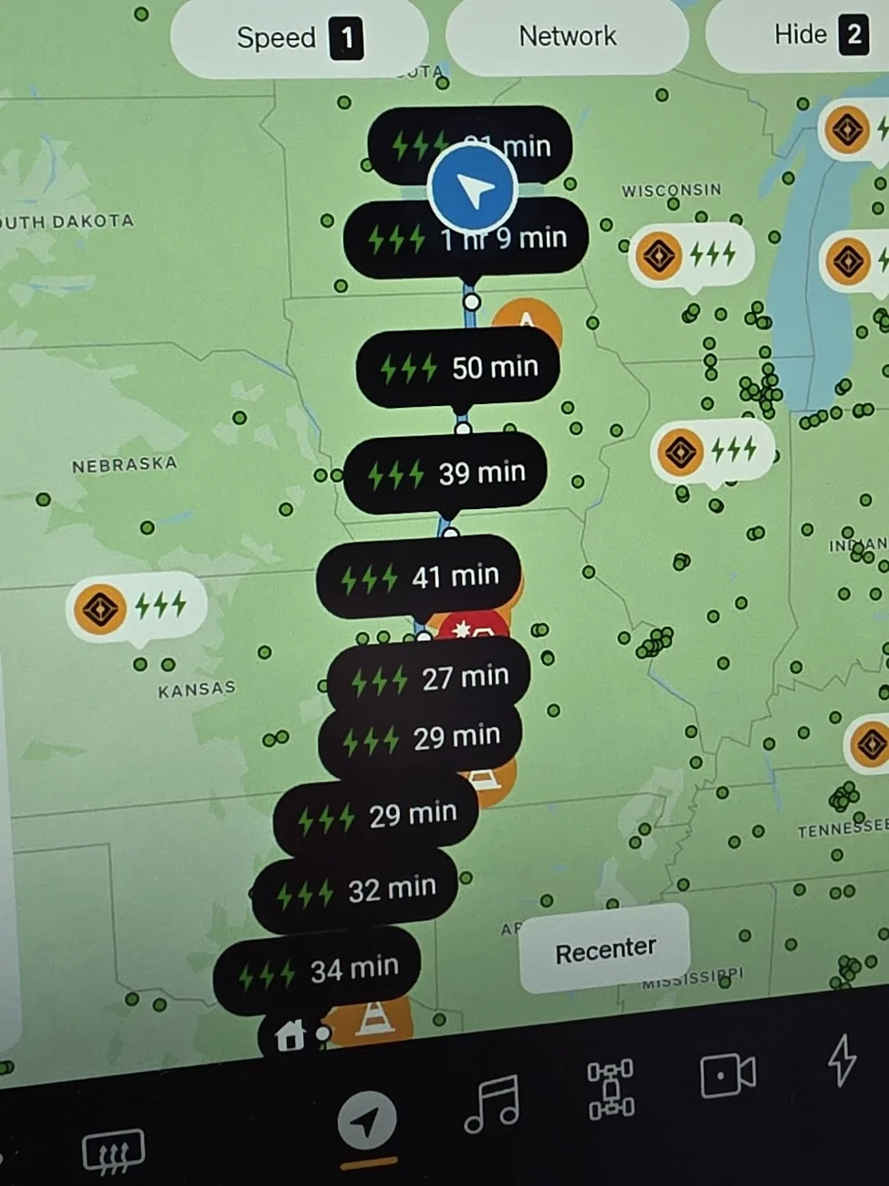

When towing a large trailer about the only thing that matters is KW.
[/QUOTE]
*kWh
but, yeah, you're right :) otherwise your towing trips will look like this šŸ‘‡
Rivian R1T R1S OMG The freaking OG 180kWh Max Pack was actually made!!!! 1761324305294-cx
