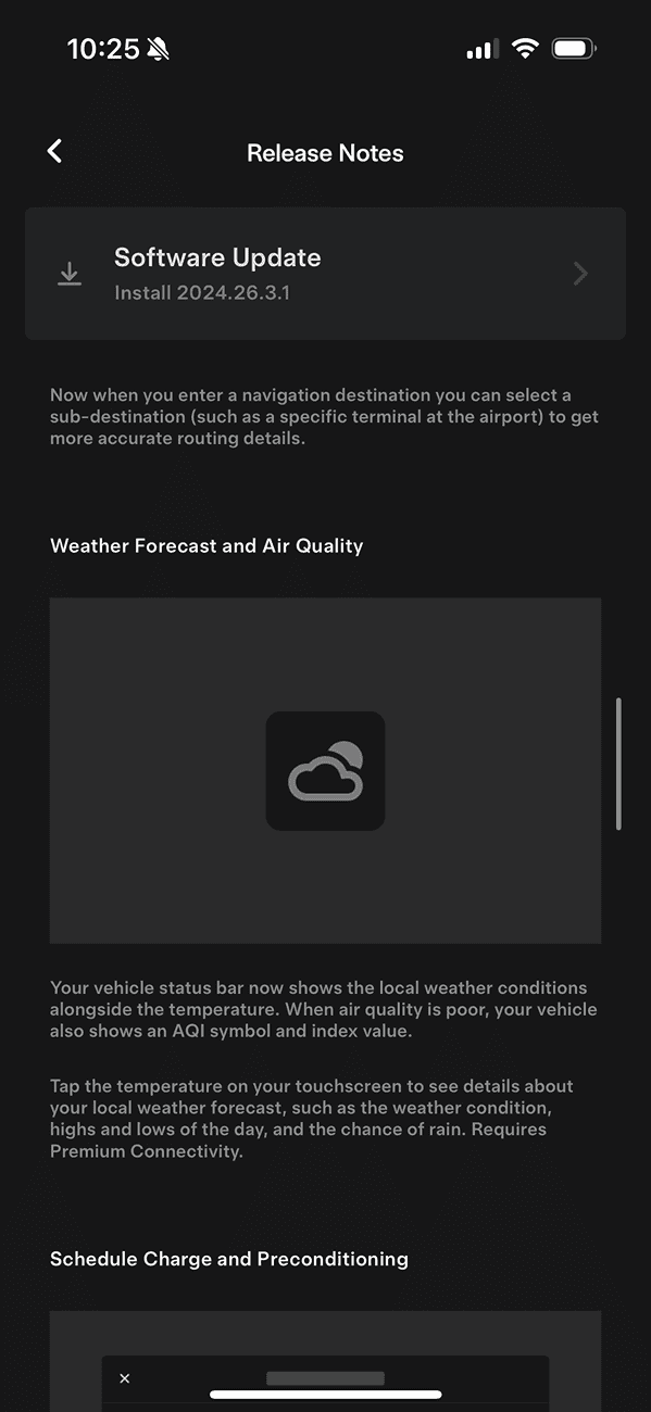

just got an update for my Tesla.
they overheard us talking.
