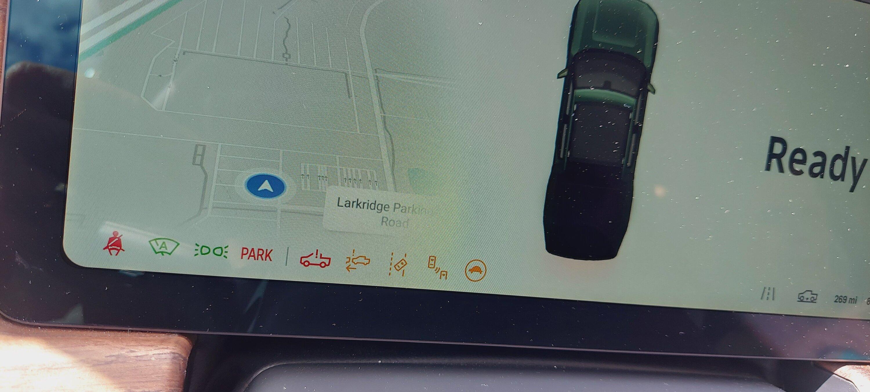

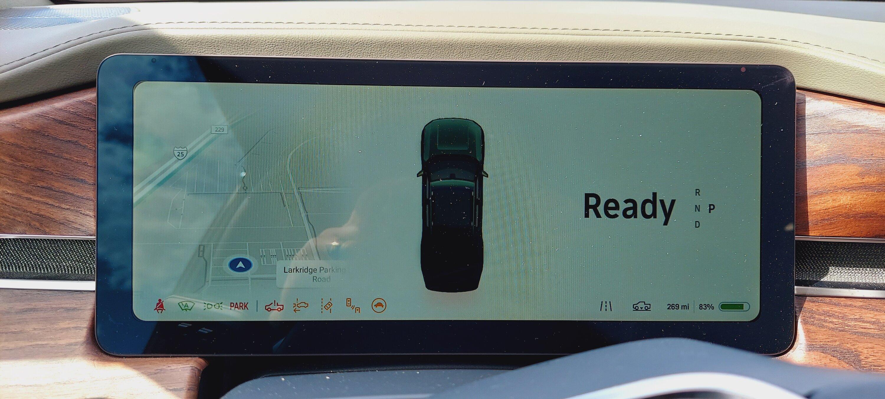

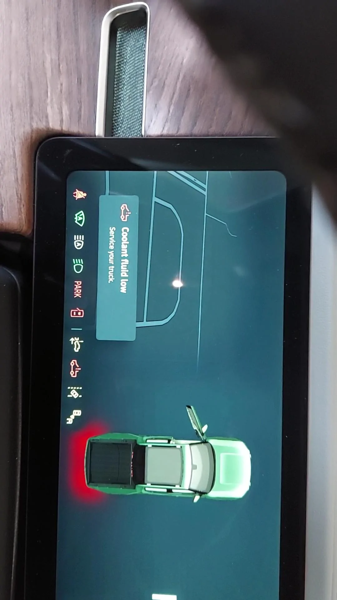

Got delivery of my R1T Forest Green/Forest Edge QUAD motors with Large pack on Friday 16,2023. Love the truck how it performs and everything about it!
Today I when to wall-mart for some shopping and we also chose via navigation, the closest to us that had Fast chargers by EA. So I figure let me get my first charge! When we came back about 30 minutes later it was just finish (2 minutes over) so I unplug it (my wife was with me) and got in. As soon as I step on the brake I got a message saying "Performance limited Right Now, Drive with Caution", "Driver+ features unavailable", "Coolant low". So I called in and did a restart of the vehicle but didn't solve the issues. It also I could not use my phone as a key or a card as a key. The only thing that allow me to start the truck was the key fob that thankfully my wife had it with her! Currently my Green Mean Machine has only 252 miles on her. Anyone else experience this issue?

So far I’ve fast-charged twice without preconditioning (not set as a destination in nav) and most recently once with preconditioning. All three went fine with no issues. Yesterday‘s (with preconditioning) was under less than ideal circumstances since we arrived with 16% and the temperature was high-90s. Started the session, went into a mall for a restroom stop and to take a little stroll. Also, it turns out, to buy a couple things we didn’t strictly need but did want.
I don’t think I’ve seen other posts like yours so this may be a rare issue just with your truck: maybe a battery cooling system (leak?) or a bad sensor reporting the coolant low when it isn’t. Please keep us posted with the diagnosis and repair and I hope they get you fixed up quickly.
Needing the fob to start is a little disturbing since we typically take 2 phones and 2 cards with us.

I agree with all your comments (especially that the truck should know if it needs to precondition or not). It is disturbing for this to happen...Especially the coolant part..Is possible for the coolant to leak because the tank somehow it was defective or something else that going on? Or did I get a truck that is a lemon? Well I have until Friday to decide if is worth it:confused:
BTW I had issues with my phone in the morning. IT will not recognize it as key. I had to use my wife Fob key to move the truck. Then finally I figure it out after it gave me the message to delete it and re-register it again. When the charging issue happen my phone and card keys did not work only the fob key work.

SC is closed today. Update: The OP issue is still there even after the truck is sitting in the garage for 24 hours and the battery is cold. I can only use the key fob to get in by unlocking it. Proximity sensors are not working (part of the limited performance issues I'm guessing). My mobile phone and key cards are not working to wake it.
However when I use the key fob and got in and it was ready to go. Drove it around in my neighborhood and it seems drivable to the SC tomorrow. 🤞
