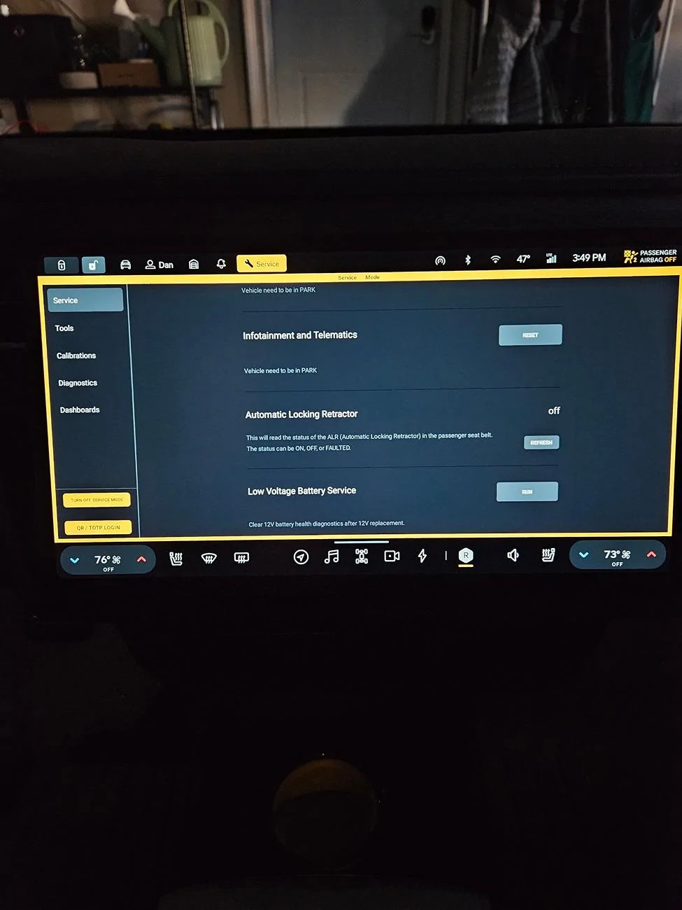

Very helpful! How do you access the RIDE menu?
I have a 22 R1s that has performed well (still getting above EPA even in moderately cold temps) but I do travel in the northeast to hit the mountains so . . . .

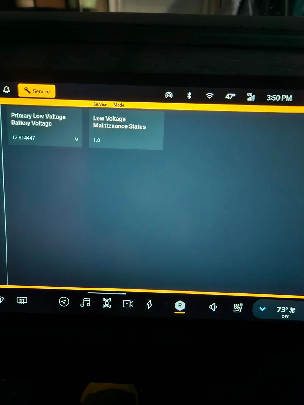

Put the car in service mode via settings; click on menu bar 5 times and the RIDE icon will show up when you swipe up; click on the quote 5 times, enter code 33748.
I decided to take a peek and see if there is anything wrong, even though Home Assistant is showing normal operation. I'm not seeing anything out of the ordinary? Also, is that 12V diagnostics option normal?
Rivian R1T R1S Proactive replacement of 12v battery 20250107_155023
Rivian R1T R1S Proactive replacement of 12v battery 20250107_154932

I finally started showing the 12v battery warning after around 60k miles, and 3 years.
Checking the built-in RiDE menu, "Low Voltage Maintenance Status" changes from 1.0 for healthy, to 0.0 for unhealthy.
Side note, there is a 12v reset menu option now in RiDE which is fun.. Ordered the adapters because Rivian using standard 12v 18Ah batteries with a custom proprietary post was stupid.
