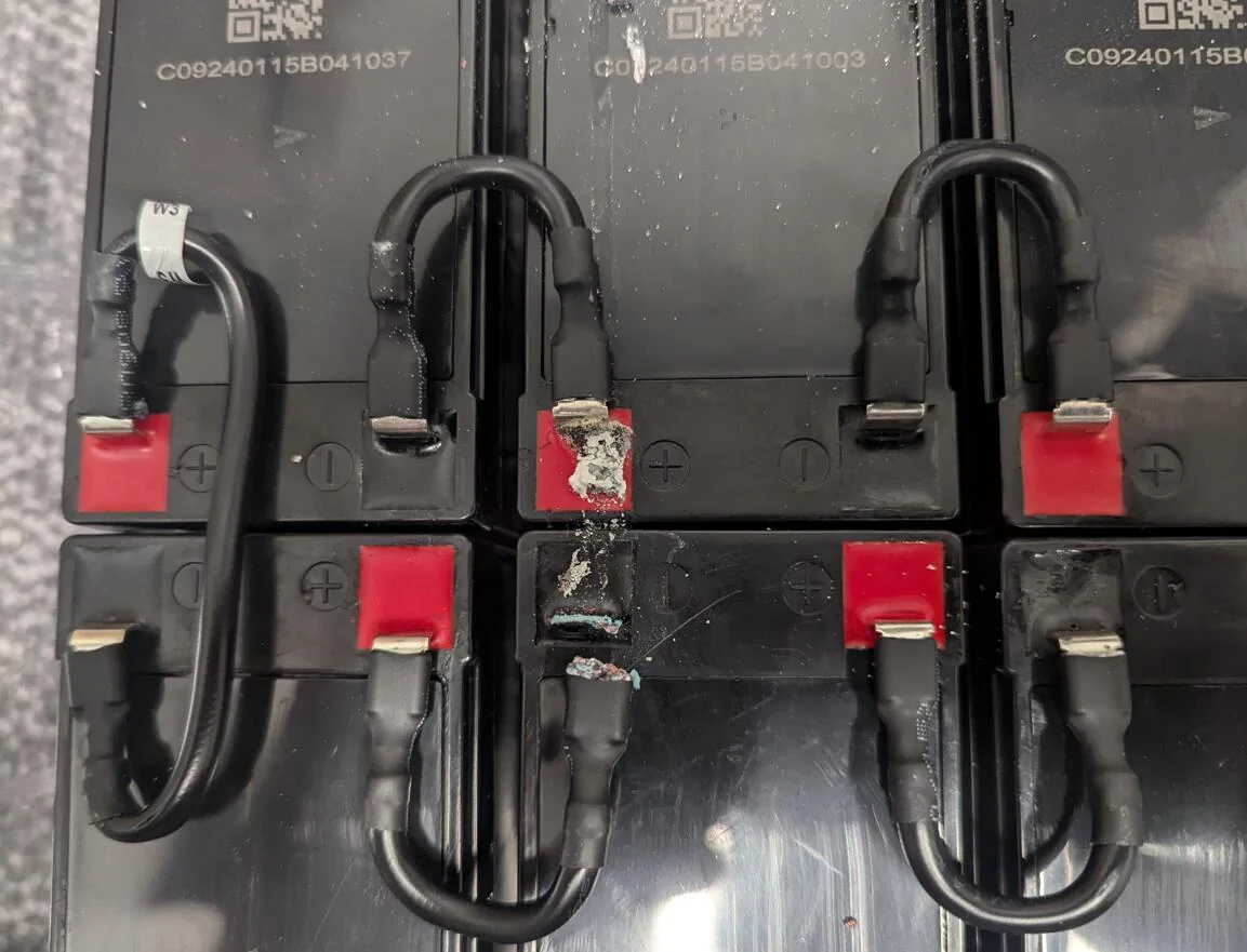

I deal with a lot of lead acid UPS batteries. A Lot. Charge/discharge cycles, ambient temperature, quality of manufacture, it all matters. Unfortunately, unless you load test them, they can report good voltage until the moment they fail. I don't know what sort of load testing the truck does on them internally to check health. It could be great, it could be horrible.
I just had to replace a UPS battery pack because it was working fine one day, and failed the next.
Turns out one of the SLA batteries in it had a small leak that led to corrosion of one of the battery tabs. It worked fine until the corrosion was enough to eat through the tab completely. Thats how these things go sometimes.

To actually answer your question, you'd need to pull them out, and charge/load test them individually.
That's the only way to know. You could have batteries that are still 90% capable, or ones that are about to fail. No way to know without testing.
