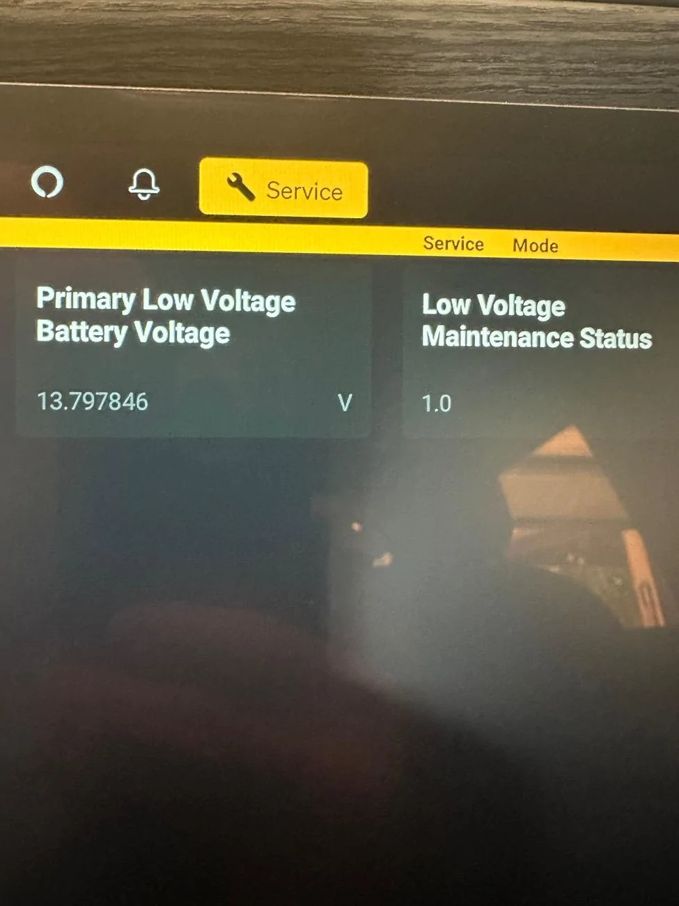

Anyone knows what maint. Status 1.0 means?
Attached is the Pic from ride menu
It means it's normal_operation.
It’s the inverse I think, it’s a ‘Boolean float’(eww):
  • 0=false=no maintenance required
  • 1.0=true=maintenance required
Our gen1 R1S with no 12v issue shows 0 here, while our gen1 R1T that’s throwing 12v warnings is showing 1.0.
This is the exact opposite of what I see. Checked this morning, and these are the statuses I see:
Low Voltage Maintenance Status = 1.0
12v Battery Health (reported from API) = normal_operation
these values are probably unrelated then (perhaps the RIDE menu is reporting on the bms itself or something rather than the status it’s reporting), and we are trying to correlate too far, in home assistant I’m showing:
  • normal_operation for the R1S that’s showing 0 in the RIDE menu
  • A0 for the R1T that’s showing 1.0 in the RIDE menu (and complaining about 12v heath in the app)
