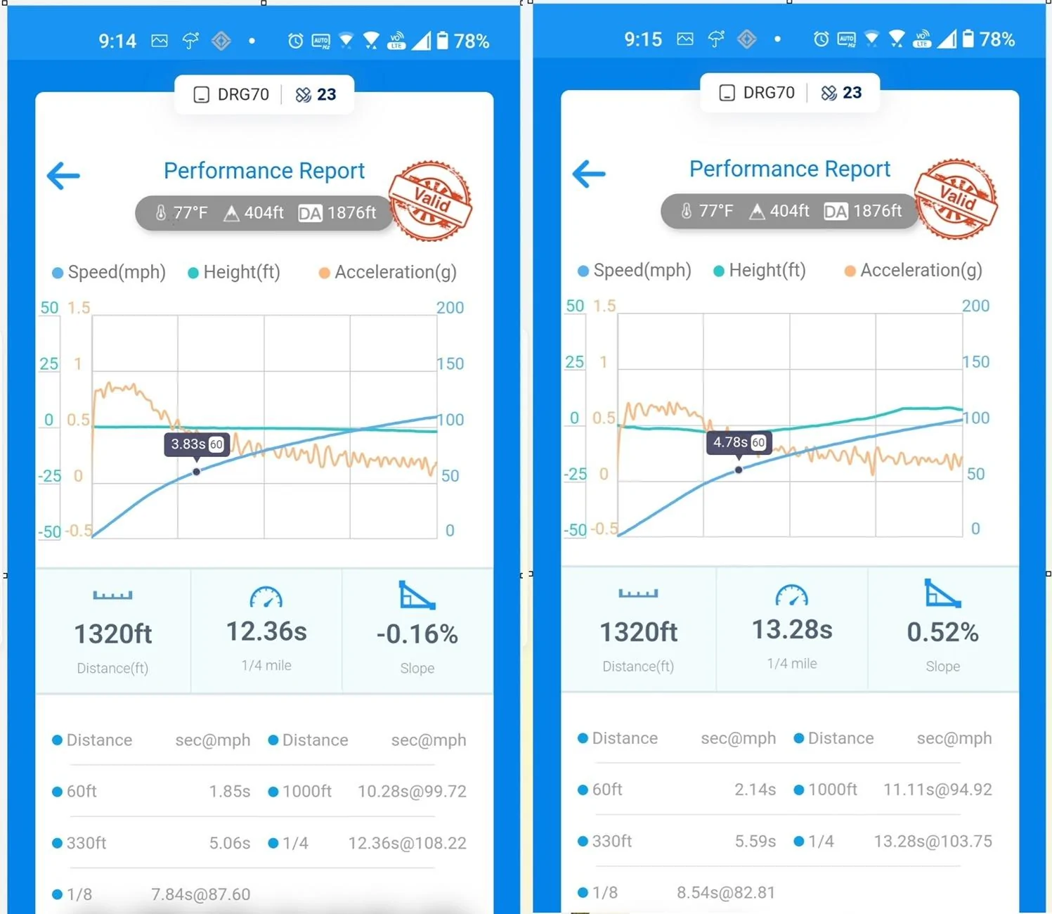

PDM Max AT, Sport/lowest vs. All-Purpose, after ~45mph the acceleration is the same.
Thanks for this, great to see some data when perceptions seem to vary so much.
I would love to see AP on performance dual vs AP on Standard Dual... Curious to know if they really are the same when not in sport mode
