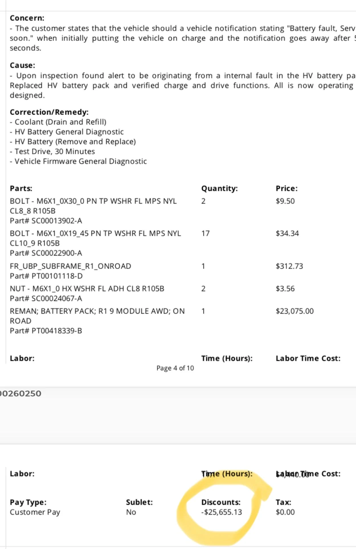

Mine was a remanufactured and the cost was almost $26,000 which was covered.
Had mine replaced with a RE-Manufactured pack. Cost was almost $26,000 covered under warranty. Range is up to EPA rating. These remanufactured packs are probably other ones that have been returned and rebuilt and or repaired. Enclosed is the invoice.
