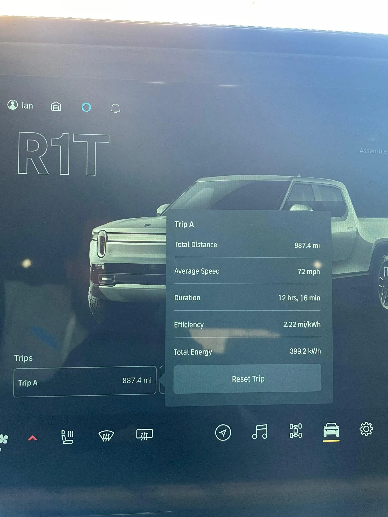

I just finished a trip back to Denver from Tucson, AZ. 887 miles with a lot of up and down (Tucson -> Show Low -> ABQ -> Denver), and overall climb from 2600ft in Tucson to 5280ft in Denver. I got in the 3's when doing big downhill sections, but overall not bad. On the way down to Tucson, I got amazing mileage, around 2.45-2.5 mi/kwh. Here's what I observed on the route back:

Hmm interesting reading through this thread. I too am with Sgt Beavis/Butthead, getting solid range estimates and mileage. Even better when drafting behind a semi using highway assist.
I just finished a trip back to Denver from Tucson, AZ. 887 miles with a lot of up and down (Tucson -> Show Low -> ABQ -> Denver), and overall climb from 2600ft in Tucson to 5280ft in Denver. Here's what I observed:
What was the wind? Seems like you had a little bit of push from behind.
I actually mostly had headwind on the route back. I wasn't trying to hypermile it, but I could definitely hear and see the wind coming towards me on Tuesday. Local conditions from Tuesday along the drive points (driving north) show predominantly S, ESE, and SE winds around 10-15 mph.

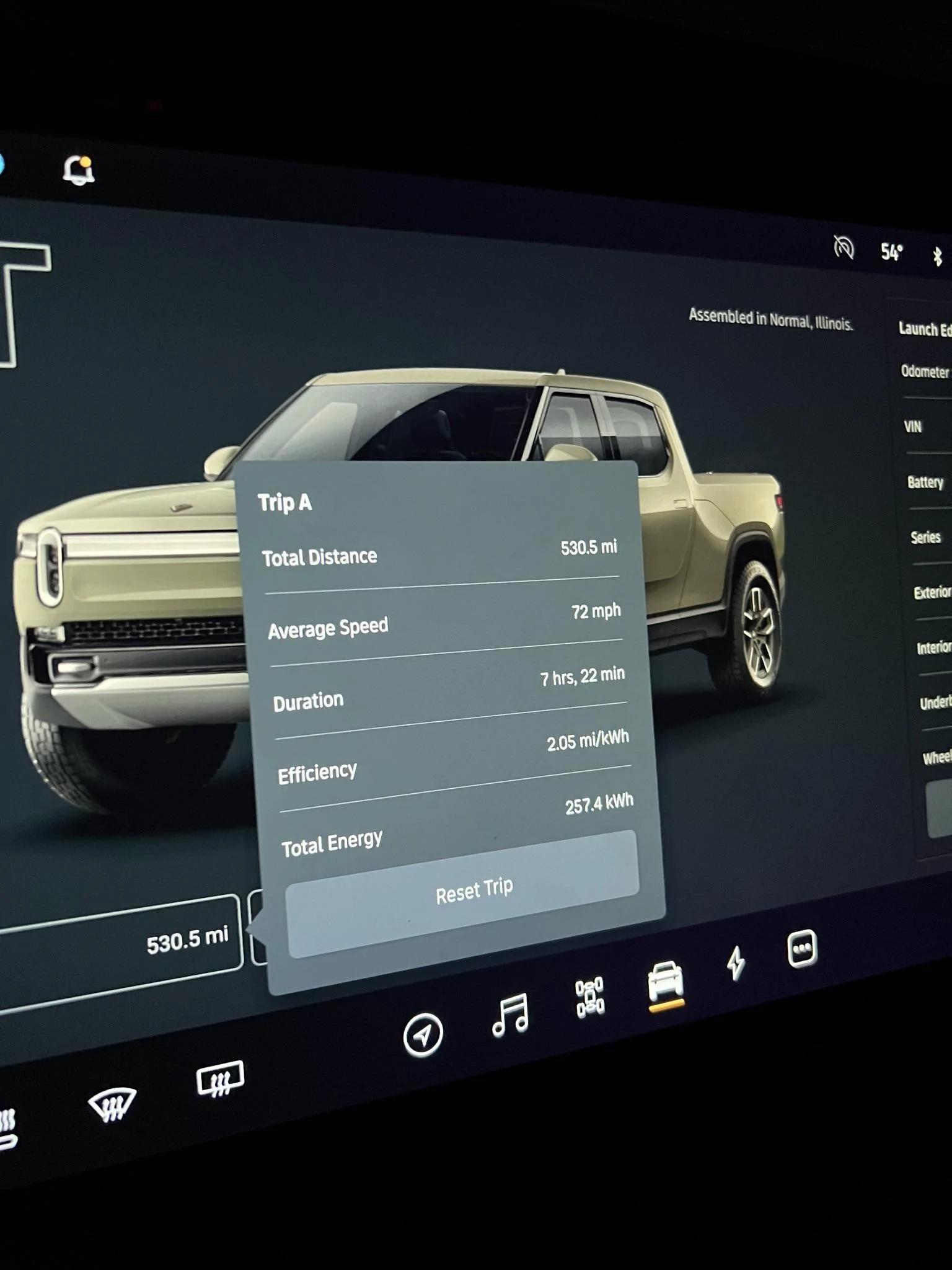

Rivian R1T R1S R1T's range is so impressive, even on 20" tires. Averaged 2.38 mi/kWh on 400 mile road trip F83203F2-B567-4A54-BE12-4CC608CA6A5E
My recent trip from Bay Area to vegas. Two charges (Bakersfield and Barstow). Had two bicycles in the bed.
That seems like you had tailwinds if they were out of the S and you were driving N? Don't think you mentioned what drive mode, but perhaps you were also in Conserve? 2.22 in any mode is definitely not achievable at over 70mph with a 10-15mph headwind uphill, of that I am certain, because I achieved 1.94 in Conserve with a similar headwind going slightly downhill at lower speeds.
I was driving north, wind direction was south/SE/ESE (i.e. out of the north/northwest, the prevailing pattern for NM/Colorado winds across the Rockies) so I was driving against wind, generally. I was in conserve mode in low (not lowest). Stock tire pressure around 48 on all 4.
Got it. Yeah, that's not physically possible, so something was messing up the trip calculation (which it's been known to do). Typically average speed can be slightly understated vs. overstated (because it's time based and not speed based), so this would be the first that's happened.
¯\_(ツ)_/¯ just stating what I observed and what resulted from the trip. The average speed was likely clocked average from ABQ to Denver, as Tucson to Show was more variable. The portion from ABQ to Denver is almost entirely a straight line on I-25 for 500 miles with a big gradient of elevation changes (yet overall elevation delta is only like 30ft).
Yeah, not trying to sound accusatory or combative, just thinking out loud.
ABQ to Denver is only about 450mi but the tripmeter is showing nearly 900, so it's the full trip from Tucson that's being reported. I have heard reports of sometimes DCFC messes with the energy usage stat, which could underreport that figure and overstate the efficiency. Might be what happened.
