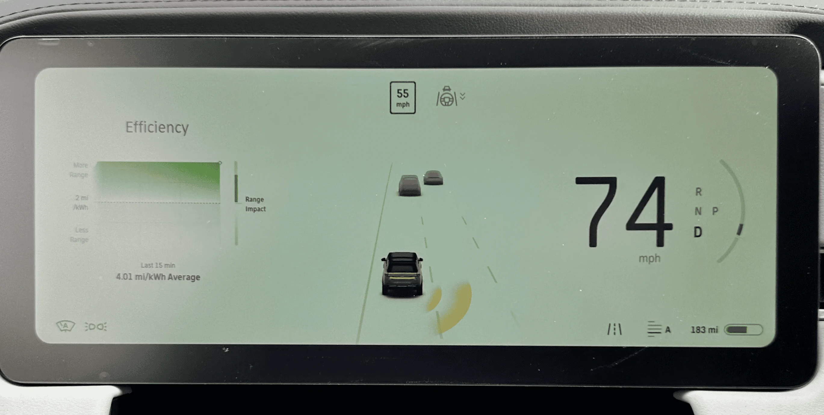

I drove up and back to Leadville this week on I-70, my first time using my new R1S in the mountains. A couple of times on long descents, I got a warning that regenerative braking was reduced, and so had to use the regular brake pedal more, but there was always a warning. And it only lasted a few seconds, and then regenerative braking seemed to be back to normal.
Certainly leads to pretty nice efficiency graph. I came down from the tunnel through Idaho Springs averaging 80-85 mph, but was still able to get a 4+ efficiency. Going the other way up the hill was not quite as impressive... :)
(had to slow down to take the photo)
