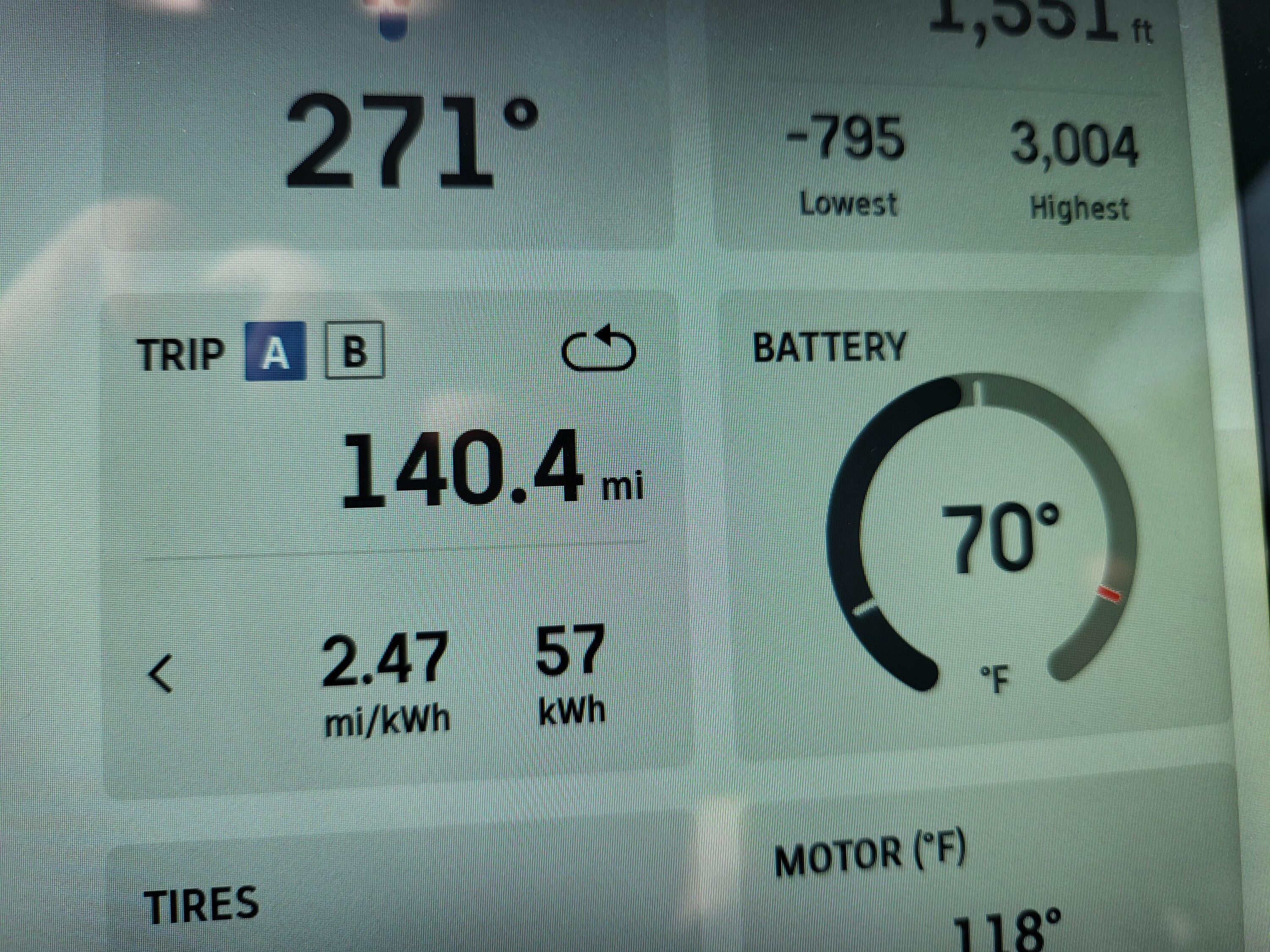

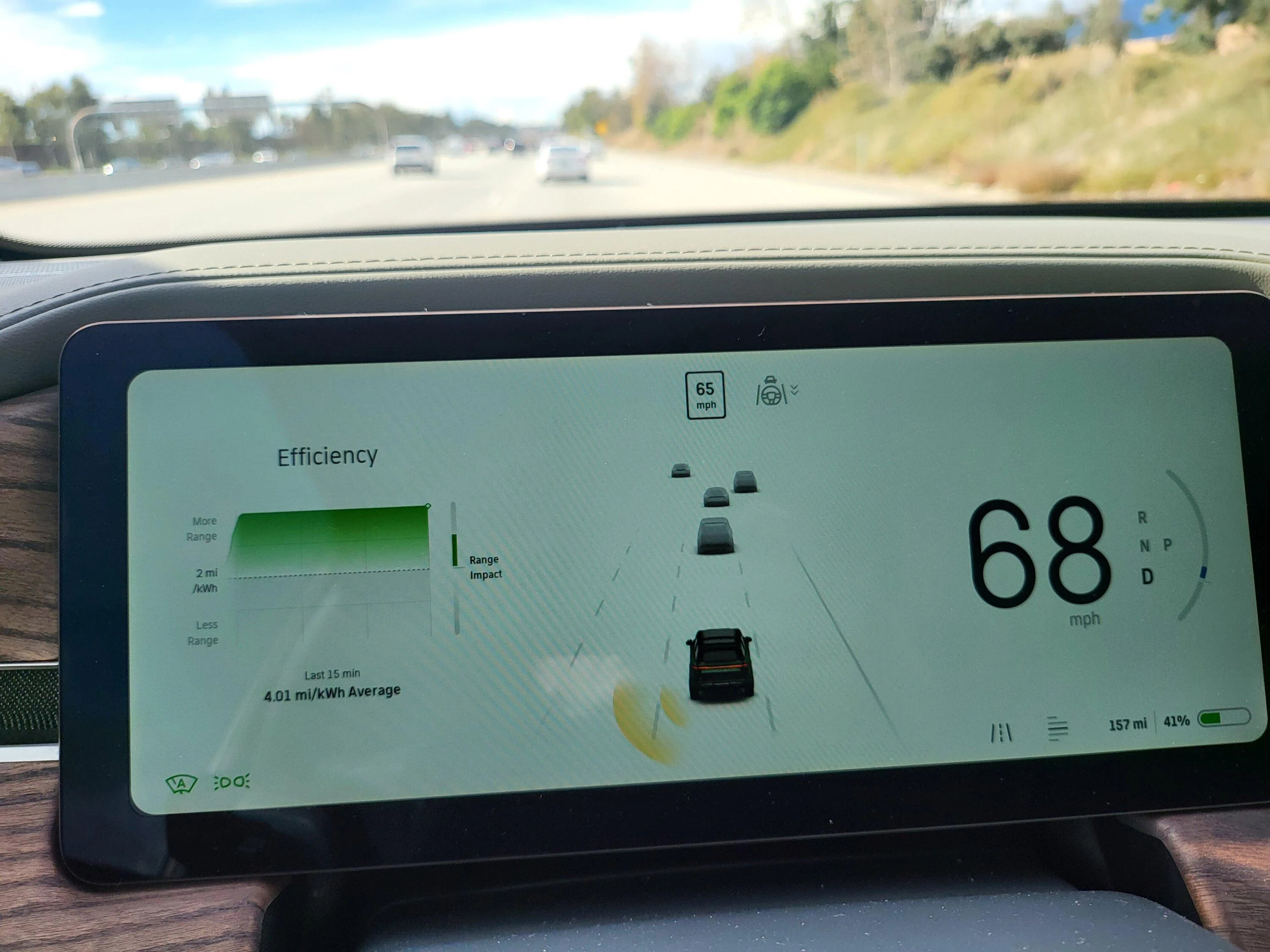

I had a day like that. It's interesting that it doesn't take much of a downhill to really bump the efficiency up. This shot was taken on a freeway with gentle decline. Earlier I was on the cajon pass and got a warning and a reduction for a short bit. Going up in the morning averaged 1.6mi/kw. Coming back 3.5 so 2.5 average for the 140mi round trip.
