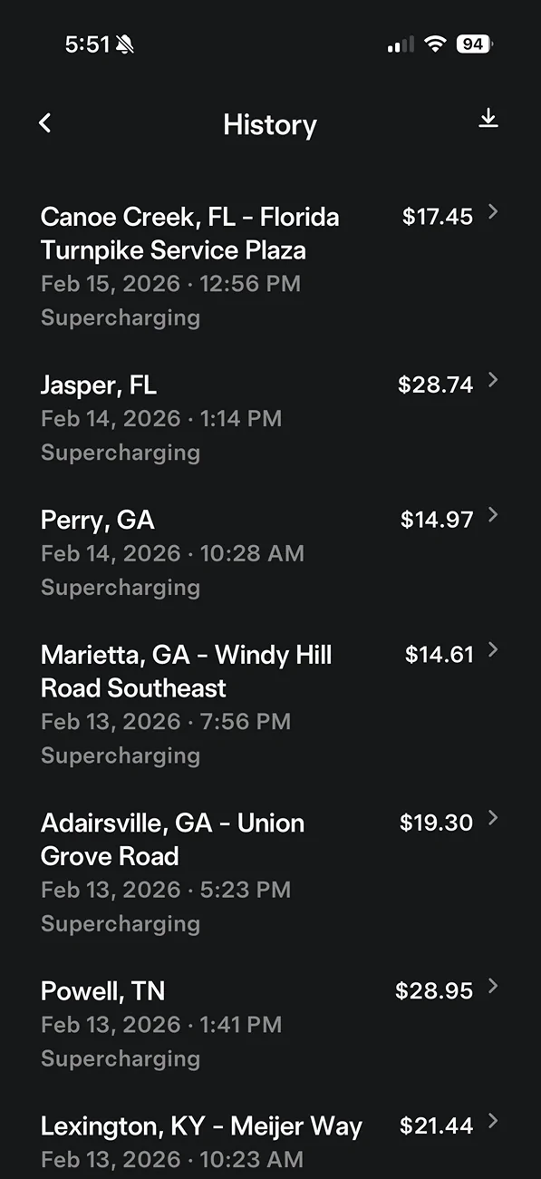

I love love love Rivian. I’m sad that I have to use Tesla to charge on the road. 2 trips from South Florida to Michigan. We are forced to use Tesla every time. Do better @Rivian. #sad
