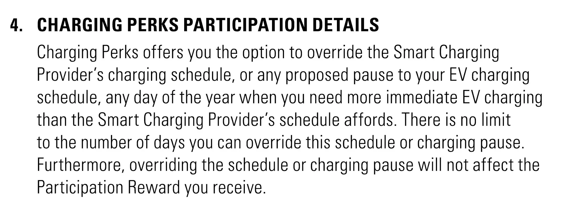

Part of the program (at least through my utility of XCEL Colorado) involves letting the utility decide when to charge your car. You can restrict it to off-peak hours, and tell it what time you want the car charged by. XCEL might choose to charge the car at midnight one night and 3am the next night.
I think this is a little misleading. They can throttle your power or shift times during times of higher demand, true, but you can easily override this so you are still ultimately in control of when you charge.

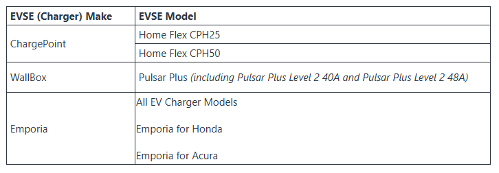

Weavegrid is very interesting. Everything was fine when I had my Model S. No ToU relationship with Rivian, but if I had a Chargepoint, Wallbox or Emporia charger I would get ToU pricing. Seems a little ridiculous that my Tesla Gen 3 charger doesn't qualify.
