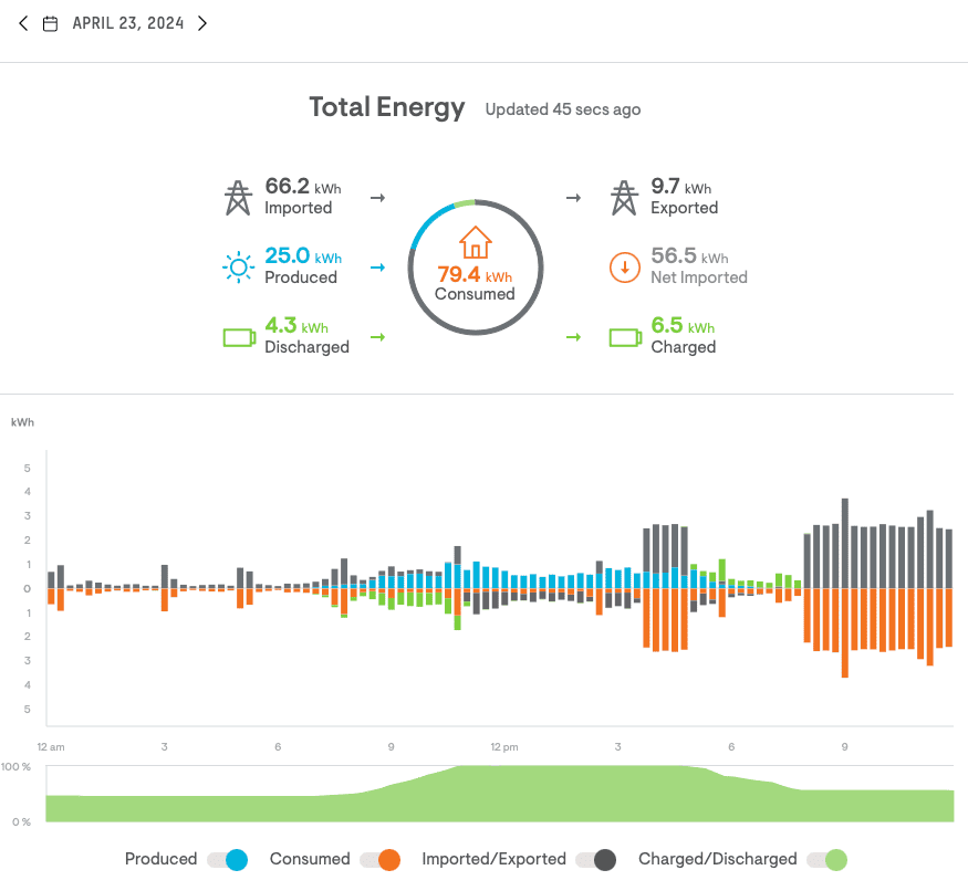

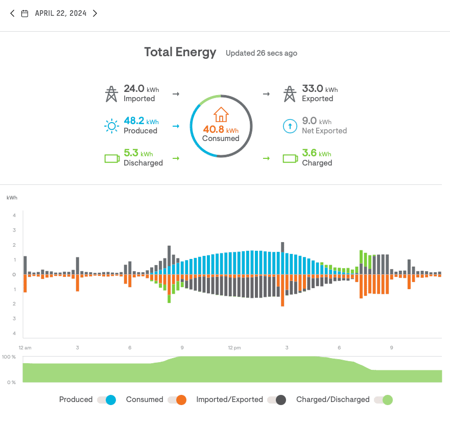

Here's a quick update to my note on Page 1 of this discussion. Yesterday was overcast here in the Bay Area and we produced approximately half of the solar power in our system. The first screen picture attached is from two days ago (when it was a cloudless day) and the second is from yesterday. Note that the difference in consumed kWh yesterday is because the truck was charging.
For reference, my solar system is about two years old now so it's using recent Enphase Technology. My main point here is that a complete home system won't provide enough energy to charge a vehicle, so there's really no way to get any impactful solar energy into a vehicle using a portable solar set up. As others have said, the best solution at this point is to likely carry a generator and use it to charge off the grid.
