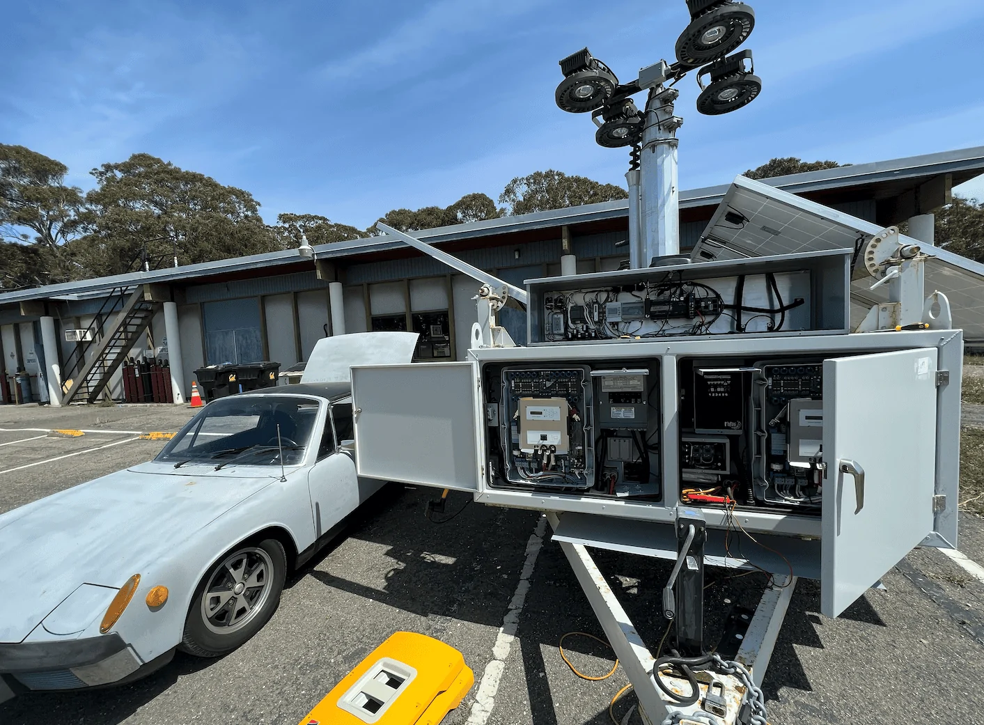

We received several of their trailers for upfitting after they folded. The array configuration and battery tech was pretty anemic. It struggled to charge even my EV conversion 914 that had a cumulative 15kWh of energy. Still kinda cool looking though!
