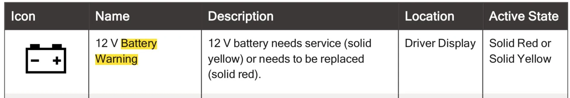

Makes sense. But is there no warning or way to check health of 12 Volt battery?
There is supposed to be a warning but if it is an instant failure it may not have triggered the warning.
There is built-in logic to test the 12-volt and alert you if you have an issue. It doesn't work 100% of the time though. Others, like myself, have Home Assistant integrations that will show the 12-volt battery health.
