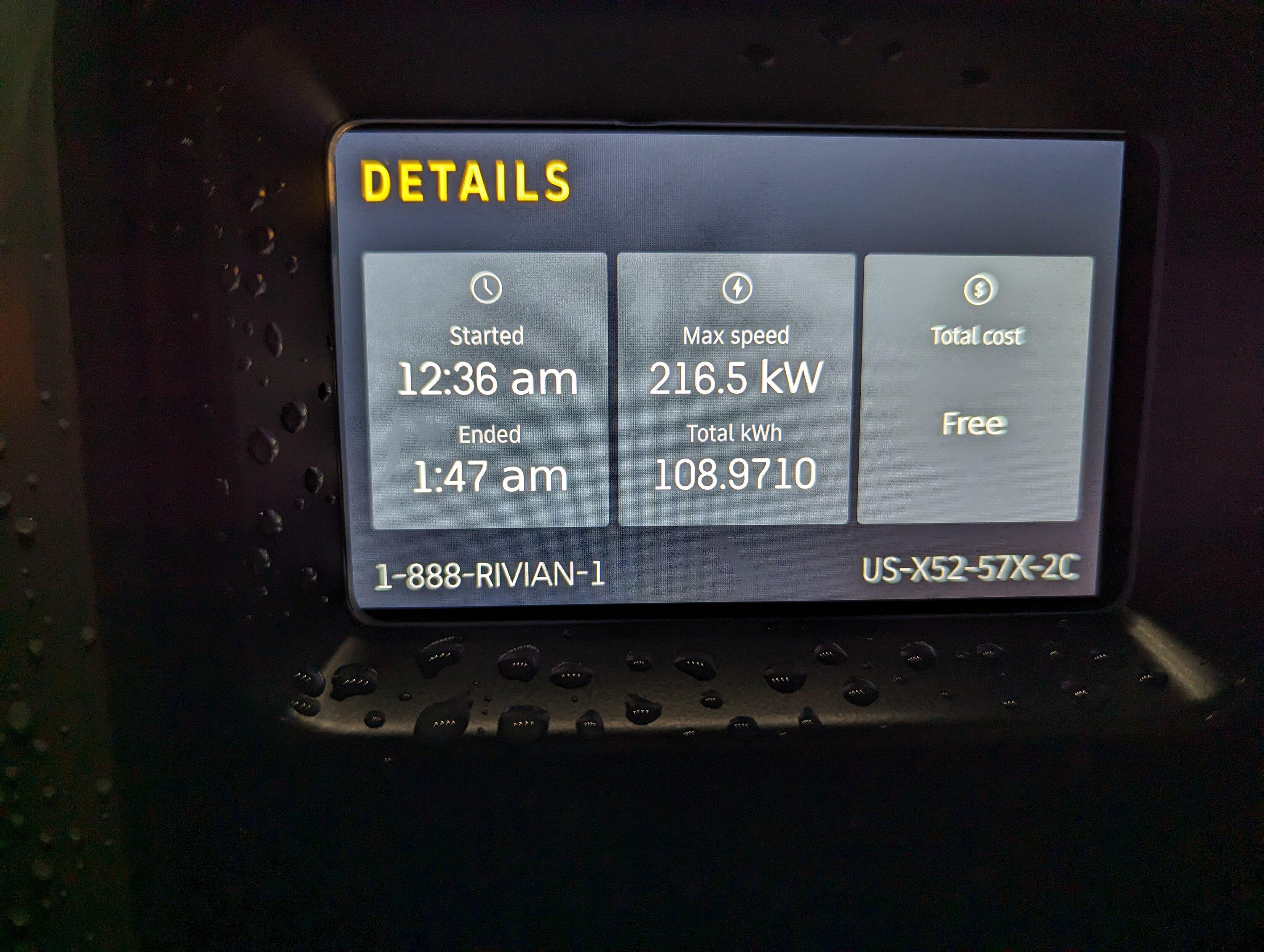

I saw the same on EA 350kw charger, it hit around 215 or 220 kwh for a minute or so, then taper off. If rivian's max is at 200kwh, is that means the number on EA station is inflated?
Theoretical max right now is around 220kW, but I typically see the vehicle start to taper around 215-216kW.
Rivian R1T R1S Rivian wouldn't charge at DCFC PXL_20230423_054746547
1:18 sounds about right for that other guy that charged up to 95%. Not 18 minutes, literally impossible even if his truck was maxed out the whole time. I think this charge ended up being to 93%. Normally I wouldn't stick around that long but I was napping.
