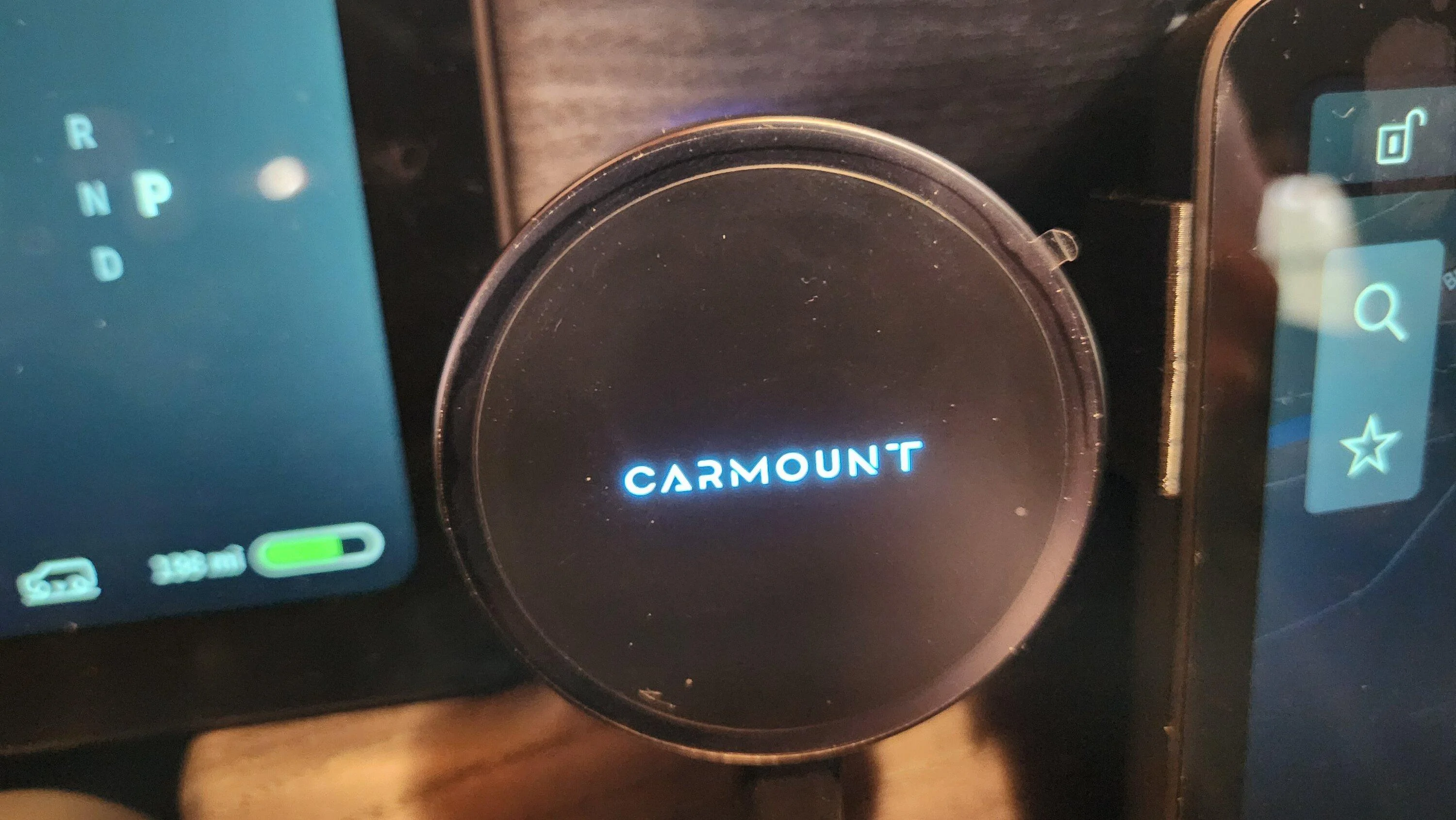

No. S22 user here. What I'm testing is from carmount.com. They sell a mag lock sticker that go on another phone. They also sell a mag lock wireless charger that I HOPE will lock onto the 17mm pro from Riviparts. Hopefully everything will be here within the week and I can confirm. Will keep you posted.

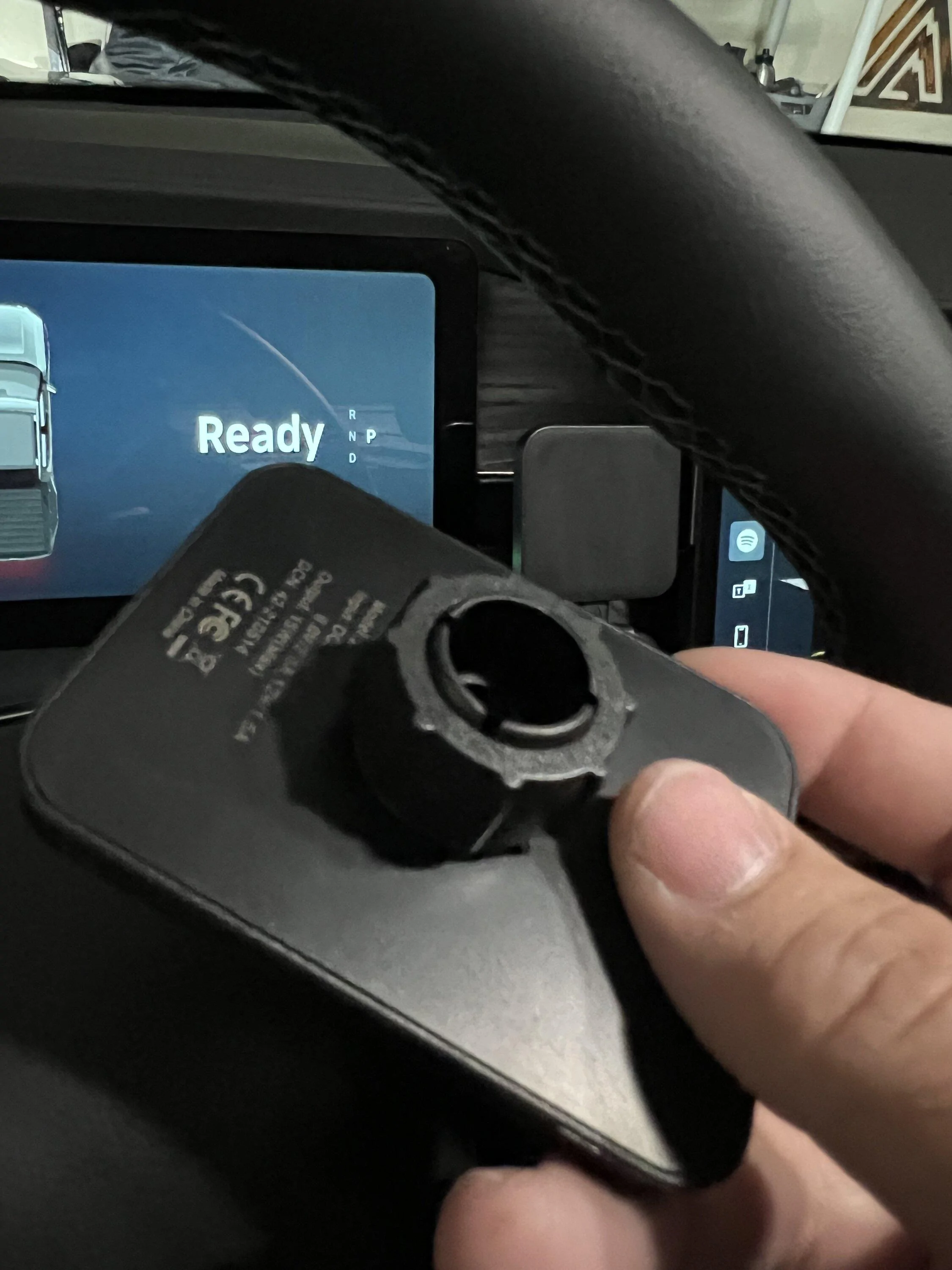

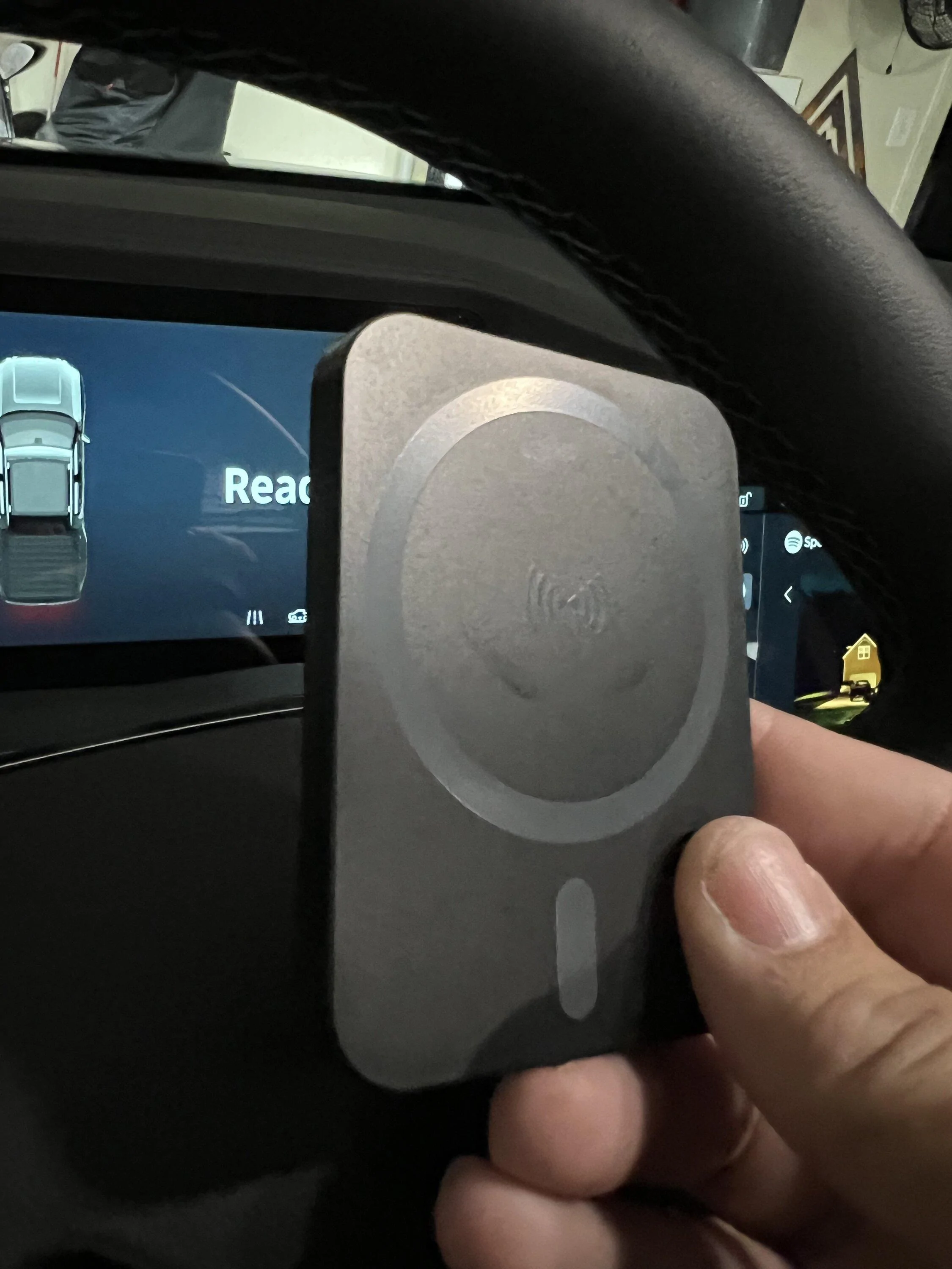

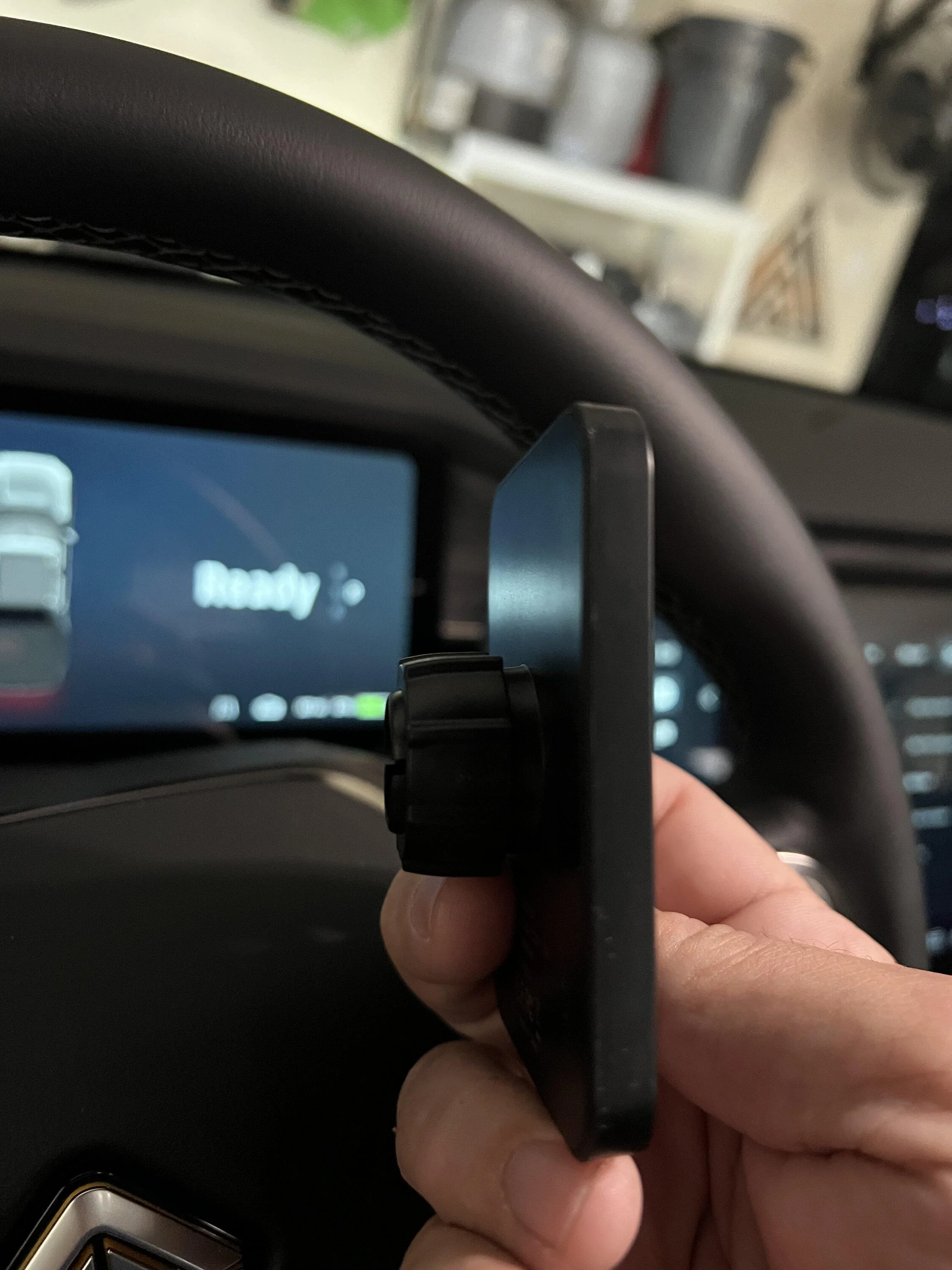

I've now tried 3 different phone chargers and 3 different Riviparts mounts (OCD FTW). I've cut up mounts and epoxied different things together to try and make the perfect iPhone mount for myself.
I currently have a Peak Design case on my iPhone 13 Pro so I started with a Peak Design car charging mount. I cut off the ball from my first Riviparts mount and used the 3M tape to mate them together. Turned out to be a bit wobbly and not to my liking with the position of the charger/phone.
Yadda yadda yadda, the Course Motorsports charger paired with the new Pro Riviparts 17mm ball mount works a treat: https://smile.amazon.com/dp/B0BFC3FFRD?psc=1&ref=ppx_yo2ov_dt_b_product_details
This Just Wireless charger from Target also works with the 17mm Riviparts ball mount: https://www.target.com/p/just-wirel...GCNnfpcJEqZNKl-fslRoCn-AQAvD_BwE&gclsrc=aw.ds
I really liked the Peak Design mount with its rubber face so that the phone can't shift at all so I cut up a few of mounts and used epoxy to put it together. So I'm now using the Riviparts Pro 17mm ball mount with this new Frankenstein mount I made up.
I hope this makes sense.... can take pics if it helps.

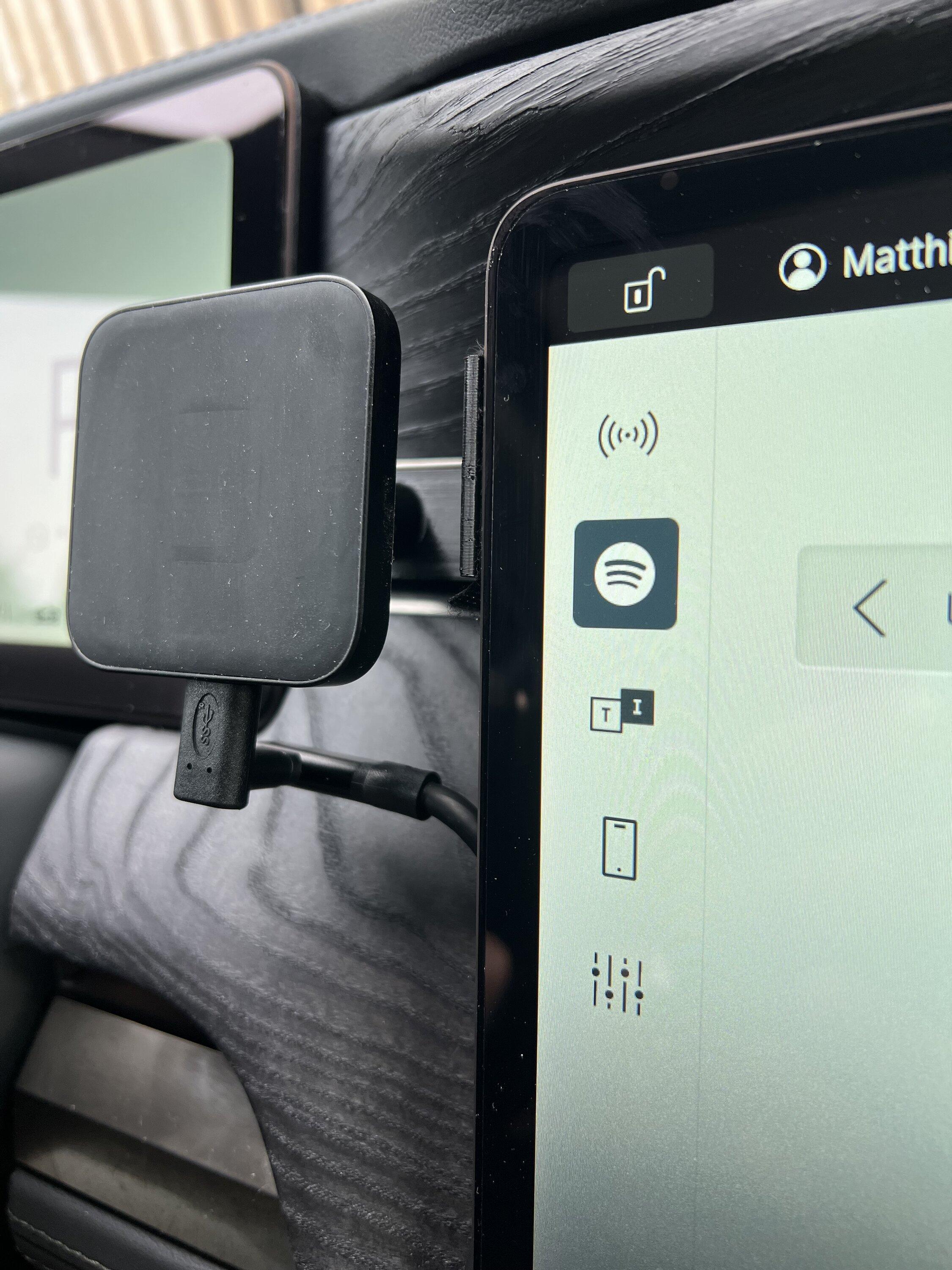

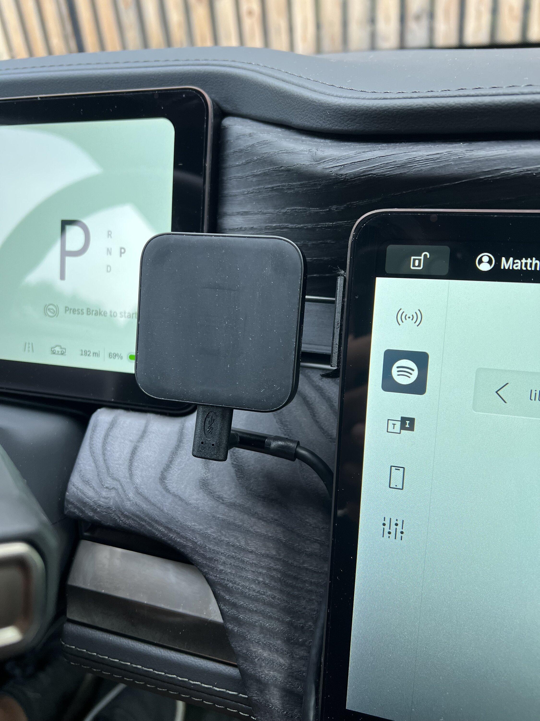

@RWerksman Here are a few pics. Showing my installed "customized" Peak Design charger as well as the other "Just Wireless" charger.
All in all, the 17mm ball mount with the chargers I mentioned positions the phone in a decent place and has zero movements.
I imagine some people might prefer the phone higher up using the 1" ball and a Ram arm but I personally didn't like the amount of wobble I got doing that.
The new Pro mount is really good. Definitely better than the original. I can't think of any improvements I'd make to it. Peak Design makes a very nice Magsafe charger, just wish they'd use a 17mm ball system so I didn't have to make one myself.
Now if only Rivian had provided a USB-C outlet just on the side of the center screen, we'd be In business...

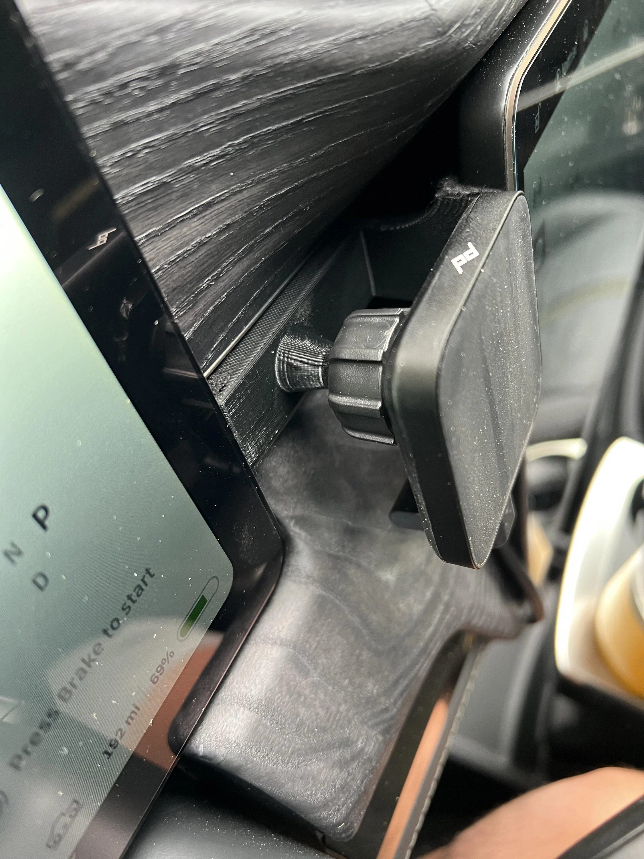

Quick shout out to @RWerksman. I ordered the 17mm Pro. Shipping was quick. The fit is perfect. It's super secure and looks great. The placement isn't ideal, kind of behind the wheel and drive stalk but I don't think there's a better location for it. I went with Carmount for the wireless charger as they also have magnetic stickers that go on the back of my Otterbox case so my Galaxy S22 snaps into the MagSafe charger. It works like a champ and I'm really happy with the whole setup.
Love this setup with the peak design mount. I just need to find a ball mount I could fix to the back of the peak design without buying another charger....

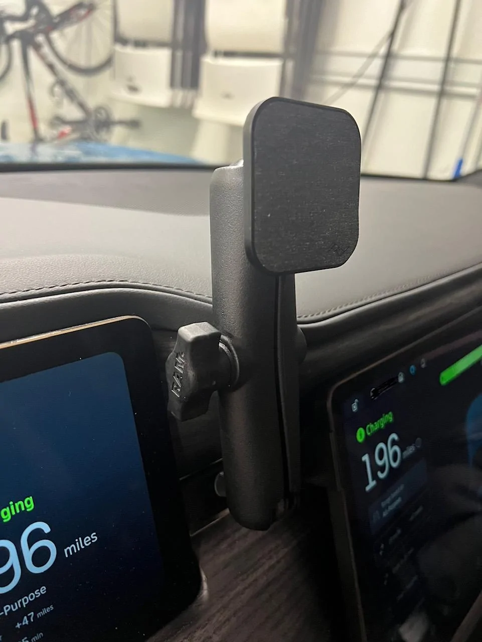

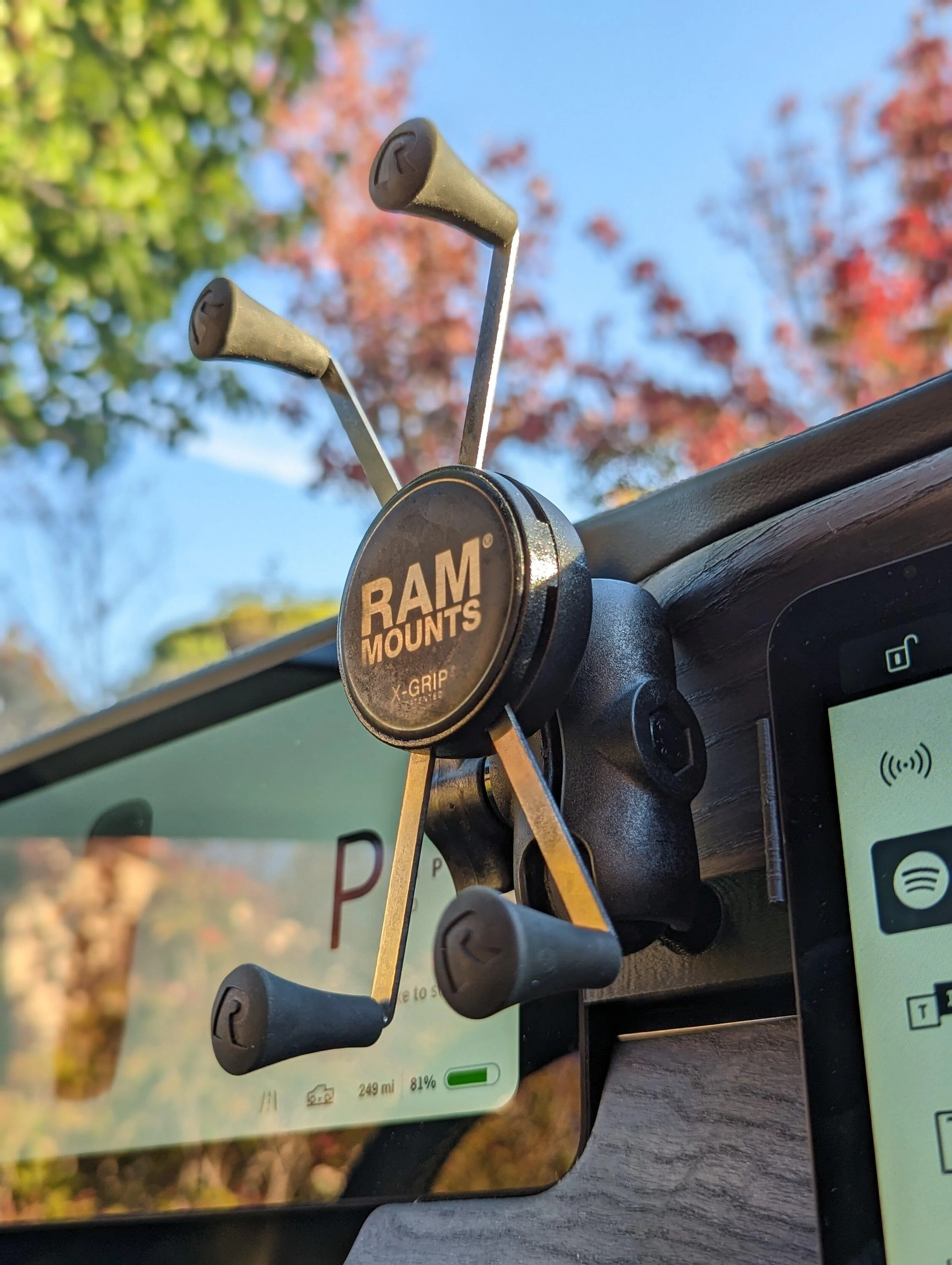

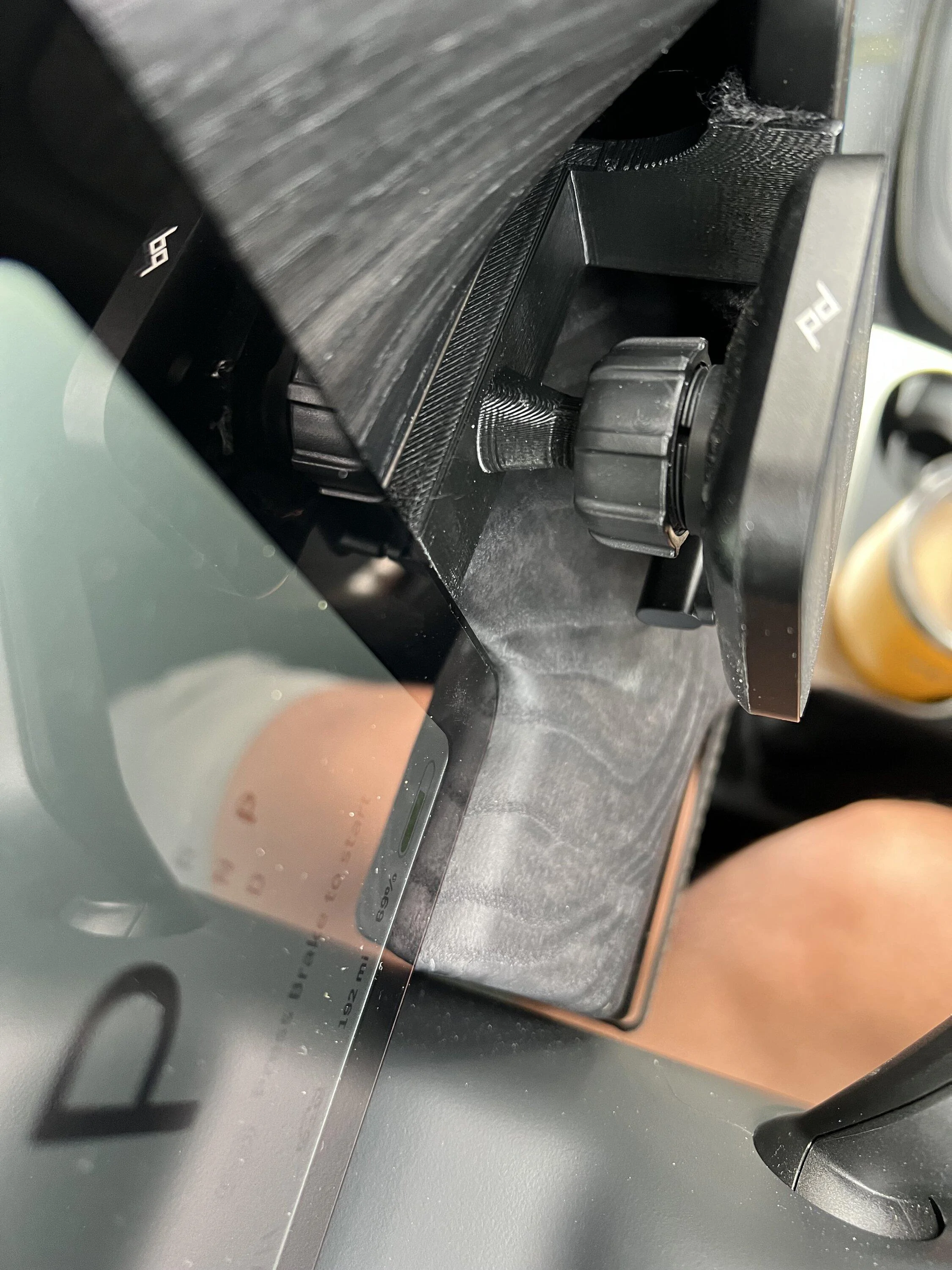

I'm an Android phone kind of person... Pixel 7 Pro to be exact. ? I had some leftover RAM Mount parts from a past project, so ordered the 1" ball mount from @RWerksman. The arm going from the Riviparts mount to the RAM mount is the short double socket arm. The short mount bumps the phone up about 1.75" above the Riviparts normal location and I can see the majority of the screen. I also have a medium double socket arm that would bump the phone up 3" over the normal location. I will try after this one if I feel I cannot see the phone well enough. The Riviparts mount is nicely made, but I am slightly worried about it wobbling up and down as it's not real tight and there is a lot of leverage on it with this mount. I will know more after I drive the truck tomorrow.

sorry, still not understanding what you put together onto the rivipart mount? I already have the peak design mount and case which are great. What am I missing and how did you put the two together? Thanks
I took the Peak Design charger mount and chopped off the ball mount on the back so I had a flat surface.
I cut up another charger and epoxied the equivalent of this on the back: https://www.amazon.com/i-Trek-Sticky-Mount-Garmin-Black/dp/B002T0EK64/ref=sr_1_15?keywords=17mm+ball+mount&qid=1668100031&sr=8-15&th=1
Keep this thread updated with your experiences as I have the same RAM setup and found the mount had more movement than I would have expected. I’m waiting for the MagSafe RAM piece to arrive for testing.

I went for a 60 mile drive today. The phone moves around too much for my liking with this mount. The placement is really nice with the extra height, but it just shakes the entire time you are driving unless the roads are buttery smooth. I think using the medium double ended RAM mount arm would make it even worse, so not going to try it. I am going to pass on trying to use the whole setup. I'll keep it for when my wife's R1S arrives. She uses one of those floppy vent mounts in her car today, so this setup will be huge step up for her.
I think it comes down to the tolerances in each vehicle, the original 1in ball mount would almost fall out of the mounting location if i had the long arm on it.
But the "Pro" version is tight enough for my truck to support a Ram 1in Long Arm mount (6") with very little movement while driving around.

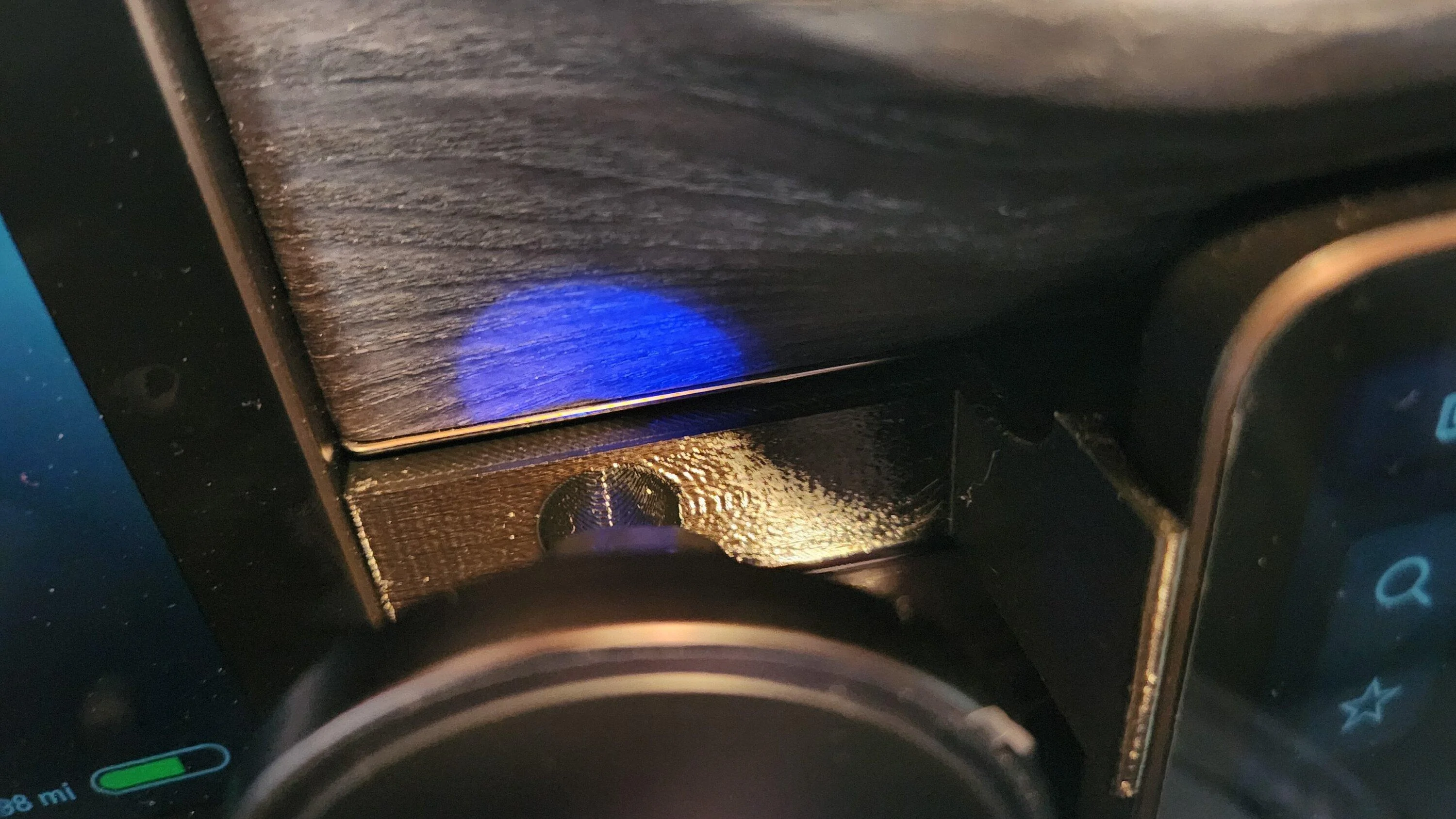

One thing to note is how snug it is before putting anything on it. Or shouldn't be floppy at all. There are a handful of folks who seem to have the infotainment screen mounted further out than 99% of the R1T and R1S population. I have a special part for those folks.
If it's not right, phase contact me using the form on riviparts (not here) with your order number. I'll get one of them to you at no charge.
