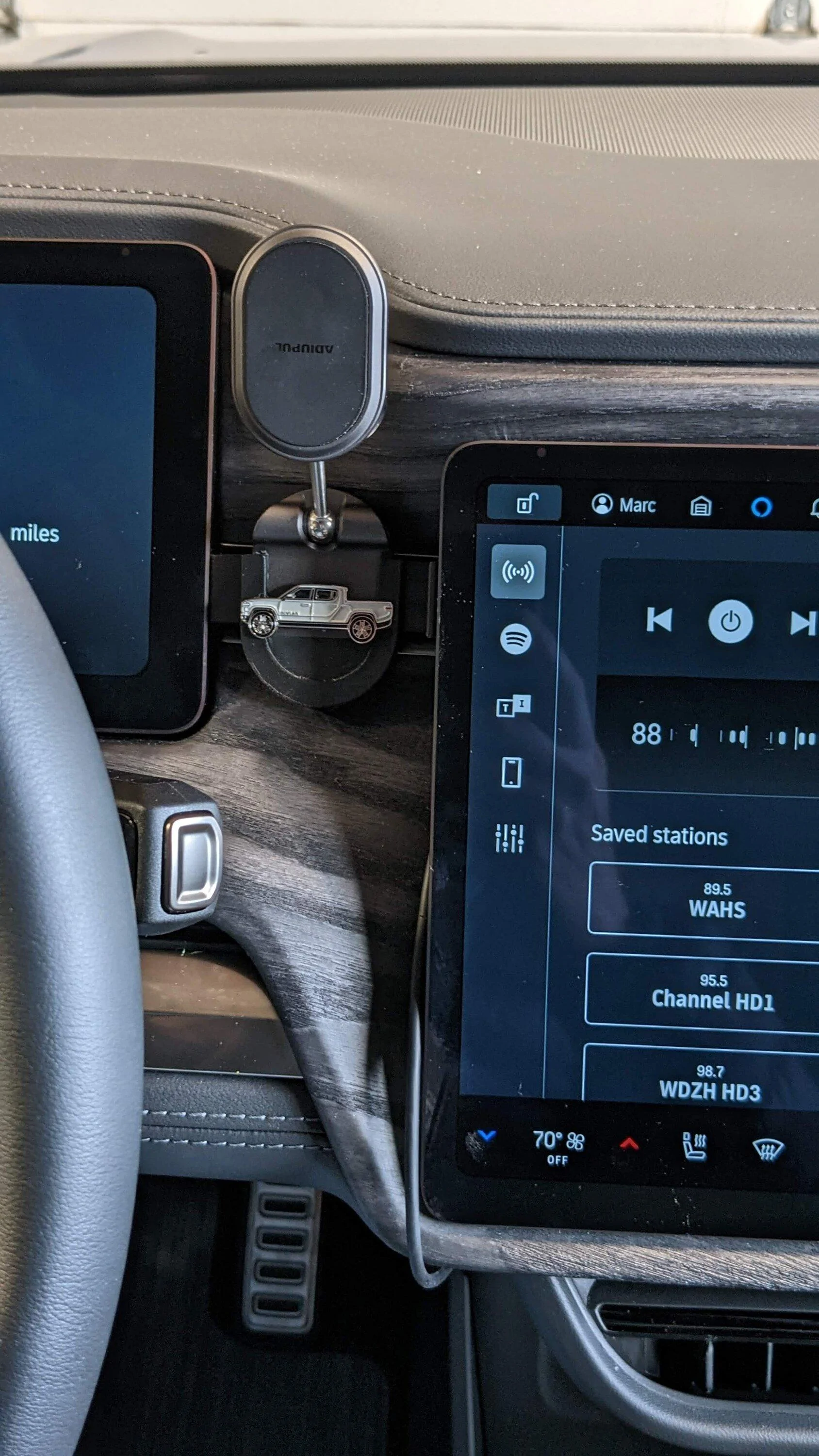

Great set up here, man. Have you done any rough driving with the phone mounted, yet? I worry that magsafe can't hold up to off-roading.
The Peak Design case with the Peak Design charger is a great combo. I haven’t had a chance to go off-roading yet with the new truck but certainly did with my Tacoma Pro and never had issues at high offroad speed or rock crawling.
If you’re worried you could look at the perfect squeeze from Hondo Garage. They have a wireless charging option. Beyond solid off road. What it was build for.

Hey there - that mount used a 17MM ball, not the 1" version. The only brand that uses the 1" ball are the RAM mounts.
Oh, now I feel like a dumb dumb. I ordered the wrong version, my bad.

I think it comes down to the tolerances in each vehicle, the original 1in ball mount would almost fall out of the mounting location if i had the long arm on it.
But the "Pro" version is tight enough for my truck to support a Ram 1in Long Arm mount (6") with very little movement while driving around.
Have anymore picture of the back of this mount or how it looks with the phone in place? Trying to figure out how to make it work with my peak design charger

i didn't use the charger, i used the wall mount only so it was flat already and i glued it to a flat plate w/ 1in ball mount

Let me know if anyone is interested in the 3D model re-design I did.
Rivian R1T R1S RIVIPARTS Cell Phone Ball Mount PRO 1 Inch Model PXL_20221120_140150511
