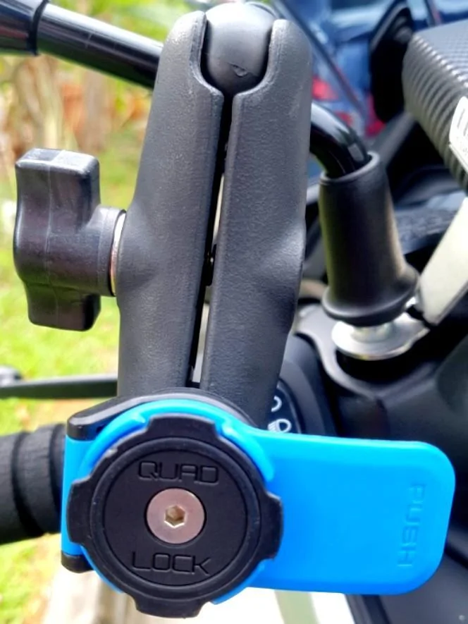

Will this work with RAM mounts that use a clamp type mechanism or will that crush the plastic ball?

Can you link me toward what you're referencing? If you're referring to something like the below, you'll be fine. The ball does well with crush forces, but I urge you to please be mindful as to what can reasonably be hung off a friction fit mount.
If you have questions about a specific application, feel free to DM me.
Rivian R1T R1S RIVIPARTS Cell Phone Ball Mount PRO 1 Inch Model _ball_mirror_mount_1596028392_cf61f6b0_progressiv

Yep, that's it. Just a phone and phone mount. I already have the RAM system from previous vehicles and that looks like a good fit. Just concerned that the RAM system uses a rubber coated metal ball. The slick plastic with the powder coated metal clamp may be slippery?

What I've found is the striation lines from 3D printing combined with the small amount of geometry that I built into the ball makes it more grippy than what you would expect.
Depending on how you install the arm off of the ball will also play into this as well. Most people I've seen try to get the phone higher to clear the obscurity from the steering wheel. In that case, the majority of the weight of the phone and mount is pressing down on the top of the ball (or close to it) which works well.
