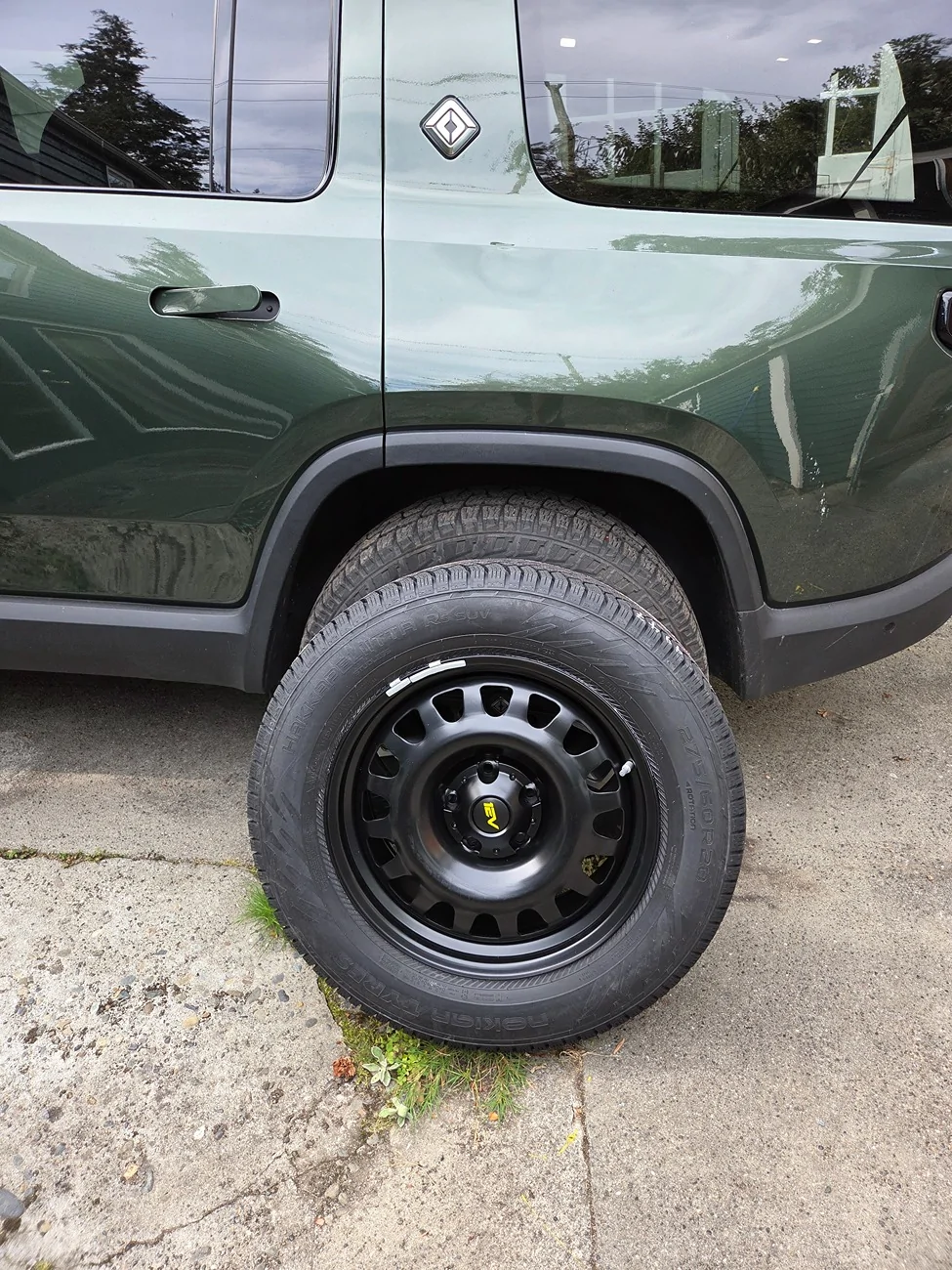

I find that my R1S is relatively terrible in the snow, compared to my previous Audi and BMWs with winter tires. I was attributing that to the tires- I have the 20" All-Terrain tires that came with the R1S, and have put off getting actual winter tires since we’re in yet another minimal snow winter here in Minnesota (unfortunately!!).
Do others think the slipperiness in the snow is mostly due to regen brakes or the tires? Now that I think about it, the car seems to slip more when I’m slowing down versus driving at a steady speed or speeding up, which would argue that it’s more of a regen brake issue than a tire issue. I’m sure winter tires would help regardless.
100% tires. I'm on my second season with Blizzak LT and in snow mode I have yet to see the regen lockup the wheels even in high regen, though I haven't experienced ice yet. It's a 7000 lbs truck and the nannies will only get you so far...tires will always be the most important thing.
Snow mode is about useless, as I dont notice a difference in-between the All-Purpose mode, and snow, no matter the regen setting.
I am hoping to burn out these craptastic 22" Pirelli's this year, and switch over to Michelin or Continental.
As above, tires make all the difference. It's a 7000 lbs truck and tires are the only defense against physics. I've been running Blizzak LT and they've been great. I have noticed a difference in the behavior of regen between all-purpose and snow modes, with snow mode preventing lockup even on high regen much better than AP. If you've had a traditional 4x4 (not AWD) in the past, you have inertia in the driveline that actively prevents lockup at any one wheel before hitting the brakes which is part of the reason why downshifting made a big difference in control. The Rivian Quad motor system is almost the opposite of that since none of the wheels are connected and each motor is totally independent, so it's inherently easier to get lockup. The problem comes in when all four lock and the vehicle is still moving (sliding)...at that point you'll never get ABS because no wheels are turning.
