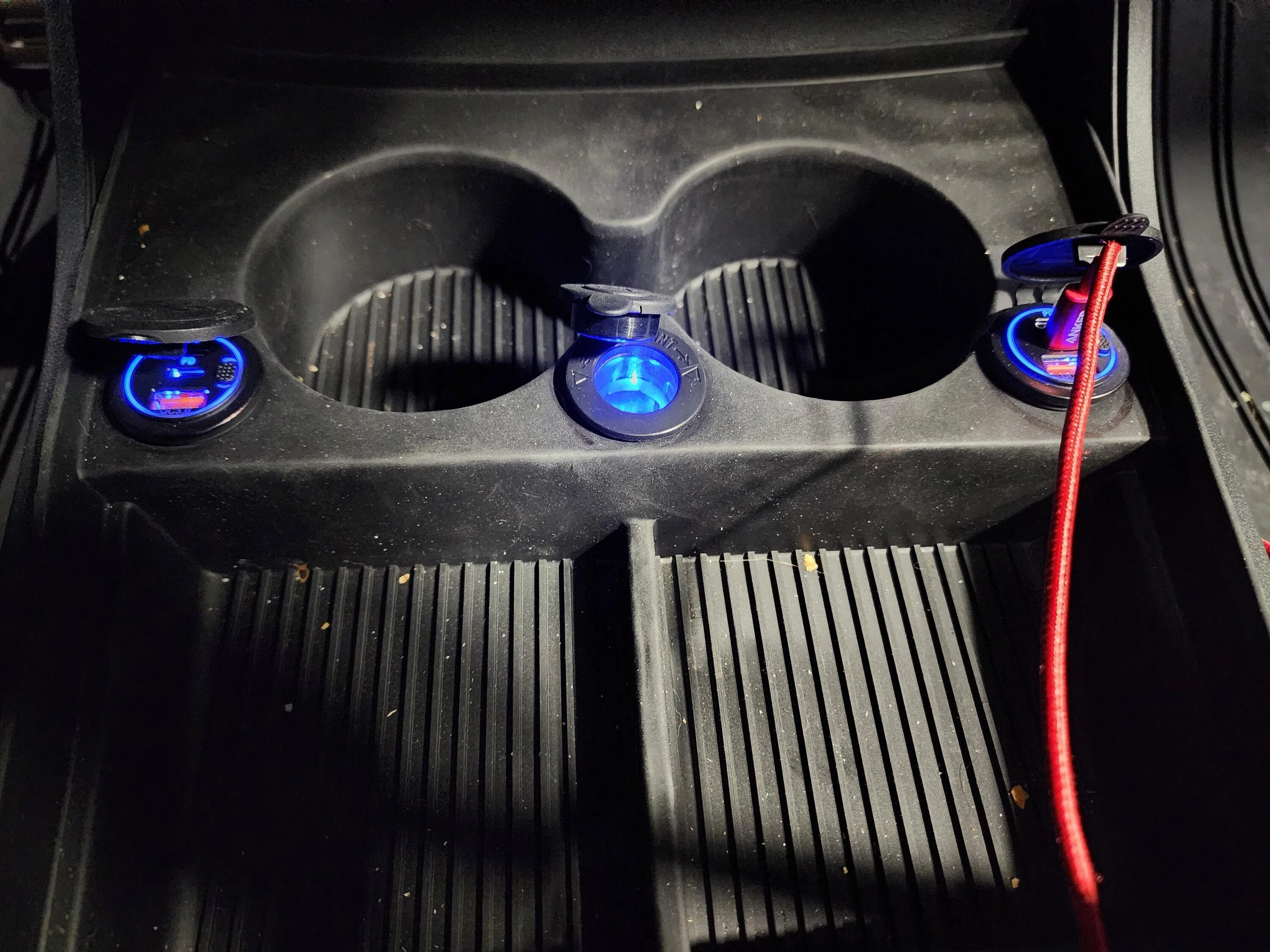

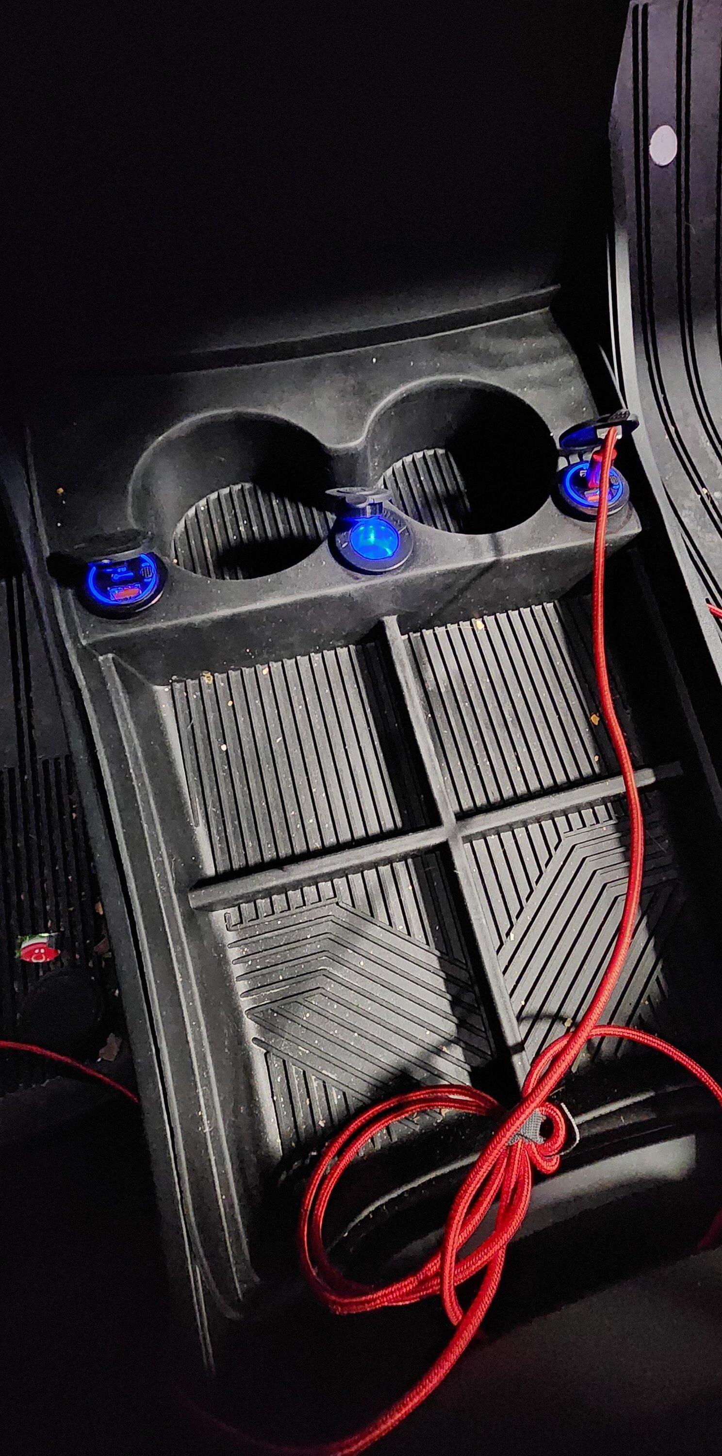

I did something similar in our R1S using fuse taps. I was going to use a surface mount like the OP, but realized that I could drill holes in the console organizer I bought from Amazon.
Console Organizer
USB Plugs
12V Outlet
Really cool idea. How stable are the outlets? Do they move around at all when you plug stuff in?
vandy1981
Jul 25, 2023
756
1,526
The material on the divider is soft so I cut up a thin plastic cutting board and glued it to the backside to stiffin it up.
