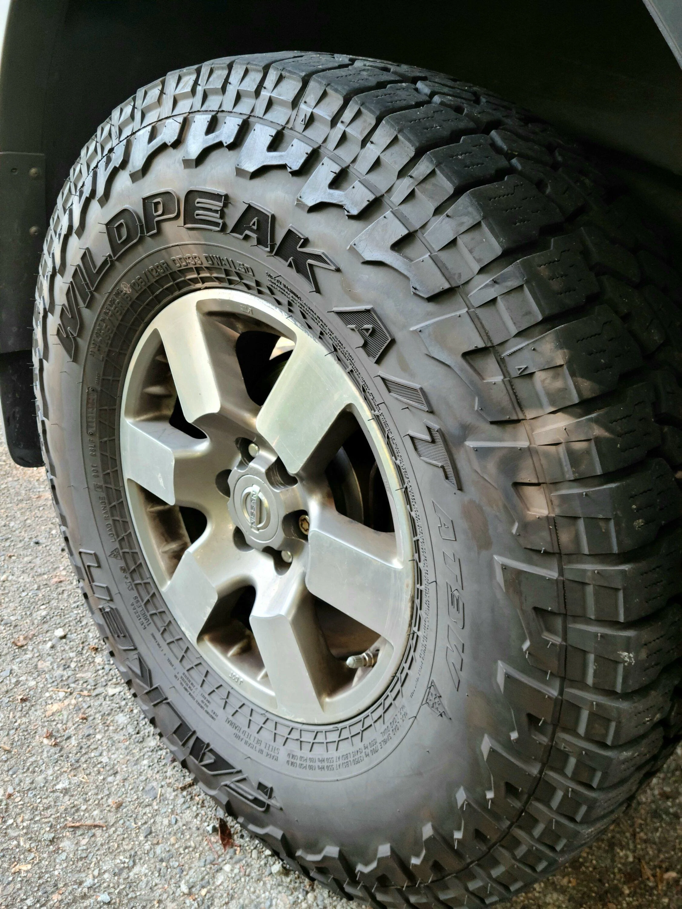

I drove my Nissan Xterra to work the other week (wife wanted the Rivian for some odd reason) and it was raining for several days.
First day, I get to an intersection on a decent incline and come to a stop. As the light went green, I started to accelerate, and the ABS kept skipping trying to send power between the rear wheels, back end slipping a few inches one direction, then a few inches the other direction as it tries to sort traction. It took about 100 ft for it to finally gain enough forward momentum to stop breaking traction in the rear and get beyond 20 kph.
Next day, same intersection, same conditions. This time I decided to put it into 4H and see how it reacted. sure the vehicle was more bogged down by driving all 4 wheels, but it was a similar result, front wheels grappling to control slippage, rear wheels doing the same. It was able to get up to speed faster in this instance, but was still ABS chattering away, wheels breaking traction, finding it, then losing it, then finding it.
The Xterra has Flaken Whildpeak AT3's and no, I wasn't gunning it from a standing start, even if I had it's throttle by wire, so limits engine output when slipping is detected. VDC obviously engaged both times.

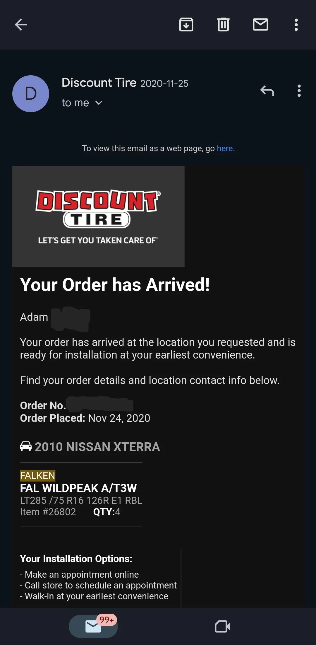

How old are the Falkens? I had them on my 4Runner for 6 years and only around 40k miles since it wasn't a daily driver. By the time I replaced them they still had plenty of tread depth, but they'd turned into hockey pucks. It was actually on just wet roads at any temperature I decided they needed to go because they just had no traction in the wet. Brand new AT3Ws had plenty of wet grip, as evidenced by replacing like for like.
Now, tire age aside, you can floor the Rivian off the line on a wet road and it'll just go straight as an arrow and barely slip a tire in the process. It's truly impressive. But as R.I.P. has mentioned, the R1 doesn't really have a big problem when the mu (coefficient of friction) is more or less identical on all 4 corners (or even 3) and at least 3 tires are in contact with the ground (could just consider this as similar mu since a wheel flying as a mu of zero).
100% this. While there are major deficiencies in the QM calibration for rock crawling, TFL just tried to drive it over the obstacle as if it were an ICE vehicle with a torque converter. In the ICE, differentials aside, you build up inertia in the drivetrain through the torque converter, which the R1 obviously doesn't have...again leading to motor stall at low speeds. Maintain momentum and the R1 generally figures things out. Demand a lot of torque quickly rather than slowly feeding in throttle and it can get moving...but then it's not well-controlled and could risk bad things happening in a precarious situation.
3 years, around 15-20,000 km's
