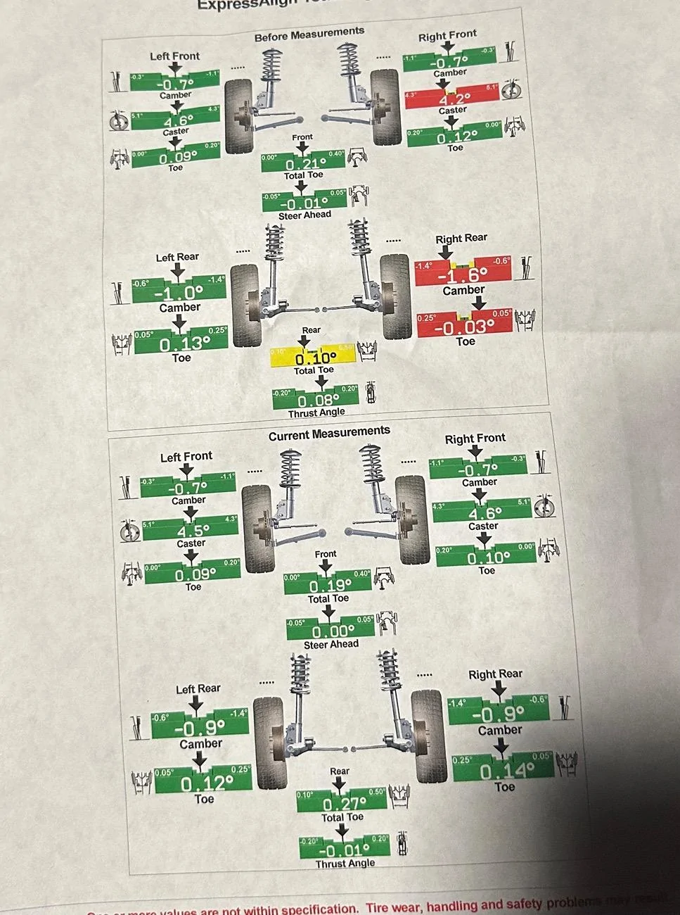

Got truck back from service today
Did alignment, balance, and rotation.
Steering wheel still shaking at 67-70+ apparently it’s “within spec” and this is a known thing which is kind of insane for a $80k+ vehicle.
Sharp Sporty steering + wheel oscillating at high speeds is uncontrollable.
I guess I will pay out of pocket for the new Michelins in a couple thousand miles and see what happens.
Rivian R1T R1S Steering Wheel Shake at Highway Speeds IMG_8717
