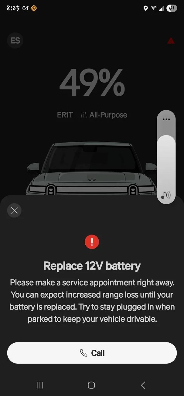

PSA:
If you're calling in to report blinking lights, IMMEDIATELY mention that it's draining battery and gets dangerously warm (if that's the case, of course) and that you don't want to be liable for the 12v battery(ies) replacement cotst
4 1/2 days from first symptom until battery replacement needed, even while plugged in to maintain state of charge. Then when calling service, I was hung up on twice before reaching someone. This is No Bueno! At least this qualifies for a emergency appointment…we’ll see
Any details on your 12V? One or two 12V? Age of the battery?
Mine was replaced fairly recently (6mo or so).

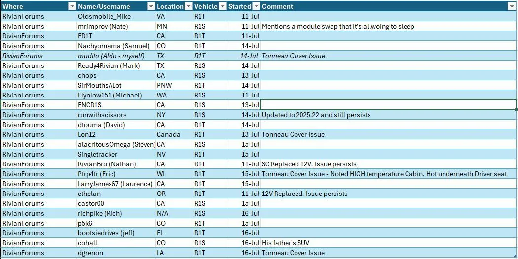

Allright, I did a quick sweep on this thread and made a list...
Am I wrong to see that all vehicles affected are GEN1 vehicles? Is anybody's a Gen2?
Rivian R1T R1S Tail lights keep blinking 1752683064967-69
25 individuals affected (so far) in this forum, I'll sweep Facebook in a little bit (I made a post over there to gather names/locations)
Nicely organized. Slap me in the "12V Replaced. Issue persists" category, as well.
Small note - mine started earlier than 7/16. It was at the airport and I noticed it was losing range quickly several days ago.
