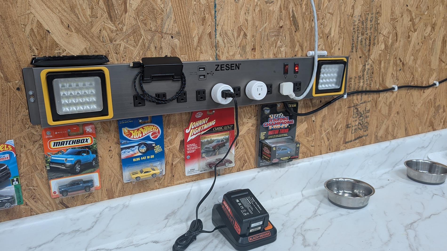

In the meantime: tailgate closed and key fob battery replaced (even though the fob is easily >50' away from the truck), as per previous suggestions. Still blinking away:
Wild speculation:
What's changed? The only thing I can think of that I have changed recently in the vicinity of the truck is to add these timers (the white 'pucks' in this picture, to control when my tools charge):
These timers have Bluetooth, and WiFi 2.4GHz & 5GHz. Could they be sending a signal that the truck interprets as... something? Will have to remove them. But the other comment from someone else also having this issue probably blows that guess out the window...

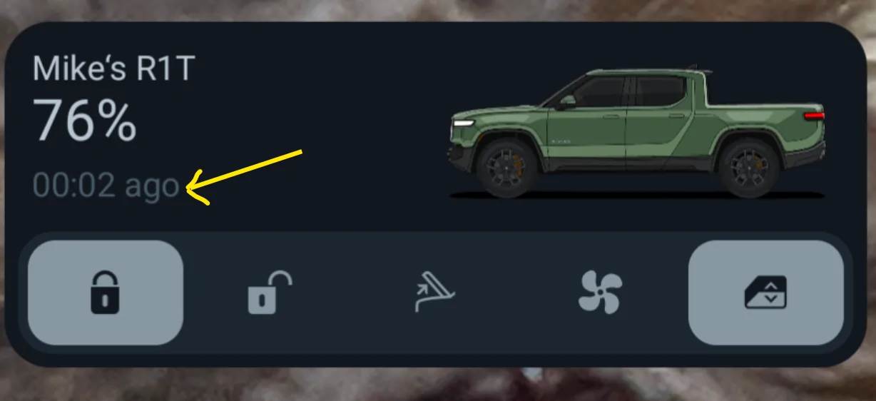

Hey, so dumb question, but how are you guys determining the truck is never going to sleep? I think I let my ElectriFi subscription, or whatever it is, lapse a while ago. 😉
However I did notice this on the widget: The timer on the Android app counts from 00:00, then it gets to about 00:04, then it resets again back to 00:00. That doesn't seem right, does it? Like it keeps pinging and waking itself back up...
I run UniFi access points at home and the controller software gives pretty good visibility into when clients are connecting/disconnecting from WiFi. Previously, when the R1S was sleeping properly, I saw that it would connect to and drop off from the wireless many time per day. This corresponded with when I would see a sleep icon in the phone app. With this new blinking tail light behavior, the vehicle connects to WiFi and doesn't disconnect unless you drive the car away (or exactly 12 hours after a hard restart like I mentioned earlier). The app does not show a sleep icon when the tail lights remain blinking.
I don't think the phone widget timestamp corresponds to sleep. I think it's just the amount of time that has passed since the widget was updated. I could be wrong, though.
