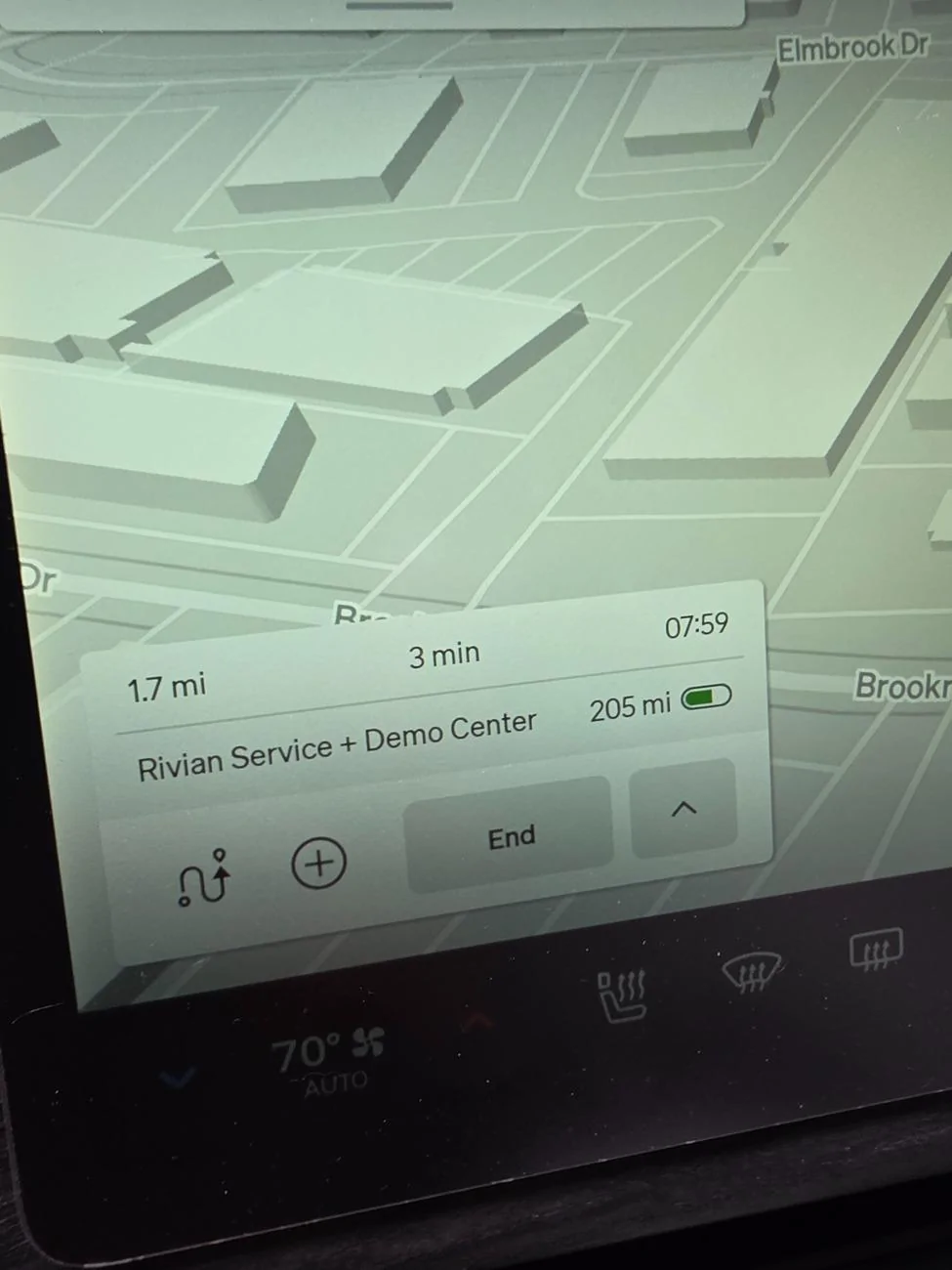

Service just reached out and they changed something on the back end to fix the issue for me. The vehicle is now sleeping as expected. I hope they can fix everyone else affected just as easily!
Which service center was it? I''m at Dallas, TX and just checked in my truck, wanted to provide the info to them here as they will attempt a remote diagnose with corporate later on today.
mrimprov
Nate
Oct 25, 2022
Minneapolis, MN
Etsy
Minneapolis.
