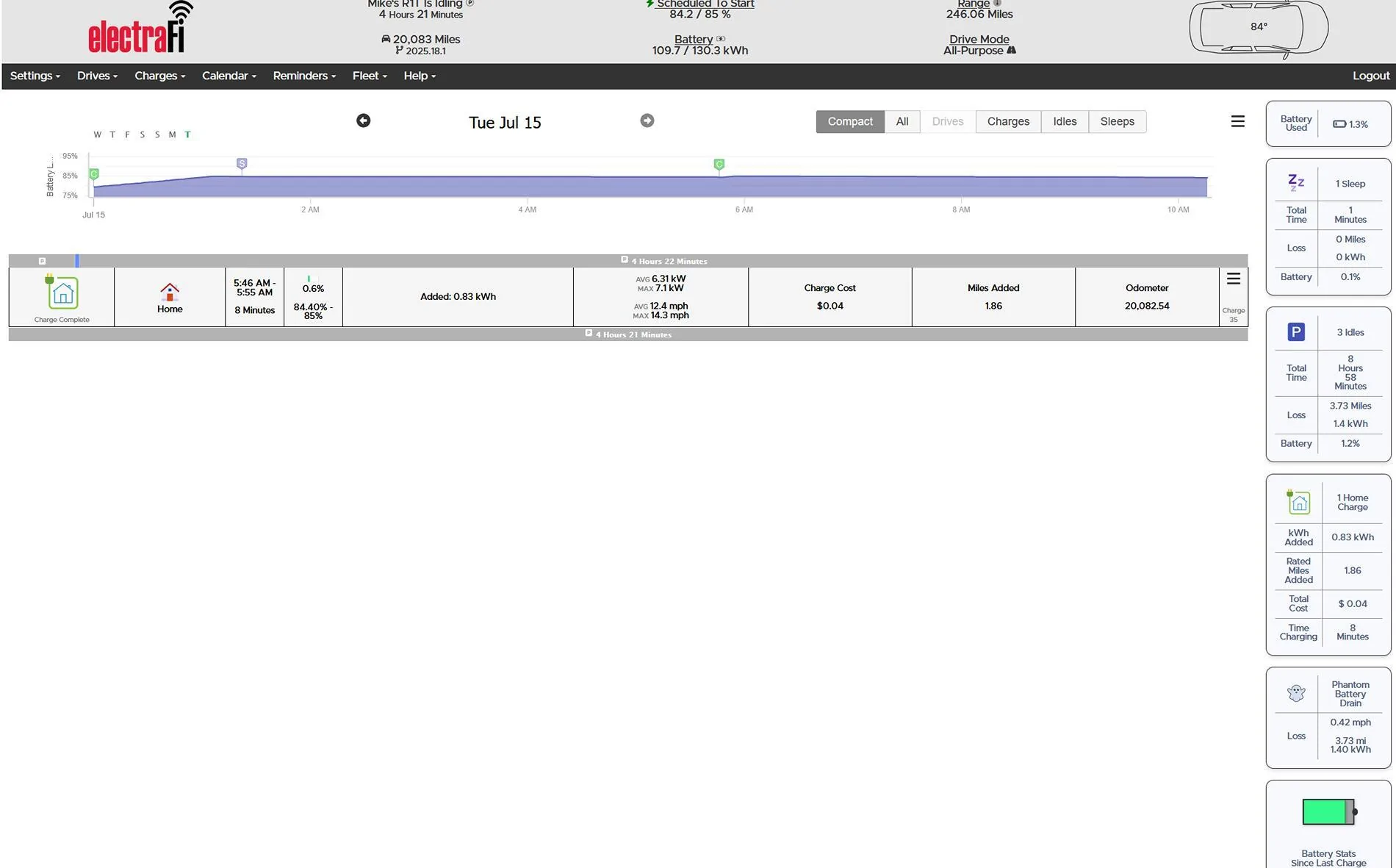

Thanks all. Nada here, yet. But this did encourage me to renew my ElectriFi subscription. 😉
If I'm reading this right, it looks like mine just 'idled' all night long, and only slept for 1 minute. And wasted 3.73 miles worth of range / 1.40kWh during that time.

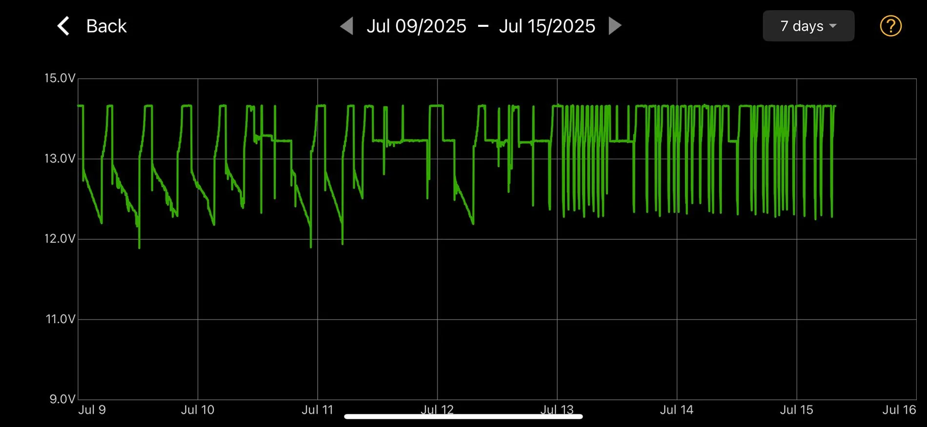

My R1T started not sleeping on the 13th. Also flashing tail lights.

I knew this was going to be the "side-effect" of this issue, hence why I rushed into service center. This idling puts unnecessart strain into the 12V (hence my recommendation to leave the truck plugged into an L2)

I doubt that's the case. I had the 12V failure last year, replaced under warranty, and I've been Anal about 12V upkeep (see here) and one of the tell-tell signs is the sleep/wake cycle getting shorter and shorter. In my case, my truck was sleeping like a baby until this issue popped up (14-16hrs of sleep easy, before a "charge wakeup")
