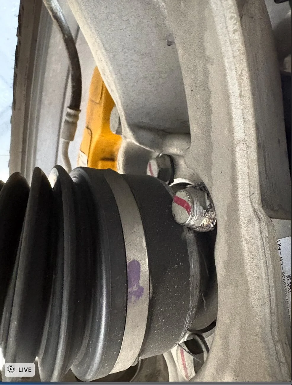

OMG, somehow I am a test subject. 1 mile from the grand canyon, I had massive hub bolt failure. I read about it here, and willpost a sepearte thread, but left front hub bolt backedout and started rubbing against half shaft casing. Crazy sound, called service, did tests, took videos, etc. Drive another mile and it stopped. Logistics from the south rim are a bit of a nightmare.
Can anyone comment from experience / knowledge that only one specific bolt comes lose or do they all come out? Should I have an expectation that all of them are trying to back out? Or those who had this there was one specific bolt not tightened or something?

So the above issue is an ongoing issue that is known about.
Good news: People have looked after its been posted in the past and found one bolt completely missing and suffered no consequences, the truck still drove fine for who knows how long without it. Although not recommended, people have driven with one missing for who knows how long.
Bad news: There's no way to know if it's just one or all of them, but at least you know where to look and inspect. Now that one has come out, if you HAVE to drive it, I'd inspect them ALL every time you drive/stop, on both sides. This means you got the bad batch that weren't torqued correctly from the supplier.
Worse news: This is going to take a service center visit, and a few weeks for them to fix, as they replace all of them as part of the service/recall bulletin.
Edit: If you want to retorque/check/tighten the rest of them in the short term to make sure none of the others come out, the torque spec is 105Nm for each of the bolts as per this document. The one that's out is likely unfixable due to the head being destroyed, but the rest should be accessible.

I am fairly mechanical but it doesn’t look like you can access the bolts to reforge without taking the half shaft out.
can anyone confirm . I don’t mind buying a socket for it somewhere. I have a proper torque wrench with me as I always check the lugs on long trips from habit. Left over from my track days habits
my other cars would need the axle removed to fit a socket on there. But I did not read the posts yet. I’m still in travel mode on the phone
thanks for any comments

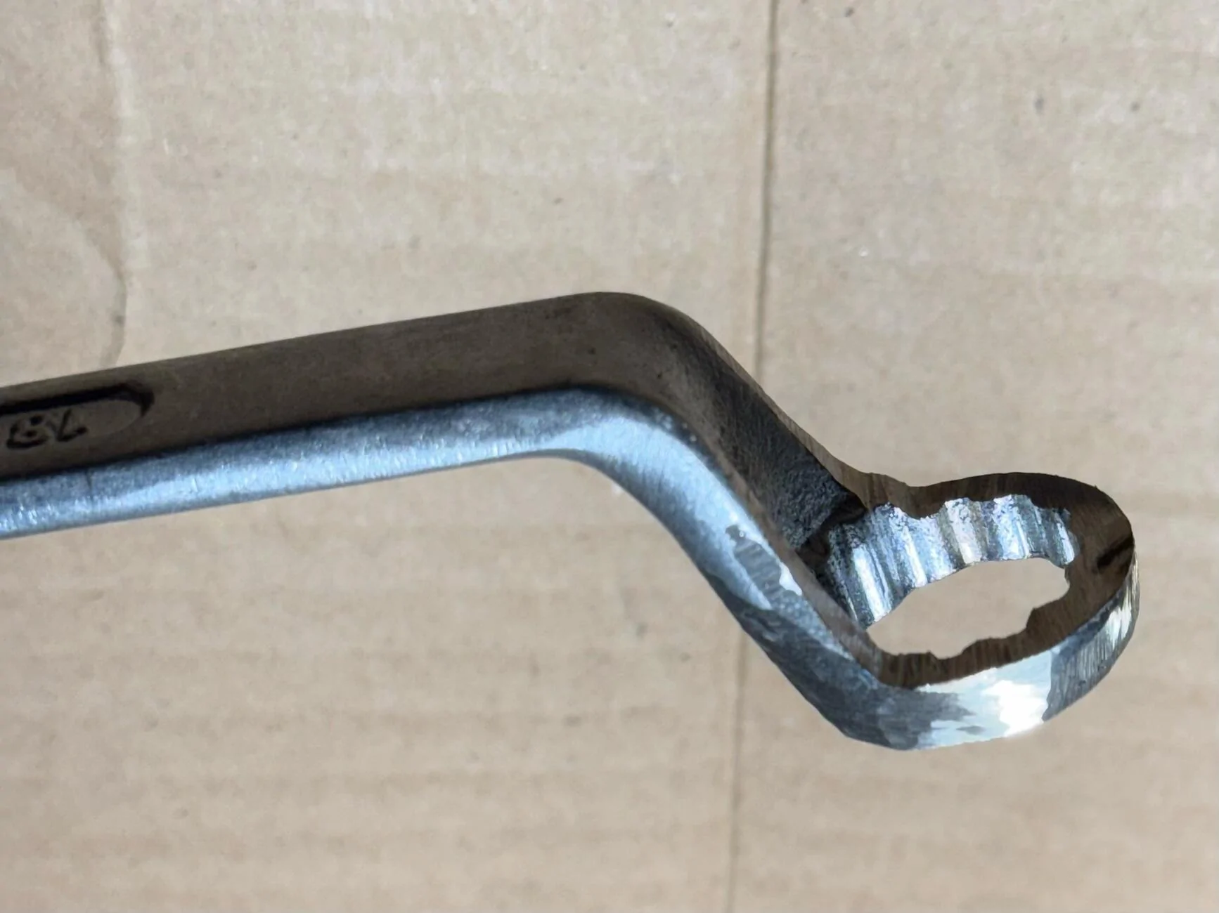

The previous reply included a link to how someone ground the begesus out of a wrench to fit in the hub without removing the half-shafts.
Rivian R1T R1S Tesla adapter first time question 1732651552667-1q
I’m all for making one-off tools like this. I have my good blind rivet puller and then I purchased a CHEAP one and ground away 40% of the nose on the tool to make it fit into close quarters. I have to be careful with it not falling apart on me because so much structure was removed, but it’s required at times. You can see the guts inside the tool, but it still works.
You are correct. Official procedure has the half shaft bolt removed, and the half shaft pushed back to create clearance to access the hub bolts.
Once the hub bolts are tightened to spec (105Nm), then the half shaft is slid back in, and the half-shaft bolt REPLACED. it is not reusable.
The half shaft bolt is a M10-1.5x50 Class 10.9 Hex Flange Bolt
But their description mentions some sort of special lock washer? Not sure. Can't tell what it is without taking it out, and if you take it out, you need a new one.
The half shaft bolt also needs to be torqued in a specific manner:
When installing the halfshaft bolt:​
i. Use a new bolt.​
ii. Torque the bolt to 80 Nm.​
iii. Loosen the bolt 1 turn.​
iv. Torque the bolt to 128 Nm​

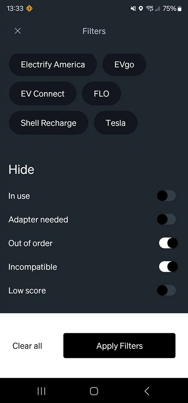

Yes, this. use the Rivian app and in car navigation interfaces. Learn how to properly filter the compatible locations, and if you have an adapter, make sure to select that option.
Here's a screenshot from the app, under the trip planning area. You can select specific charging networks, the speed and these options.
Longer trips with any EV involves better trip planning.
