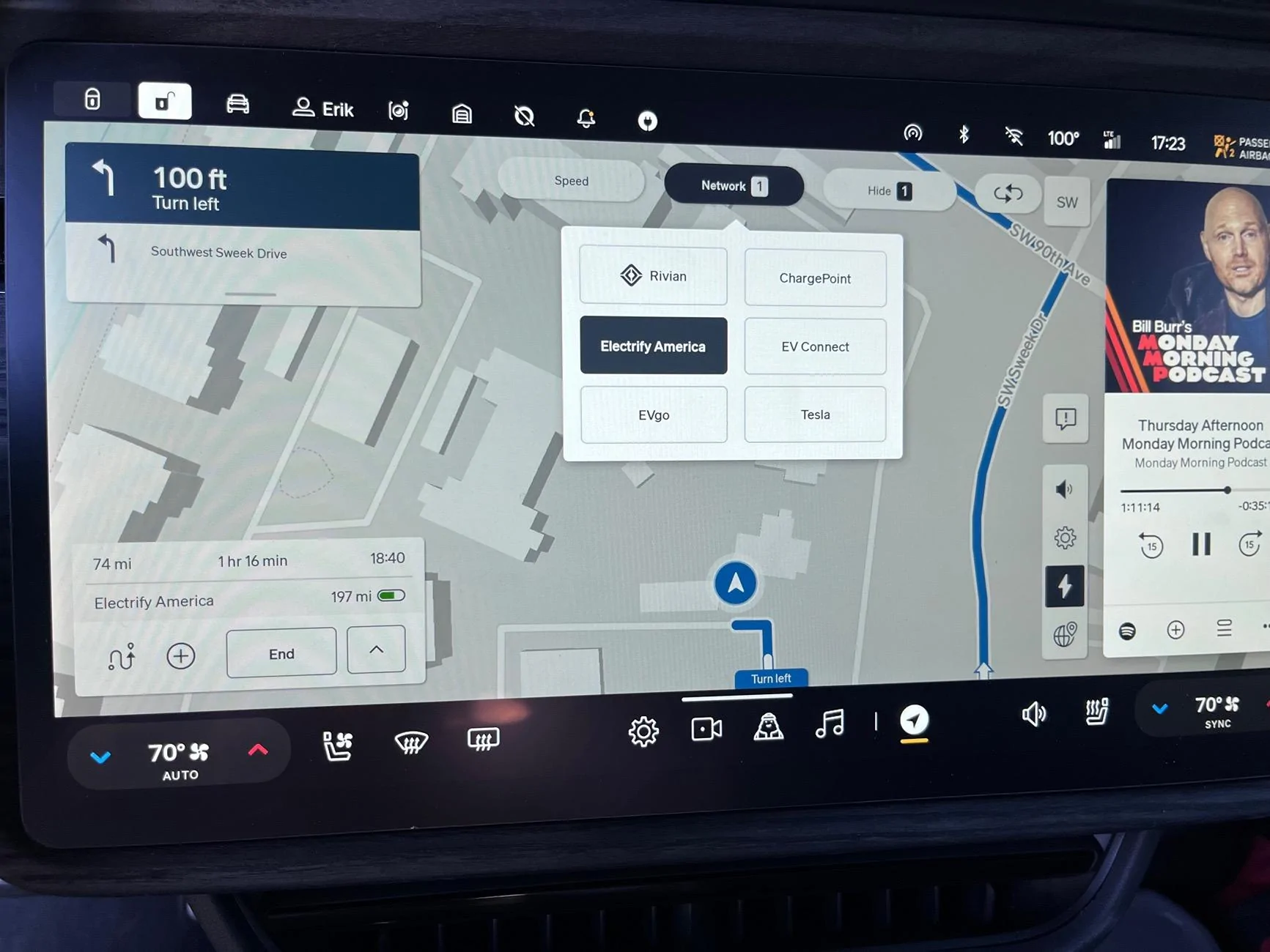

Slightly off topic but I’m driving from Oregon to Massachusetts right now and no matter what I do with the network filter; the truck wants to go to EA stations. Whether I select EA (which I assume means the truck will search only EA), select Tesla only, or select everything but EA it sends me almost exclusively to EA stations. Handpicking Tesla SCs is a PITA.

I think there is a bug with this right now. Same deal with Tesla and Rivian at times - it basically ignores it. If you plot via phone it's better somehow.

Okay I was wondering if that was the case. Thanks for confirming!

Filters in the nav only affect what you see in the nav maps, not what it navigates to. Filters in the app affect what it navigates to.
