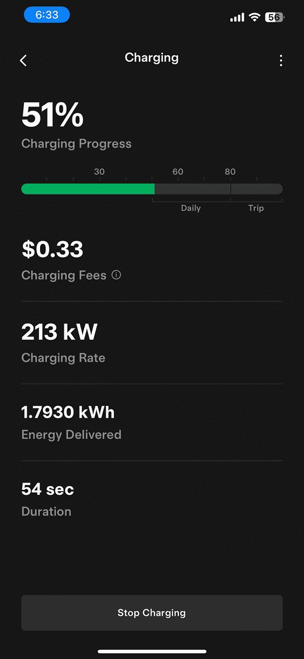

I just tried a supercharger near me after signing up for the Tesla membership this AM to make sure all would go smoothly ahead of a long road trip over the next 2 weeks. Tesla said it delivered 16kw at $0.39/kw, $6.24 total. My Rivian app said it gained 13kw... Not sure which is correct. If Rivian is accurate, I am paying more than the advertised benefits of $0.39/kw.. more like $0.48/kw.

It's normal to see some loss between the charger and your car. You're paying for electrical losses in the cabling as well. That being said, 3 kw seems a bit high for such a short charge.

To be clear, the kWh are rounded to the nearest kWh. For that reason alone, the actual difference could be as little as 2 kWh. But the Rivian is only reporting the amount the battery gained. Therefore the consumption by the climate control, battery thermal conditioning, charging losses, stereo, etc. is not reported by the Rivian.
Basically, there is probably not a conspiracy by Tesla to charge you for more electricity than your Rivian actually used!

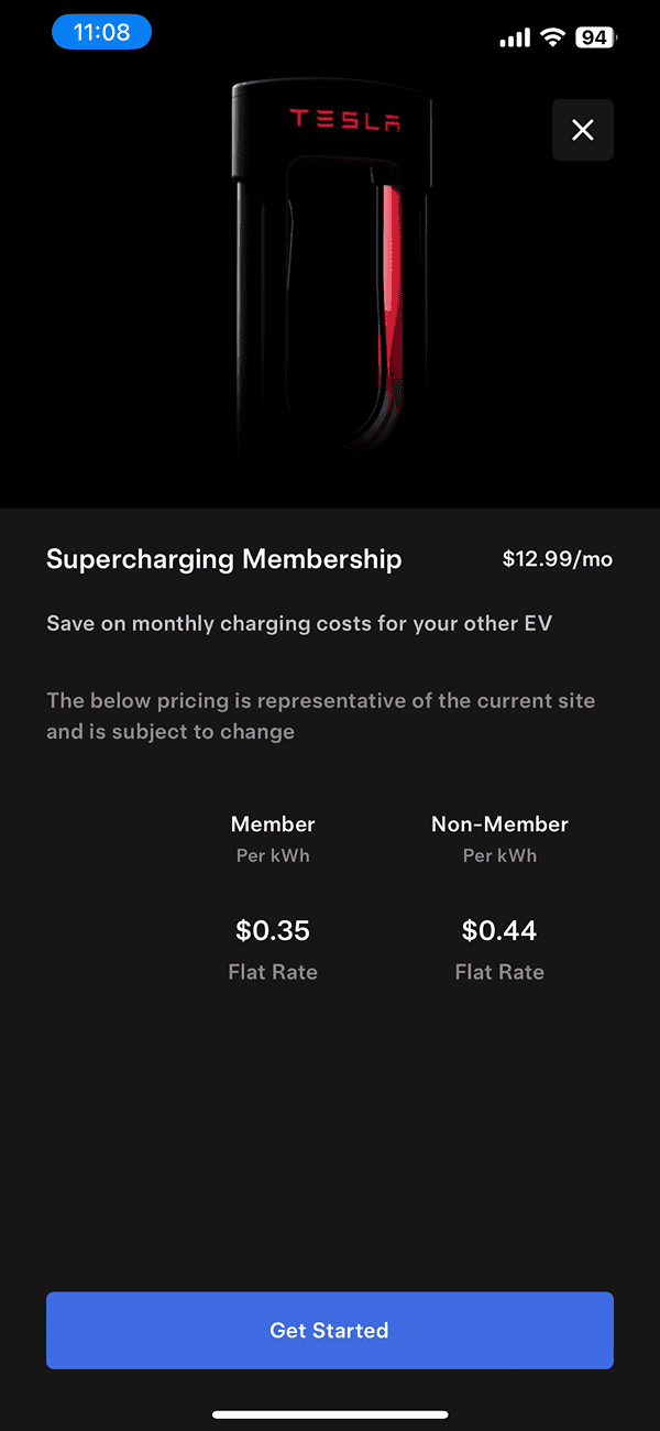

I usually sign up for the membership rates when I go on a road trip and plan to use the Tesla supercharger network at least twice.
You need to make sure you initiate the charge using the Tesla app then connect your adapter and then connect the adapter/handle to your vehicle to take advantage of the membership rates.
When you use plug and charge, it will default to the standard rates.

Anyone using or will be using the Tesla charging membership ($12.99/mo)?
Think it's worth it?
Along the same vein, anyone use the EA Pass+? Worth it?
It’s individual math, literally…to determine whether it’s worthwhile depending on driving routes, planned trips etcS
For me; it would only have to be about 2-3 significant fast charges per month to break even…:but that said, I’ve charged away from home less than 10x in 2.5 years
