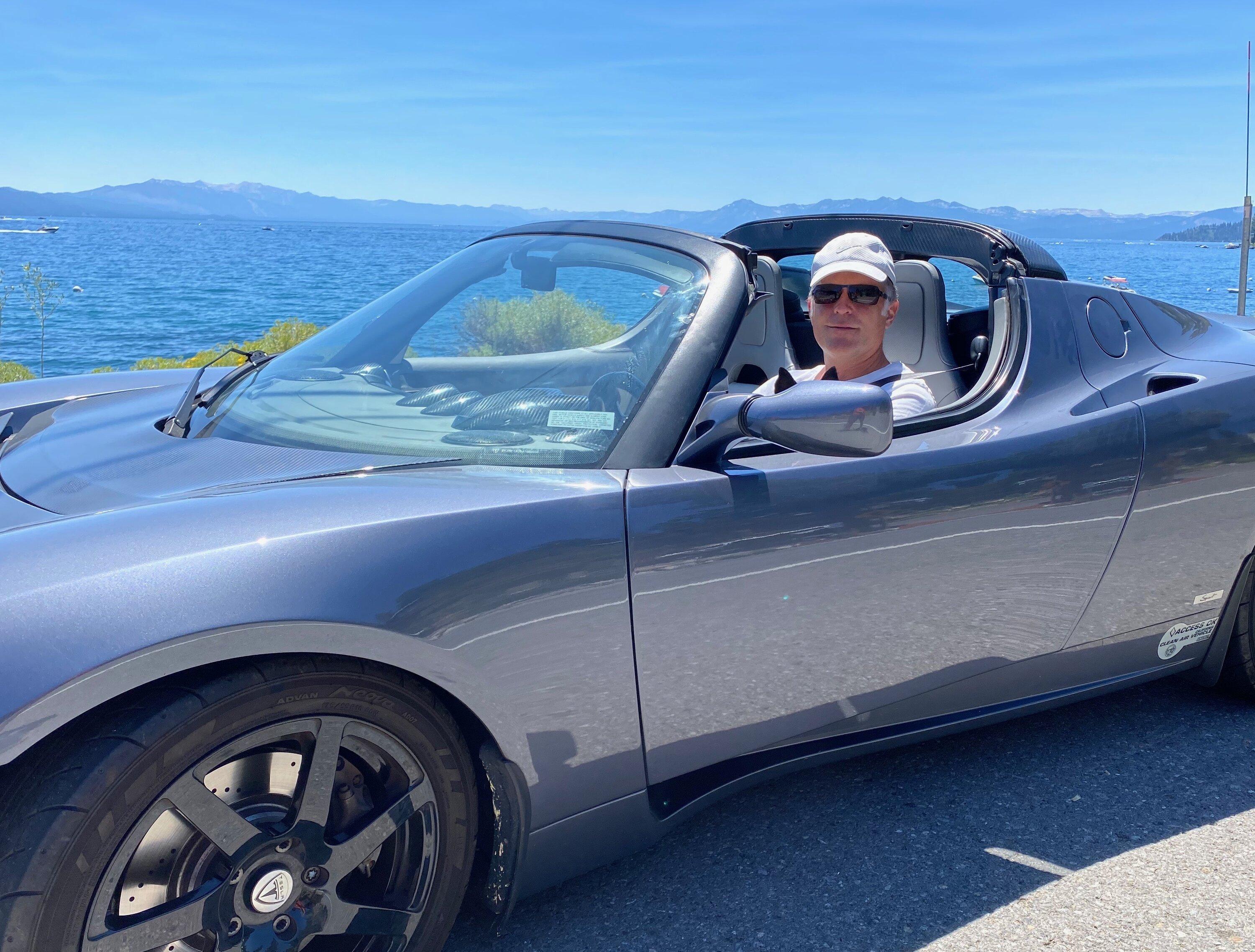

Can't speak for a Rivian Battery in 10-12 years however, I can speak for the 2010 Tesla Roadster Sport in our driveway...
When new, the Roadster had about 230ish miles of range and today when charged to 80%, it has a range of about 120 miles. Still plenty of distance for every day driving, errands, and even several day trips up in Tahoe when we had it up there a couple summers ago (see attached pic). The cost to replace the battery today is close to $30k. These batteries typically come with a new 80kWh battery (original is 56kWh), new PEM (brains) and an increased range to ~400 miles -- a significant upgrade over the stock battery.
Again, I can't speak for how and what the situation will be like in 10-12 years with a Rivian, but that's the experience in our household.
How many miles on the battery?

About 40k. The roadsters don’t get as much mileage.
