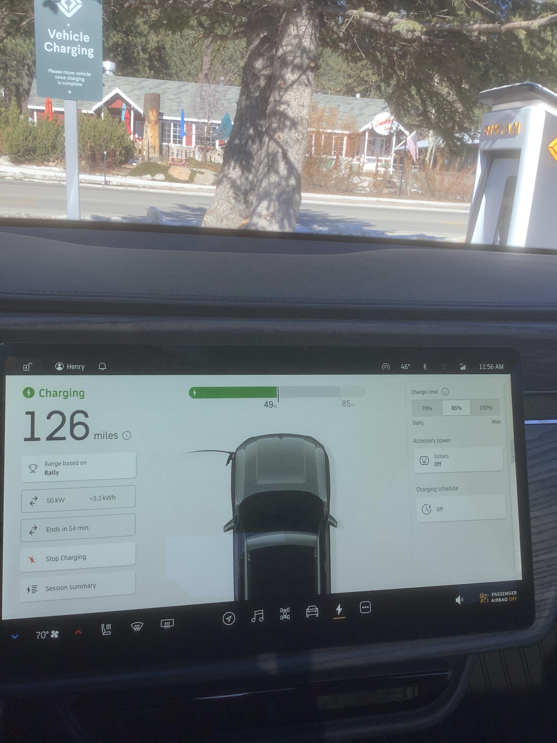

50 KW max at the chargers that are grouped together.
The charger for the trailers is putting out 188kw.
Nobody else charging.

My understanding is that each cabinet can deliver 200KW, and that power is shared between 2 stalls

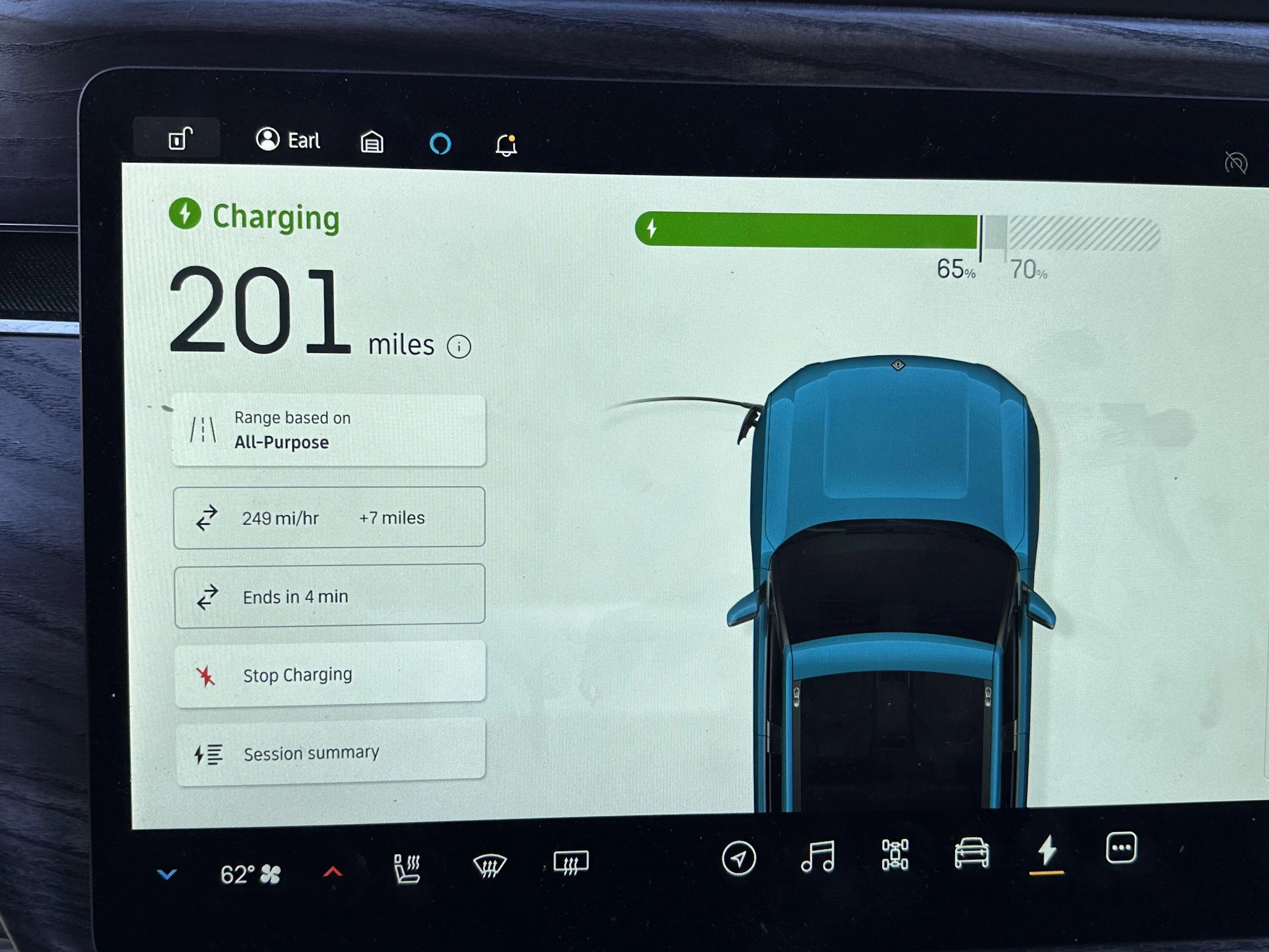

I used the chargers Sunday and speed was fine. I got over 200kw and it acted normally. The 2nd charger from left was unavailable. That might of been the one doing 50. I used the very first charger.
One charger was lit in red last night. So probably malfunctioning
Got the same result (48kW) last Saturday. No one else charging. Took an hour to go from 31% to 70%. During that time three more R1Ts came and charged at 150 to 200kW. Perhaps it's that one stall. Going back on Saturday for the Truckee meet-up. Will try a different stall.
