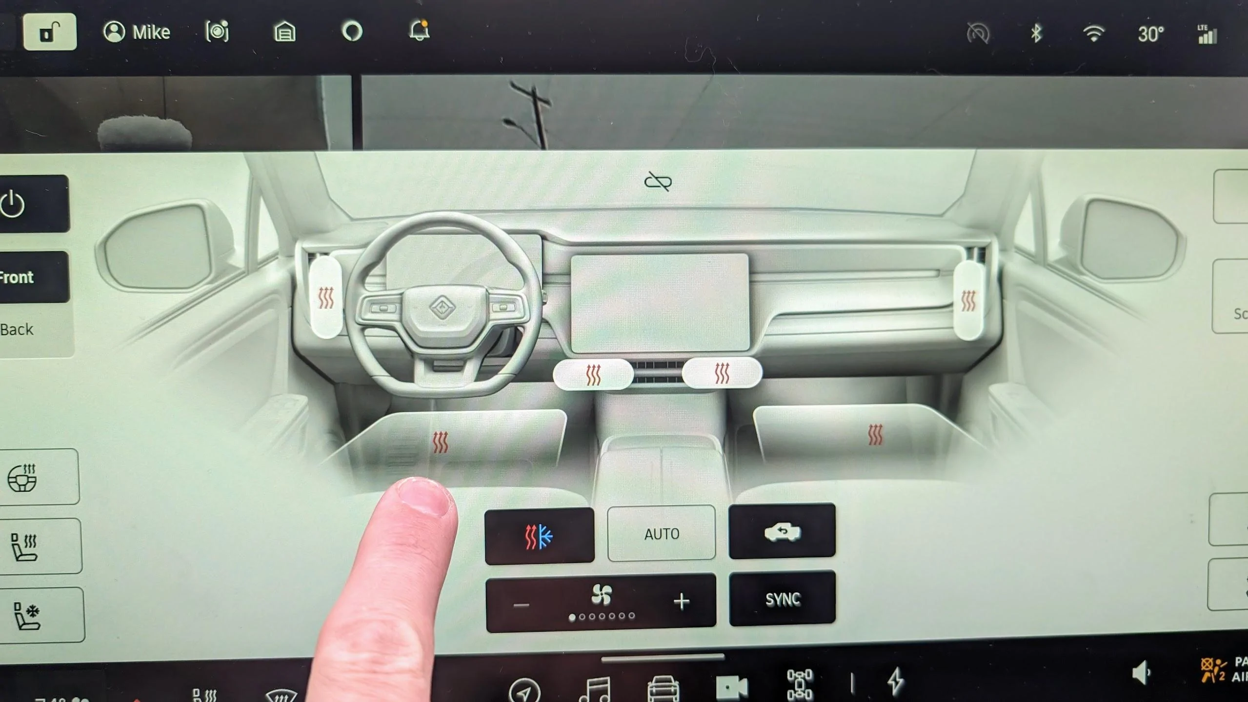

ark205
Jan 19, 2023
CT
23 R1S, 24 i5 M60, 23 MY, 05 F430
I am experiencing the same thing. Especially on long drives the heat will give out. My SC was no help nor have updates been helpful.
TIP: turn the defroster on hi (red icon, not the blue) to get the truck to produce heat. You can monitor the temp in the car from the Rivian app, even while moving.
My thread on the same issue:
https://www.rivianforums.com/forum/...not-kick-on-car-does-not-pre-heat-well.22641/
