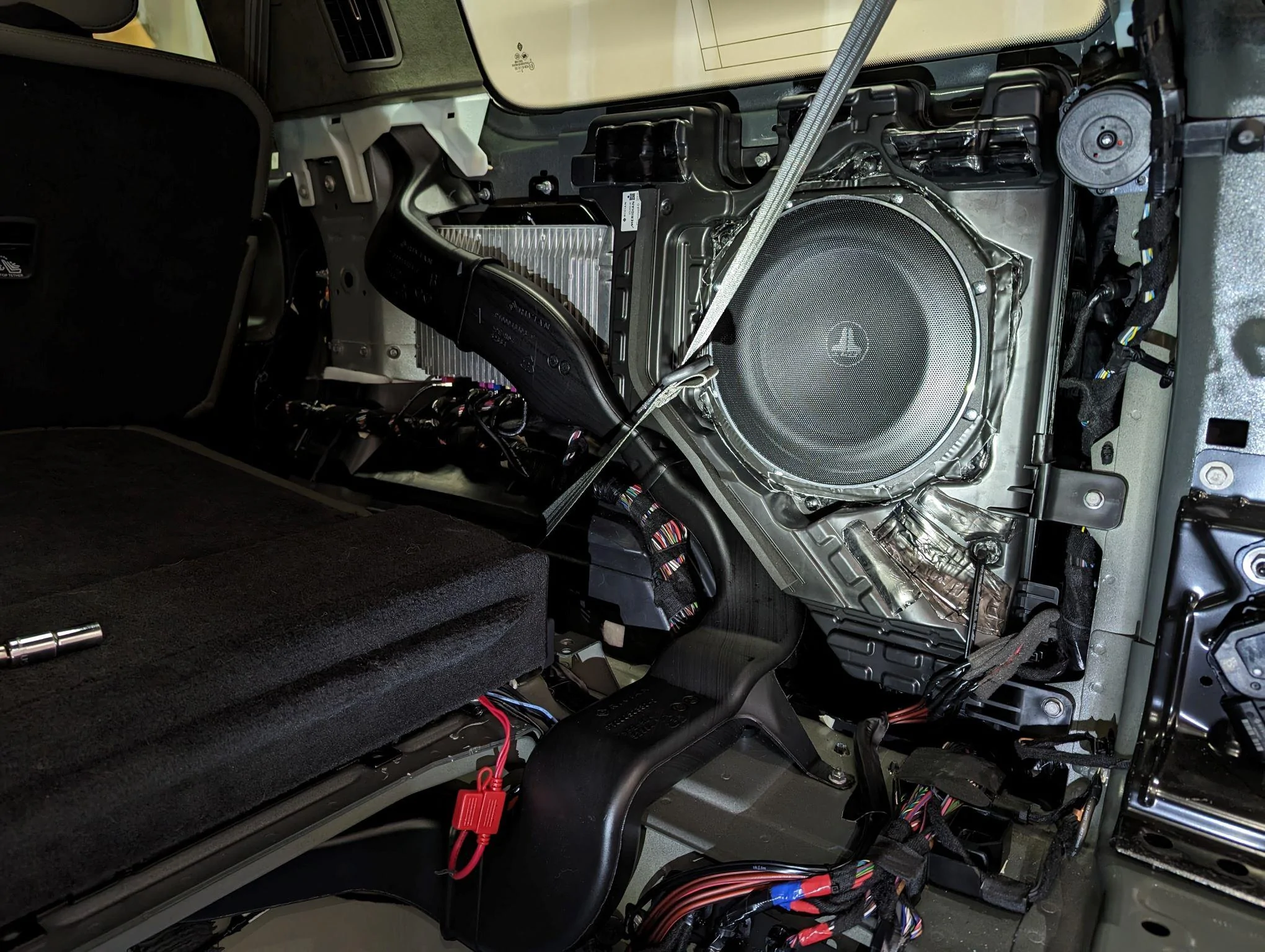

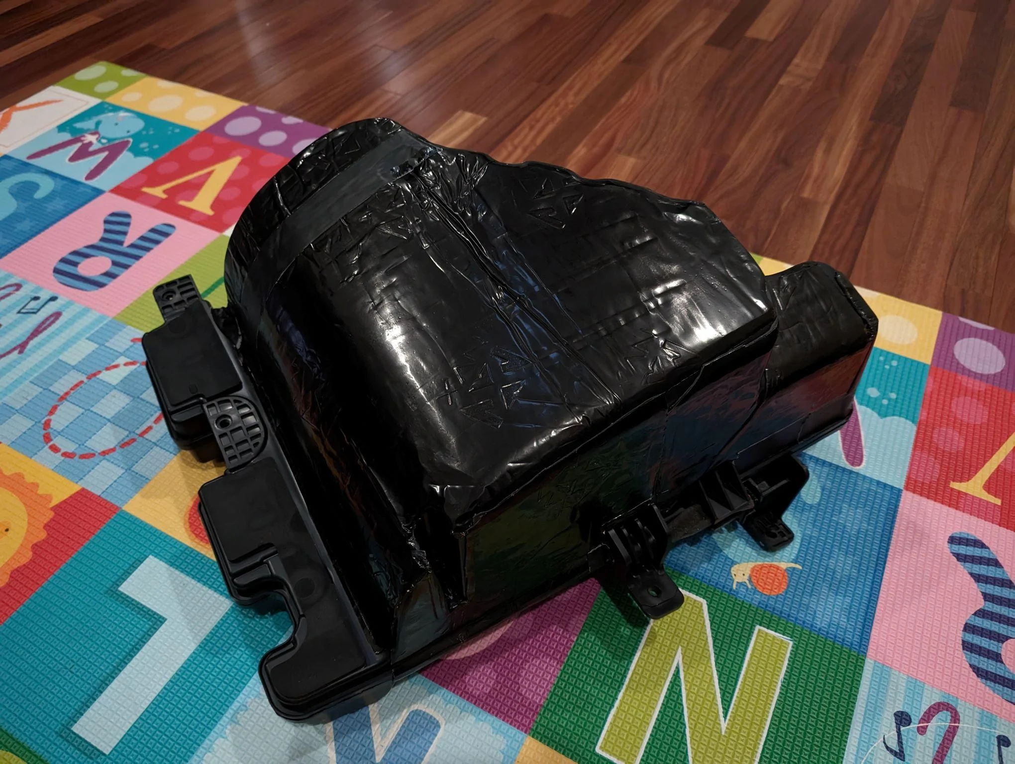

i replaced my stock sub this past weekend with a JL 10TW1-2 and a JL MX300/1 and NVX sound deadener mat. was pretty straight forward to be honest. the JL sub fits perfectly inside the plastic enclosure which i nearly completely covered in sound deadener.
tested without covering the enclosure and it didn't sound optimal. i also rolled on sound deadener onto the area directly behind it, as well as the interior of the wheel well. there's some resonance in there somewhere still, but pretty much unnoticeable unless you're parked with the music blaring.
thanks to everyone else for posting where the 12V wire is! i used simply posi-taps to tap into the 12V for power and remote. used an existing grounding bolt near the sub for the ground and used wirefly heat shrink solder butt connectors for everything else. i soldered simple 16 gauge speaker wire > RCA connectors to input into the amp and 10 gauge copper stranded wire for the 12V power.
I haven't done a sub/amp install in over 10 years, so this was a fun little project. ended up hiding the amp in the 3rd row flip up/down area which is accessible via like 6 bolts. when putting it all back together i only used 2 bolts to make maintenance or replacement easier. also got a 50 pack of plastic "tree" retainer clips since i busted most of them removing the spare tire liners.
results are impressive, but sitting in the 3rd row is a bit annoying with so much bass. the R1S could do better with a small 6" sub somewhere in the front as well to improve the sound image, but that's a project for another day perhaps
