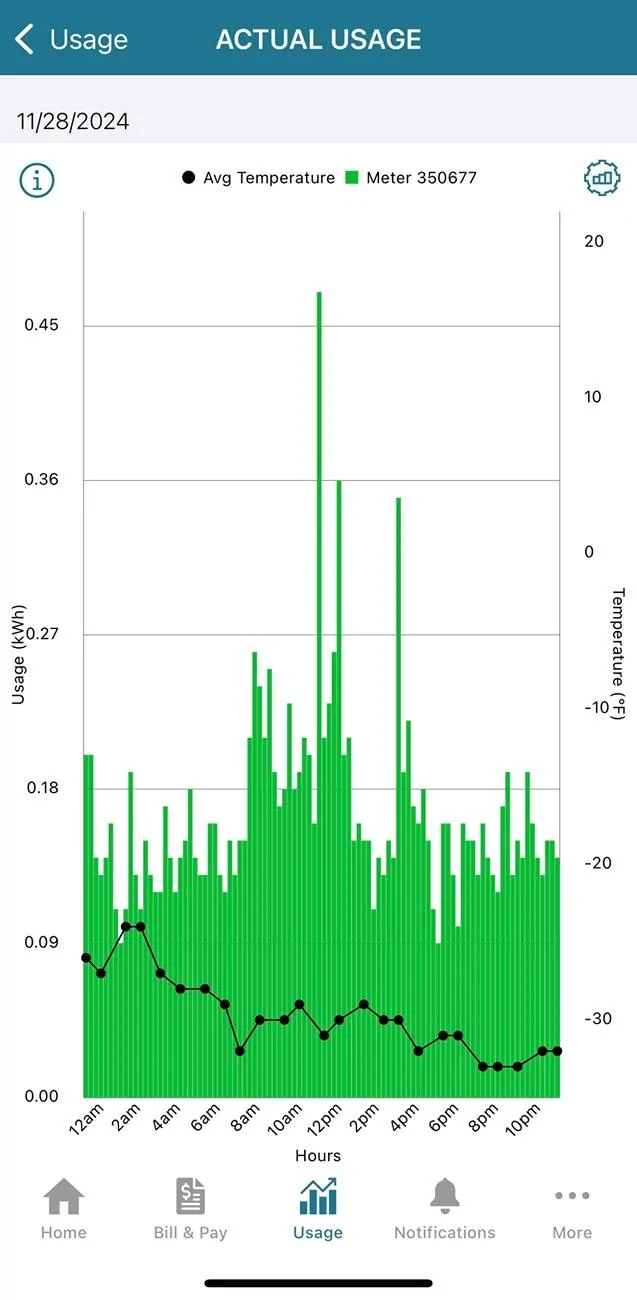

Even with electric appliances, tripping a 22kw generator seems extreme. My radiant floor heating boiler/water heater is diesel and uses little power but my pellet stove uses electricity and runs whenever I’m home and awake. The stove is electric as well and I typically only use 15-20kwh per day in a full size home.
You need to recognize that there are a wide range of heating and other utility loads in the millions of homes out there. 22kw peak demand is not extreme. And just because it trips at 22kw does not mean that’s the continuous load. I have a well pump and geothermal heat pump heating with electric backup along with regular appliances. In this 22kw generator scenario discussed above, if the heat pump started while the well pump was running, it would trip. Or if my heat pump was running and the electric backup kicked in, it would trip. On a per btu basis, my geothermal heat pump costs less to operate than your pellet stove. Higher electric load, but overall lower cost.
Can I ask how you measure usage? I don't have a way, the generac I use doesn't appear to have a way to monitor it. I have the app, basically it says is it sitting there or not.
I've only tripped mine once, and I kind of did it on purpose. I knew with the (inefficient old thermistor (is that the word)) heater running and the electric stove plus my car at 48 amps it would be a kind of max load. I wanted to see if it would die and then I could recover it.
I read about this kind of thing but I don't really know anything. The stove is on a 50 amp circuit, so the 80% continuous would be 40 amps. Then 240 * (40 + 48) is close to 22kw = 240 * 90 amps.

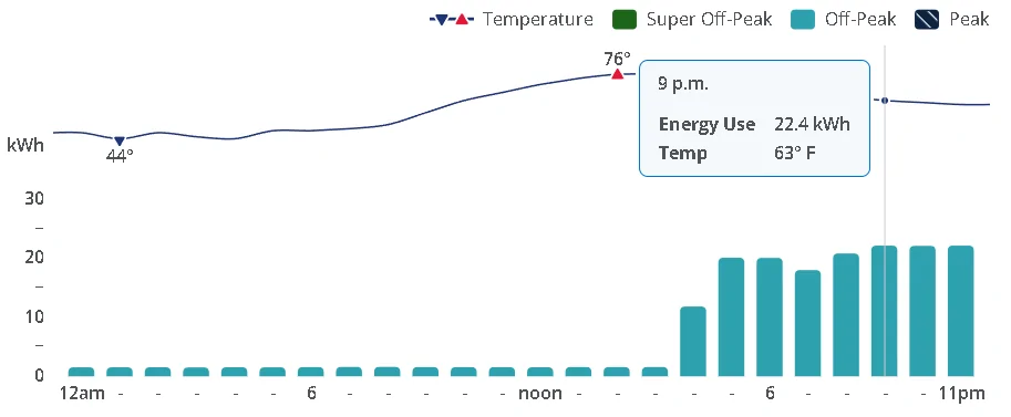

y'all got any of them EVs?
