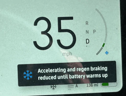

Glad you're okay Rob! To add to the excitement on the drive back from Mt. Bachelor to Bend it's difficult to know if you're going to have regen or not. A message pops up and disappears every once in a while "Acceleration and regen braking reduced until battery warms up" leaving a tiny little indicator on the dash but without looking it's a surprise, am I going to have regen or not when I let off the accelerator? I really wish there was an option to turn regen completely off.
Yes, I see this a couple of times on every return trip.

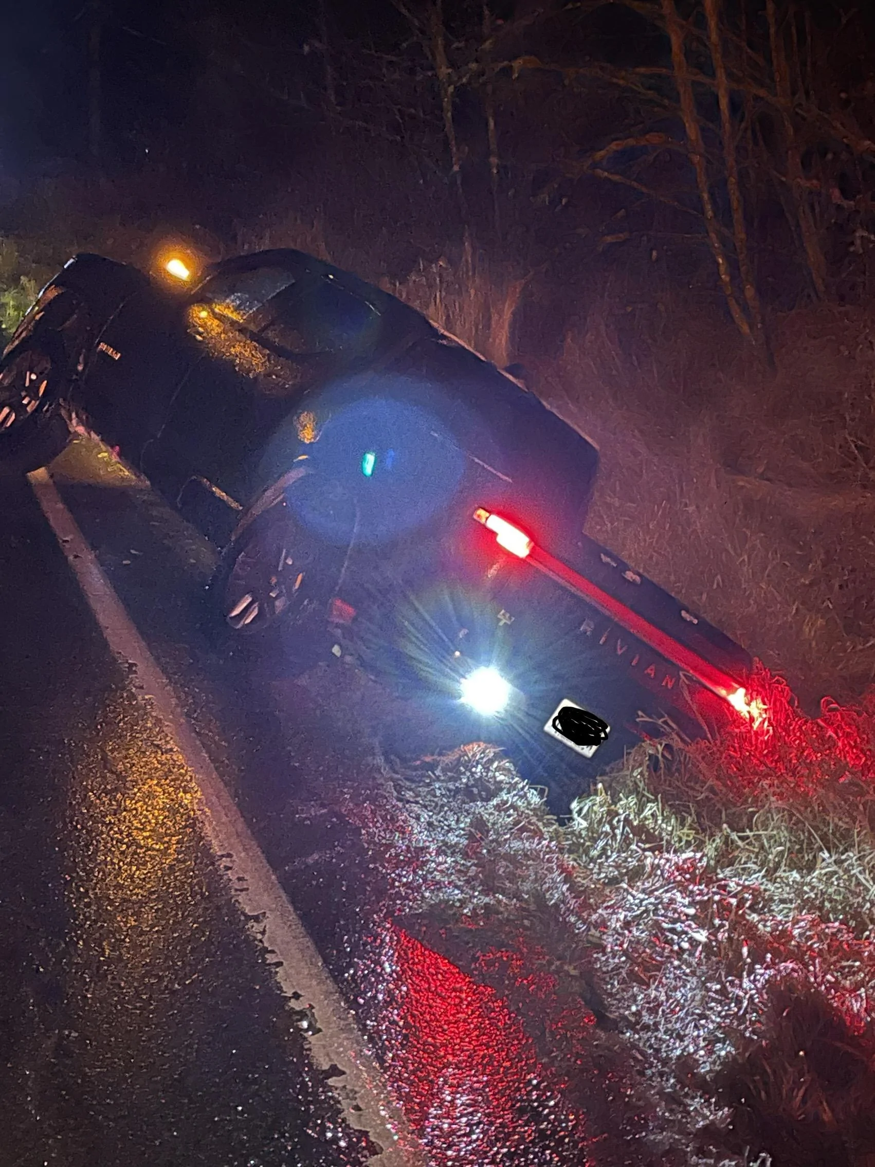

I think that Snow tires (studs) are a must have. My wife and I got caught in an ice storm and the rivian went off road twice. The second time was on a flat section of road. I have the all terrain tires and was in snow mode going about 15mph. I let off the accelerator lightly and the truck slide sideways into a ditch. I think that if there were better tires this might not have happened, but I agree that the programming on the 4 motor was the main cause- regen tried to kick in and that was the end.
Shitty, any damage to the passenger side?
This happens to me, as well. It pops up just as I start heading downhill after Meissner Nordic. I'm pretty sure that I hear a chime when the notification appears. I'll try to remember to listen for it when I'm on my way back from skiing tomorrow.
Yes, I think there is a chime. But it doesn't let you know when regen returns other than maybe that tiny little snowflake above the range disappears. For me it happens several times on the drive back to Bend.
Mine chimes
